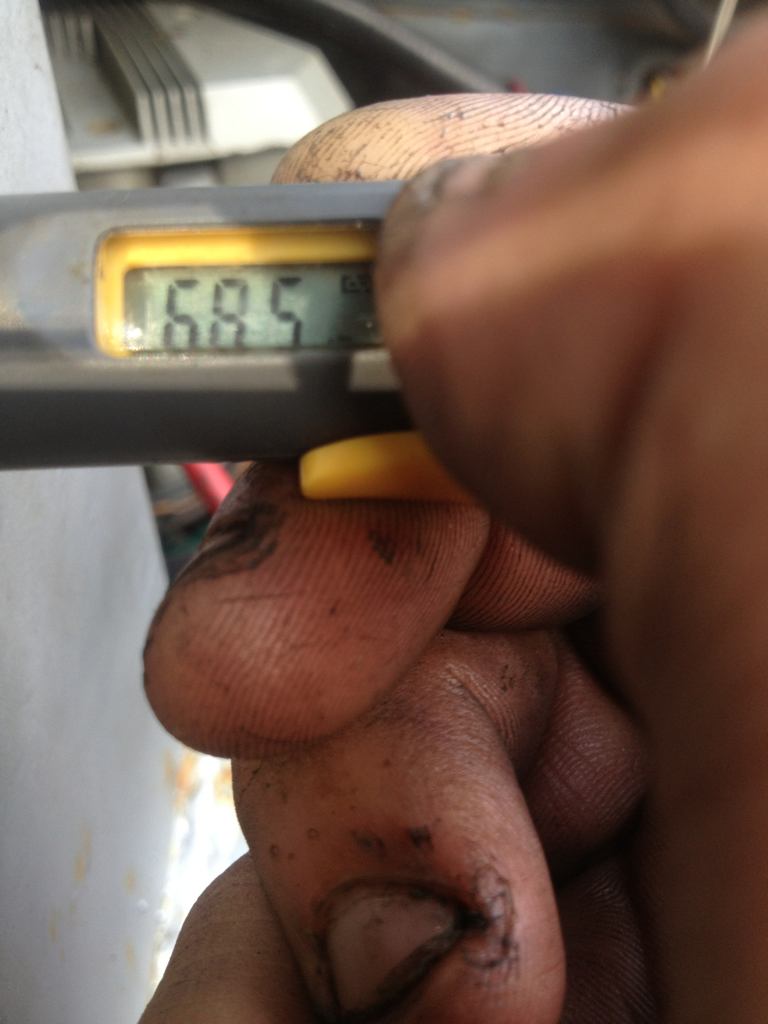

After a run to the parts store, the outside tunnel ram temperature (engine is at 190 degrees)
Note: RPM range before this reading was not above 3,500.
So what's your theory for what's happening? Is it beneficial to engine operation/power?

I'm talking about the heat loss on the spacer, where is the heat going? To my mind it's going directly into the engine. Which usually, from a power standpoint, isn't a good idea. Edit; tho it can be good for efficiency. It's been a long time since I've looked into carbed systems so don't remember what happens with such a large plenum, how it affects distribution, power, idle, etc. I'm just wondering if you could explain it. If you can explain it, then you have researched it. If it did what you thought it would, kudos. I think it looks alright, but if it does nothing for power or efficiency, in my books it's usefulness is over.

@Richard: basically the more air/fuel mix you can cram into the engine, the better. (Keep in mind I'm still tuning). As for the heat loss, it's basically like an air conditioner works.
Taken from PerformanceBoats.com:
"This is normal for a tunnel ram and good carb working together. When air expands it cools. You have a lot of velocity through the venturis, and it expands into the tunnel ram making the air cool very rapidly.The cooling of the tunnel ram is from the evaopization effect of the fuel removing heat from the air in the low pressure of the intake. The cooling effect means your carb and tunnel ram are atomizing the fuel very well, giving you a denser charge, which is definitely a good thing."
