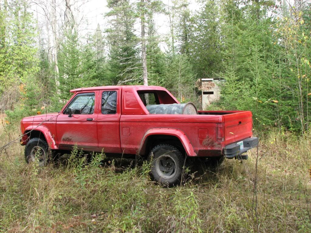

Well, here we are with the truck finally in its native element. Namely, dirt and mud!
My daughter and I arrived at deer camp for the annual "Camp Fix Up" weekend. This is the time when we all get together to get our blinds all set up for deer season and to work on projects for the camp owner. The road out to camp is a two-track, but it isn't bad at all. Just a bit muddy.

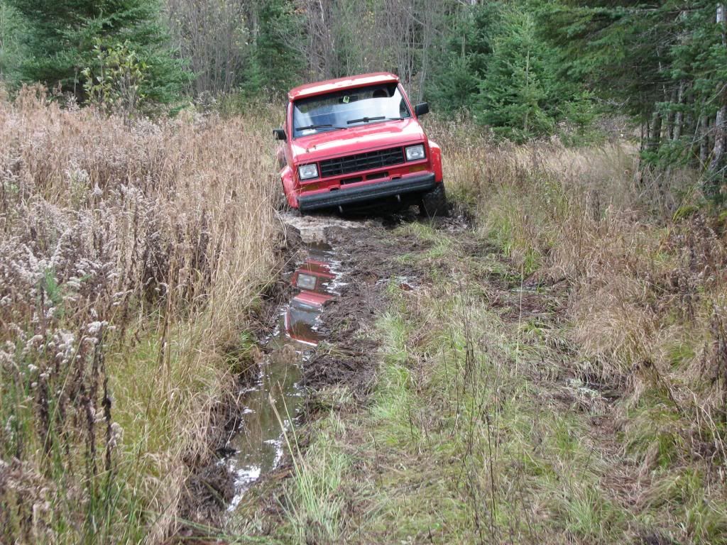

After setting up the feeder and corn barrel at the first blind, we went back to camp and loaded up everything we would need for our blind and headed back out. The trail to our blind was definitely a lot sloppier. Two wheel drive four-wheelers routinely get stuck in the larger mud holes so I was curious to see how our truck would handle it. I told Kate to put it in low range and crawl through.
My, scratch that...  Now my DAUGHTER'S 1987 Supercab 4x4
We cleared the first mud hole easily and got to the longer second hole. Both of these were actually in better shape than I'd expected. Usually they're much worse than this, but we hadn't gotten a lot of rain so they had dried up a bit. Still plenty of water and mud, though.
