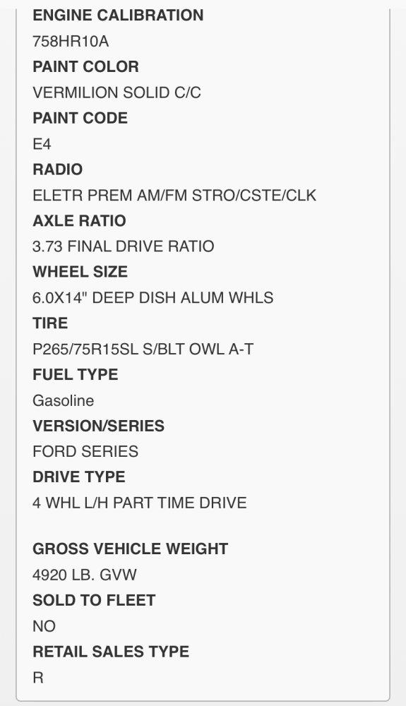

My rim size?
Some factory wheels will have a JJ15x7 on the rim in one of the unfinished areas you can see from the front.
How can that work?
Well, on the assembly line they have a guy on either side of the truck and they install the rims that have. No one checks if they're the same. This is where the gangster lean came from.
That rim size has to be wrong. I don't think those deep dish option cast aluminum wheels came in 14" they were an option only on the XLT and 14" tires never came on an XLT 4x4. According to the brochure.
You could have got the deep dish wheels with either 235/75R15 or optional 265/75R15.
