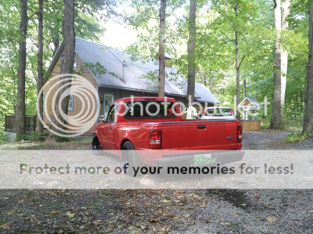

My ride. 97 ranger 2.3t
Went for the Emergency Ride this weekend, 1000+ cars showed up for the ride. Got a few pictures and a 3-4th pull at 15 psi... I still have issues after a shift so I have to get back on gas slowly after a shift otherwise it goes lean.

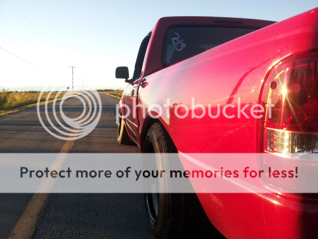

And random guys taking a look at my truck.. The sickest picture I have of my truck yet.
On this one you can see my ''stock exhaust''

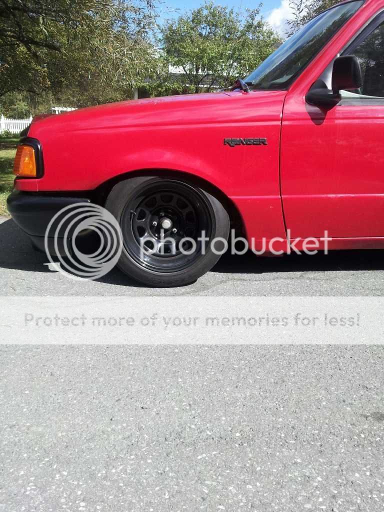

More camber than my friend's honda:moon:
Just admiring your truck!! Say, who makes those rims?? And where did you come by the 2.3 engine? I would love one for my truck!
Thanks, Cragar and few other companies make those rims. They are called D-Windows..
Engine is a built 97 ranger one. You could also build your 2.5 for yours.

If you get a chance, wondering if you could tell me if you have had any issues yet with wheel bearings due to the tremendous offset/spacer combo you're running?
I like the rims and am happy to admit that I am considering a similar set for my truck, however 15x8" wide with +6 mm offset. (I do believe the rangers came with rims from the factory utilizing a +12mm offset) I want a LITTLE wheel exposure outside my fender to give it a more agressive stance without compromising bearing life etc. Not looking to go to the extreme of pulling/rolling the fenders as much as I'd like to...
Also with that, maybe you could shed some light as to how close those 16"s (rim I.D. inside bead seat) come to the caliper without the spacers, and if there is any possibility of interference issues at all? (my memory escapes me as to whether or not you covered this already, but it's finals week at school and my motivation is gone!!) With that info I can get an idea as to whether or not 15"s with a +6mm offset (4.5" back spacing) will work for my truck as far as clearance goes.
I didn't have any bearings issue yet.. But drove maybe 3500 km since I did the whole swap with new bearings.. Not using spacers anymore with the -38mm offset lol.
I'm not sure of understanding exactly the question maybe cause it's 1 AM on christmas eves lol but I will try to answer .
The inner rim will clear the caliper for sure, rangers came with 15'' and 14 stock and with the stock front brake setup they all clear.. Unless you have the sport track 12'' rotors then you need 16'' wheels at least, some found 15'' wheels that cleared I think..
As for total clearance with +6mm offset I don't think you will have any problem unless you are dropped to floor.. Mine have around 3.5 backspacing and there is more than enought place for wheel movement.(plastic inner fender removed)
It only rubs on the inside fender because I am too low when steering to max. I will be modifiyng my fenders to stop that this winter.
I bet you could go with way even less offset than +6..
Hope this aswered the question.:icon_thumby:
