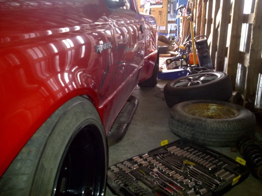

Little update here. Tested the fitment of the new wheels on the truck... And I'm running into a little problem, nothing too bad, wheel is only sticking ou by like 1.5 inch of the front fenders... Didnt try the rear yet but will be around 2.5 inch out I think... Seems like I will be widening the front fenders and pulling bedsides on rear by 2.5-3 inch out.
Heres what I'm talking about, wheel is jacked on this one but when on the ground with camber its a little less but still...

What do your fenders measure from the ground? Doesn't really look like 6/9...
I don't know fender height, I will measure this weekend when I'm going to my garage. You can't really notice the drop in those 2 pictures, just a bad angle to see it.
Well what did you do to get the 9" drop in the rear?
I hope you have a step notch.
I do have a C-notch, I have a 8.8 diff which people claim to be 5 inch drop. Plus belltech 4'' drop hangers kit. Not exactly sure it's really 5 inch for the diff tho, seems more like 4 inch maybe. Up front I have DJM 3'' beams and 3'' drop coils...

24'' front fenders and 26 rear. Pulled bedsides today, looks sick
Doesn't anybody knows stock fender height on these trucks? wanna know if thats really 6/9.. For front i'm pretty sure but rear not at all.. Can't compare to my b2300 since it's sitting 27 1/2 with worn coils and 37 1/2 rear.
