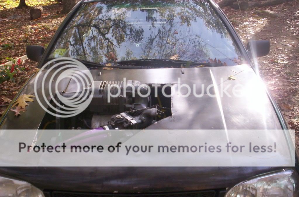

x2....u cant put a pic up like that and not tell us more about it, looks like almost with a 3" body lift it would fit under the hood, wait....i just noticed that was a car
looks like a mk3 golf 2.0 x-flow with a crazy custom eaton(?) sticking out the hood.. and a kamei grille. looks non-intercooled? crazy looking setup.
Thats my 1996 VW Golf 2.0 with a custom fabbed intake manifold with an Eaton M90 sticking out of the hood, I just recently retired the car, had close to 300 WHP. With the Eaton and high boost pressure came too many problems, I removed the built motor and dropped a stock 2.0 in it, its now my gas sipper, that Eaton might be going on the Mazda =) As far as the mismatched rim goes, the matching rim is in the bed with a flat tire =P
that estimate seems a little on the high side.. the xflows have what? 90-100whp stock, i know its 115bhp.. got a dyno sheet?
so you're claiming 200whp gain from that eaton? thats a high estimate even for a turbo'ed fmic'd 2.0.. and hey we're only talking 2 valves per cylinder here! built g60 motors running MUCH more efficient lysholm superchargers, a/w ic's and pushin 18+ psi barely hit 200whp, even with the aba blocks.
what did you have for injectors, engine internals, intercooler, running standalone? how much boost, what was your c/r?
i'd be interested to see your custom intake, as i see the stock intake manifold is still under there
not trying to start shit, just wanting some info

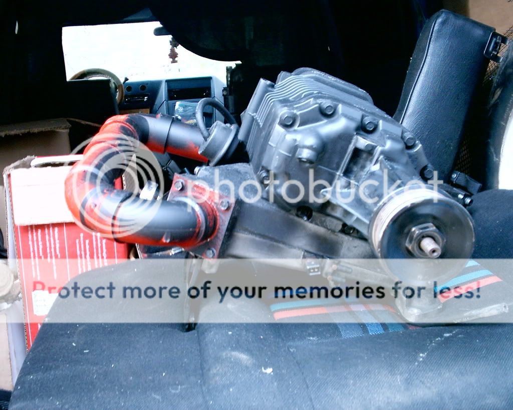

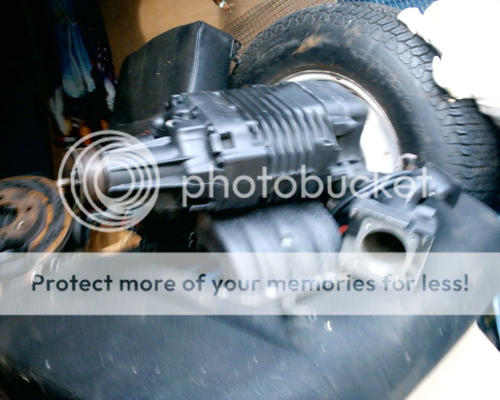

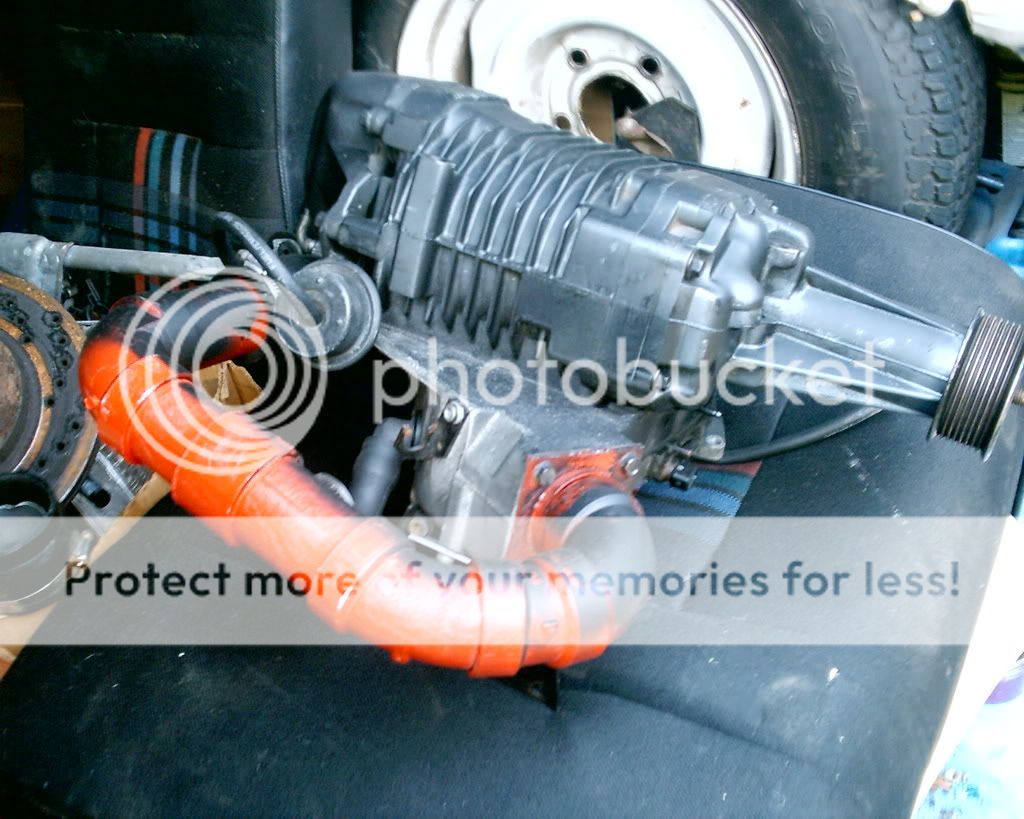

That was a typo BTW, was meant to read had almost 200WHP, that extra 100HP too much for you? LOL. That stats on it are, Techtonics Tuning 276 Duration cam, Injectors from a 92 Thunderbird Supercoupe, Flat top Pistons, MSD 6AL Ingition, MSD Blaster 2 Coil, Bosal Headers, TT Stainless 2 1/2 inch exhaust, No Cat, Brass alloy valve guides, Some kind of dual Valve springs, and that supercharger, I have a dyno slip somewhere, just dont know where it went. it was running 14 Psi Boost. So sorry about the typo on the WHP, it takes a lot of work to get HP from a 2.0 ABA, but mainly I built it for the pimp factor of having a blower coming out of the hood =) And you are correct, that is the stock manifold under the blower, but I drew up some plans and took it to the Machine shop thus it is heavily modified, especially because it has a blower pushing air through the top, not the back LOL. That intake is still intact, I'll take some pics of it for you guys, just give me a bit.
