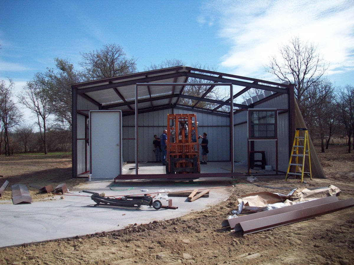

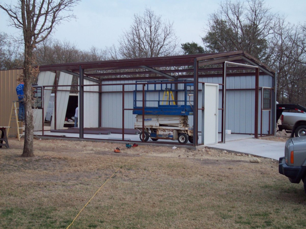

Here's photos of a building going up by the guy that quoted me $23k yesterday:

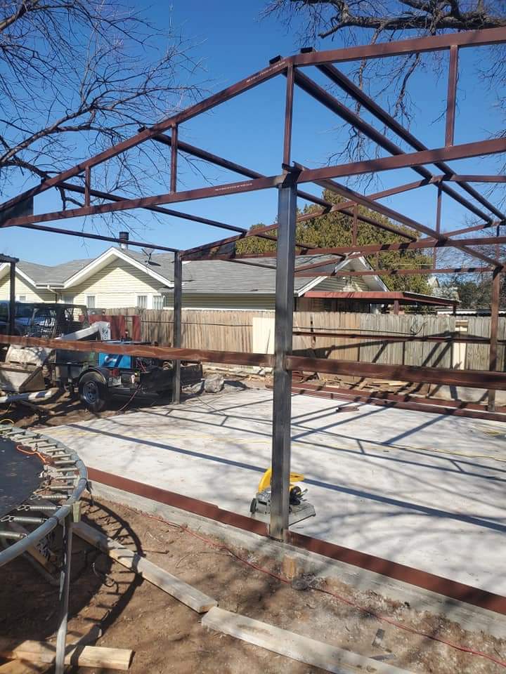

Here's 2 pics from the company that quoted me $21k on facebook messenger:
58858
58859
That second one says "We construct all of our buildings out of structural Wide-flange beam not an inferior square tubing structure like the competition. "

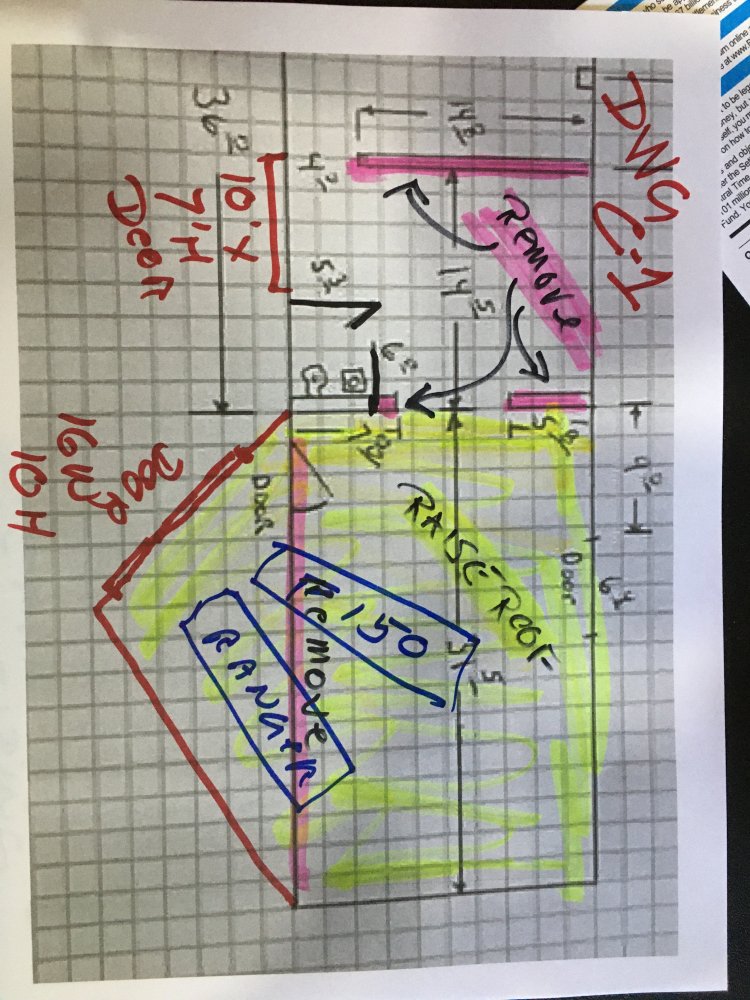

Top Picture, the top piece across the front looks like a truss, and probably should be, but it is not laid out right. In any truss the open sections should all be triangles. In the picture, if something hits the roof, instead of distributing the load down the angles and spreading it out, it’s going to bend the top tube, shoot the load straight down the vertical piece, and bend the bottom tube. Having said that, it’s easy to modify it into a true truss, but another problem is that trusses have to be supported at the connection points, either the ends, or at the bottom of the W points.
Another thought on the tube frame structures is corrosion. The I-members are usually coded pretty good in the factory so there’s minimal rust overtime. You would have to wire brush, prime and then coat the tubing to get longevity. Doesn’t have to be wet, it will definitely corrode with simple condensation.

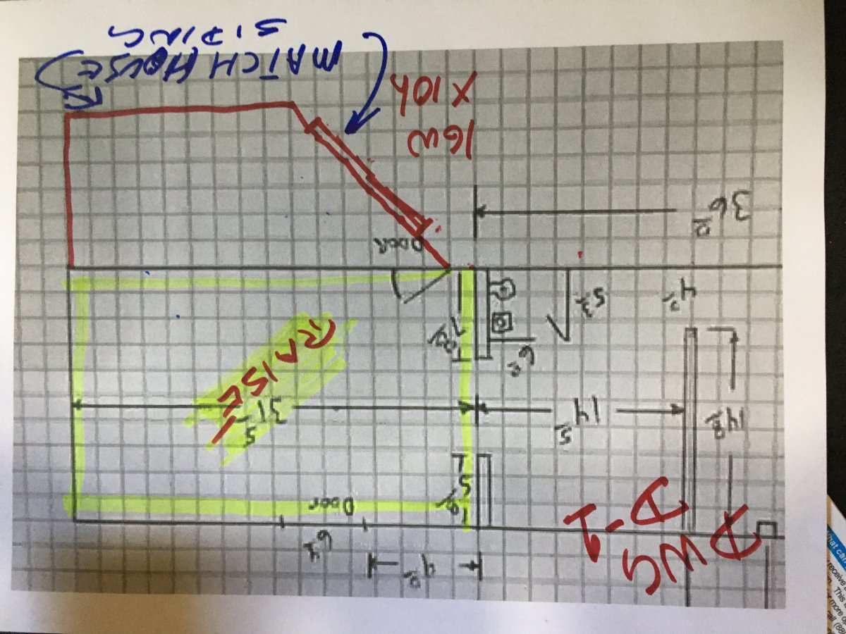

Insomnia and I got together and came up with a couple other ideas
If you like either one of these, or if you want to sketch something different, I can figure out the trusses and roof line etc. pretty quickly.
Edit: The wall is angled to minimize the impact on the curb appeal and the yard between the house in the garage. The angle can be played with.
@Jim Oaks
I just resent the original pack of drawings and then I sent these two as a separate email.

Those are more like it.
