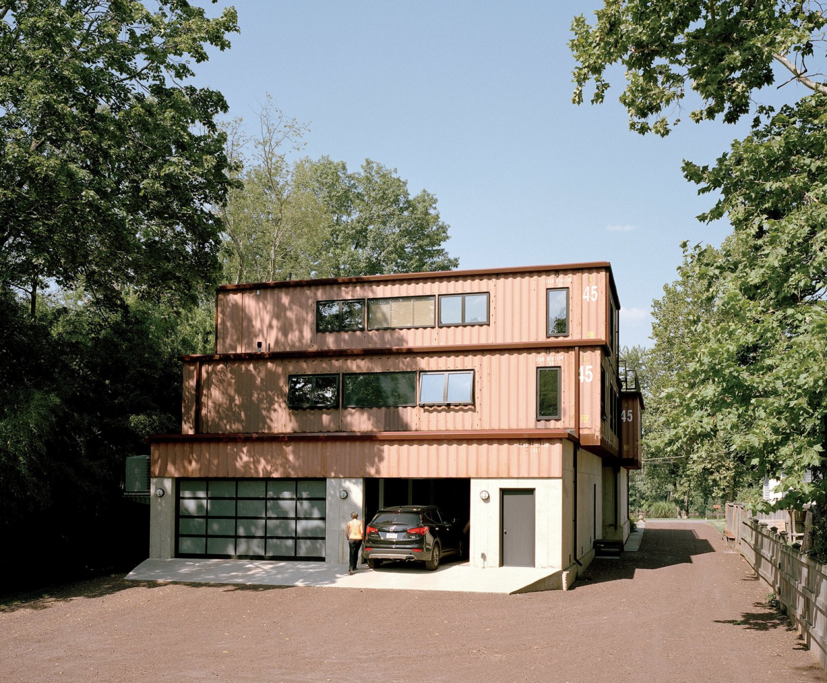

@Jim Oaks I saw on your Instagram, those buildings made out of old storage containers. I have always wanted to do that, but into a house. Container homes can be configured in so many ways and will last basically forever.

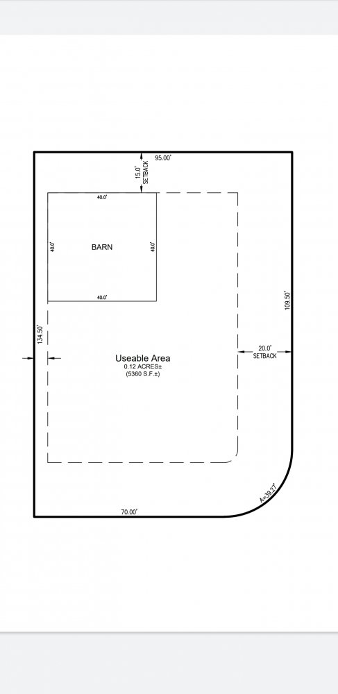

Jim, as a Licensed Surveyor, I strongly recommend making a current survey part of your due diligence in any property you buy, There can always be hidden easements and other things that can affect your usage of the property. Also make sure you have full knowledge of any restrictive covenants and other documents that affect and control usage. Rural properties are generally only bound by restrictions from the county level, but suburban and urban properties may be bound at the County, City and even local neighborhood levels.
I've attached a drawing of a "typical" corner lot in my area, complete with building setbacks. Obviously, the lot you're looking at may be configured completely different and subject to different setbacks or easements, but this should give you an idea.

If I build, it has to be at least 1,000 sq-ft, not 1,400 sq-ft. The building sits to close to the corner of the property (not on a street side), and is over the build line. It's grandfathered in, but sounds like if I do 50% improvements to the building, then everything has to be brought up to current requirements, and I can't just move a 40x40 building. This means I can't convert it to a barndominium.

I need to find out how far over the build line it is. I'd love to convert part of this in to living space.

Here's a screenshot of your .pdf.
Apparently the building is over the build line, but I don't know if it's on the right side, or back. It looks like there's a small alley between this lot and the neighbor to the right. It's overgrown and doesn't go anywhere. Doesn't go through to the next street. The building is definitely less than 10-feet from the property lines.
