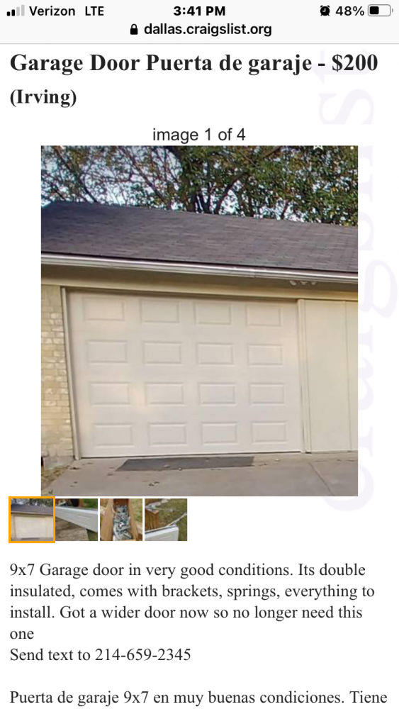

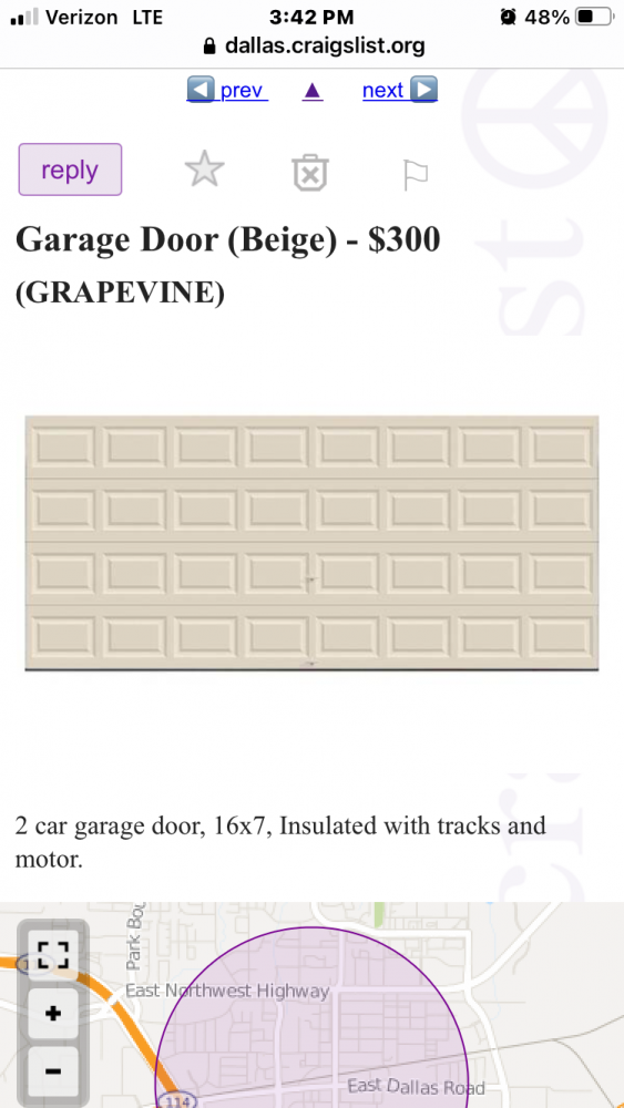

I did a quick Craigslist search here and in Dallas, TX. Very similar markets. I found brand new 8x7 doors, installed, under $500 in Atlanta.
this is what I found in Dallas. Take it down and pick it up yourself, professional installation all day long for $150 per.
Also, call Overhead door and the other “real” shops and ask if they have a good used door or a scratch and dent. When I built my shop, they had an 8x18 insulated steel door that cost $2,100, that a customer didn’t like when he saw it, and I got it for $800 installed (20 yrs ago)
