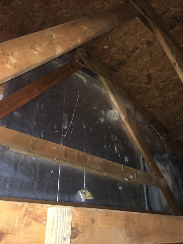

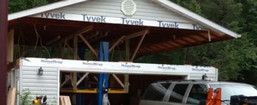

@franklin2 video: it works, I’ve done it, I wouldn’t do it here, IT WILL NOT WORK HERE! Why? I zoomed in on the picture, see below. They’re lifting points are on the bottom of “W” trusses. It is not a rafter roof. A rafter roof is framed to the top of and secured by the wall, it does not just sit on top of it, so you would have to box in the ends of the rafters, and then lift it from just inside the walls. By the time you did all of that, you can tear the roof off and put the trusses up easier. The hydraulic equipment in the video is expensive even to rent, and the tall jeep jacks could work, far less stable than the hydraulic system with a steel frame.

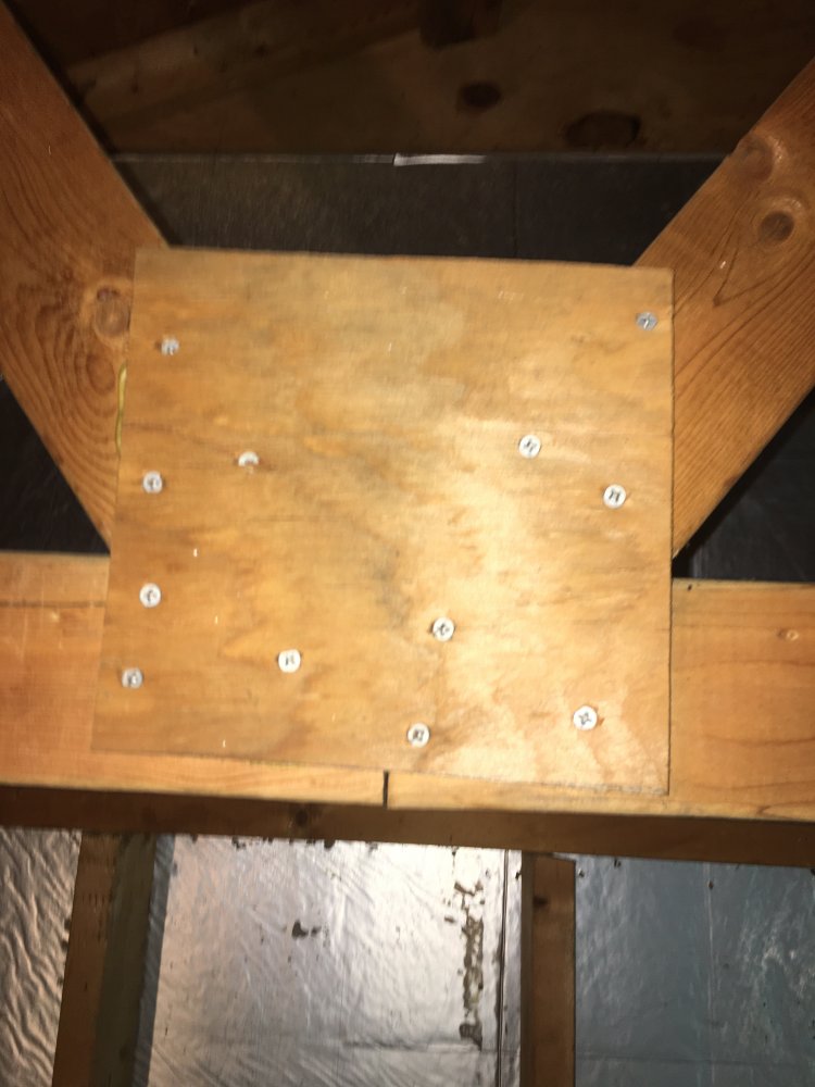

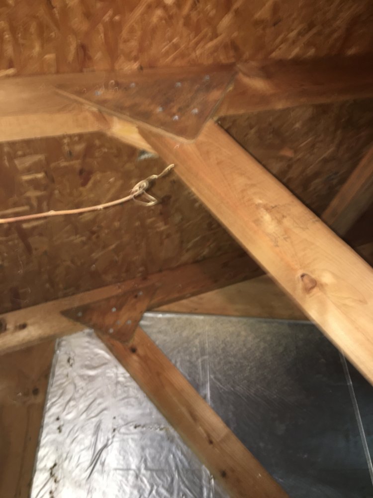

Here are pictures of my plywood plates, you can see that they’re not straight and square and they don’t line up with the edges of the 2x4s. I intentionally put the plywood plates inside the outside edges of the truss so they wouldn’t get in the way of anything when we were assembling it. The screws are wallboard screws. They only have to hold the plywood down long enough for the glue to set.
Afterthought, the roof can be waferboard, but the plywood plates have to be real plywood. I used half inch CD X plywood. And mine was inspected and done under permits in DeKalb county Georgia, the tightest building code in the state.
I found this picture of jacking up a rafter roof online, maybe it’ll help
I agree with Rick. A stick-built roof like that is not a great candidate for lifting. Trusses would be more stable when moving. He's coming up with some cool ideas for additions/remodeling.

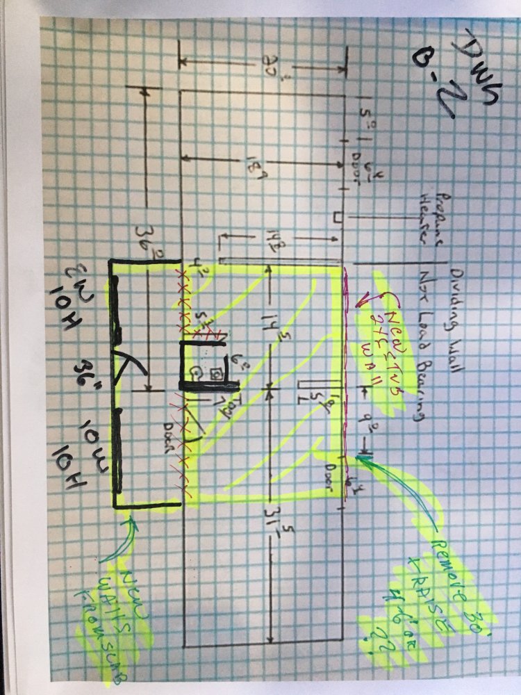

So you're suggesting that I build new trusses and just cut out 30 feet of roof in the middle of the building and raise the wall height there. Extend the concrete out 8-feet x 30-feet, and then build 8-foot walls to close all of that back in. Right?
I would prefer a single 16 or 17 foot wide 2-car garage door over a 8 or 9 foot wide door. I had those on my last garage and hated squeezing through them. Plus I didn't like that my car trailer wouldn't fit through.
Is there a reason you chose to build out from the middle versus just increasing the wall height, building a new roof, and just having the garage door on the end? Is your plan more expensive or cheaper?
Also the wall behind the toilet was the original back wall of the building. Wouldn't that be structural?

On a rafter roof, you are relying on the bending strength of the 2x6s or 2x8s so there’s many and they have to be close. It’s brute force, but small spread out force, building blocks.
In a truss, all the loading is either pulling along the board or compressing on the length of the board. So they look flimsy, but they’re actually much much stronger. You could actually build this strong enough for your needs using 1x2s, but if a heavy branch cracked one spot, you could have dominos. 2x4 is code for this size, and it’s a fortress!
The danger with a truss is warping, twisting, or falling over like dominos. That’s secured by the plywood on top, and by running a double 1x3 “strap” by the bottoms of the “w” on both sides, and by the cap/drip board on the walls.

Wait, this plan doesn't work.
The front half of the building is 36 feet. The bathroom takes up 6 feet.
YES, but I would stud up the alleywall at least 4 feet, and build the new house-side walls 12’ high. That gives you 12’ free height inside for 30’
That was my original thought, but the bathroom is slap in the middle!!! I’d drew in two 10’ wide doors facing the house on each side of the bathroom. Closer to the street, 8’ high, closer to the back, 10’ high. If you need wider, easy modification.
Trust me I’m the cheapest SOB on earth. But building cheap that doesn’t do what you want gets you nowhere. And if you have just a couple of extra bucks, the layout I’m proposing lets you put three vehicles inside, maybe four, without having to move more than one to get one out. So you can have a torn apart project in the back, you can put your trailer in the middle, and you could put your daily driver in from the front. If the doors are too expensive for you right now, I would still build the structure like I’ve proposed in the middle, frame out both doors, but only install one and cover the other opening. Then do the front door facing the street when you’ve got the money, and then do the third door when you’ve got the money.

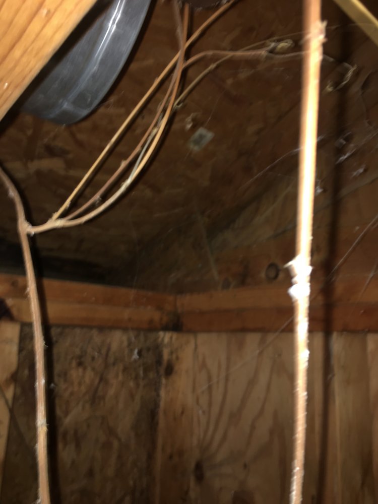

You need to open up the ceiling and take some pictures for me to be sure one way or the other. If the rafters run side to side in the existing building all the way to that bathroom wall, then the roof is supported on the long walls, and the back wall was simply for security. However, if the roof on the back end of the original building tapered down like the front does now, there may be support on that back wall. I kind of doubt it, because they cut out the middle of the wall to access the addition. But I’d really need to see some pictures before you start to tear stuff out.
I pulled my dimensions from your graph paper dimensions. It works. The bathroom is between the two side garage doors.
That leaves 9 feet between the wall and bathroom?
Keep up with me on the wine/beer and it will all make sense before morning....
which wall? New bumped out wall? That’s now the entrance foyer. Beer fridge, microwave, book shelves, portrait of Rick....
actually just maximizes the cross space between vehicles, no other option with bathroom unless you want to make it a sauna...
This shows bumped out wall and slightly narrower bathroom. Only way to keep bathroom as is.
Maybe build up one end of the building instead of the middle?
