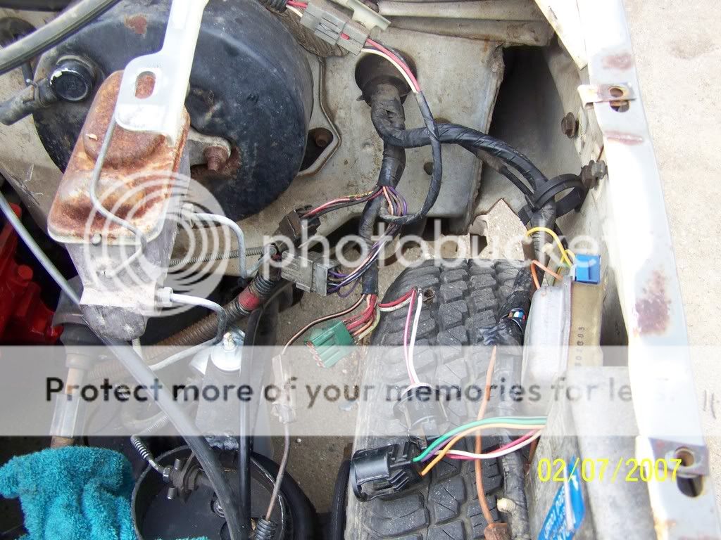

ok wires....
My motor swap
that voltage regulator will go away, i guess that i can just clip off the wires in the harness and be fine? the green plug that is unplugged is what im worrying about. the other two that come out of the firewall that are plugged up are to the neutral safety switch and the rear lights i believe. and the ignition box will be staying since i am running a duraspark dist. (i have a new ignition box, will upgrade later)

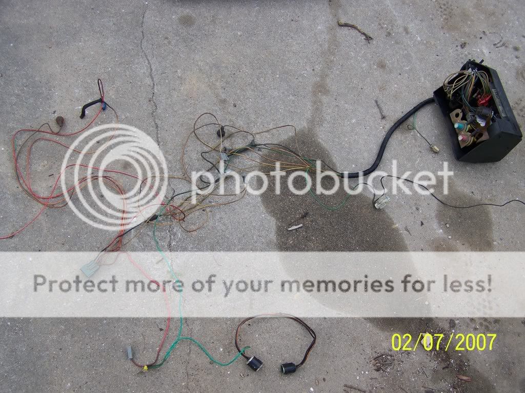

My motor swap

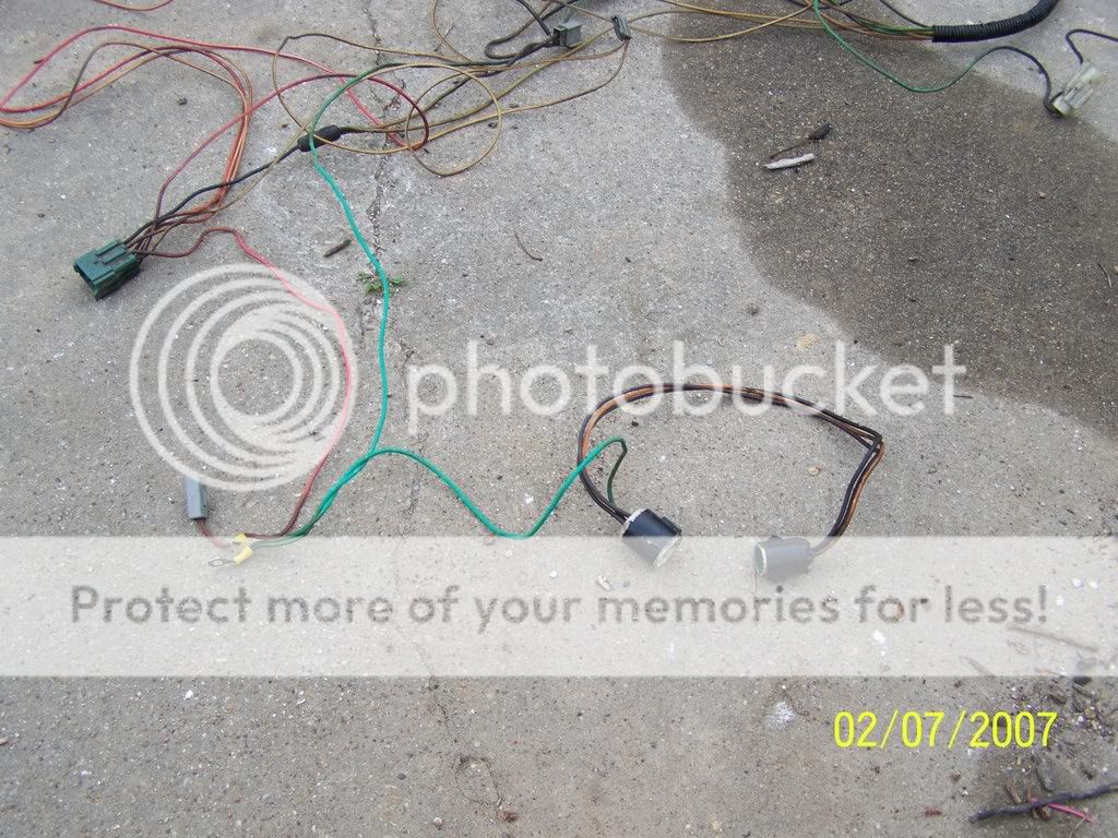

this green one.

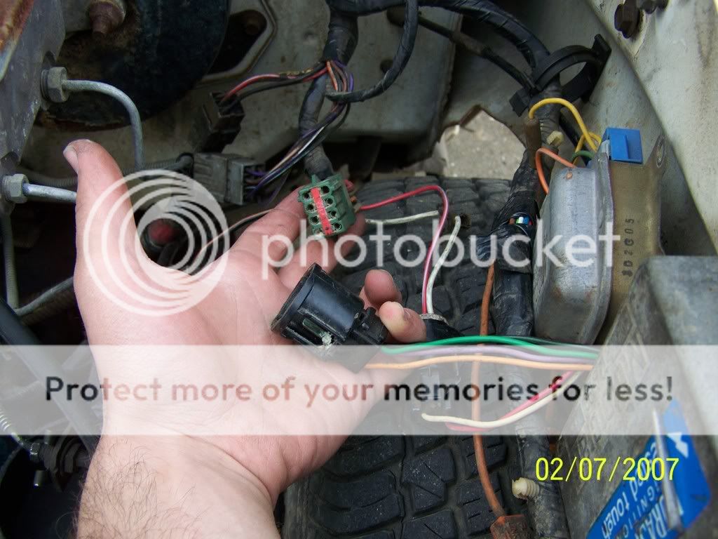

ok now this is where the ignition module box or whatever plugs up. and the two ring terminals went to the coil.
My motor swap
and then A CRAP LOAD of stupid sensors to the smog and vaccum crap.
now what all can i cut off and not worry about? i have a hayhnes manual but its hard for me to understand

i have the ignition box figured out, it just plugs right in... and theres one wire coming from that green plug that goes to the coil, i guess thats the only one i have to keep? i dont have any of those other sensors or crap

ok now what all plugs do i need to keep? i only see one that comes from that green plug to the coil, the rest go to random sensors and crap...
any ideas?
I tucked the wiring I didn't use up and out of the way on mine. Not knowing at that time if I'd ever need the stuff later on, I figured to let sleeping dogs lie. That was 8 years ago.
