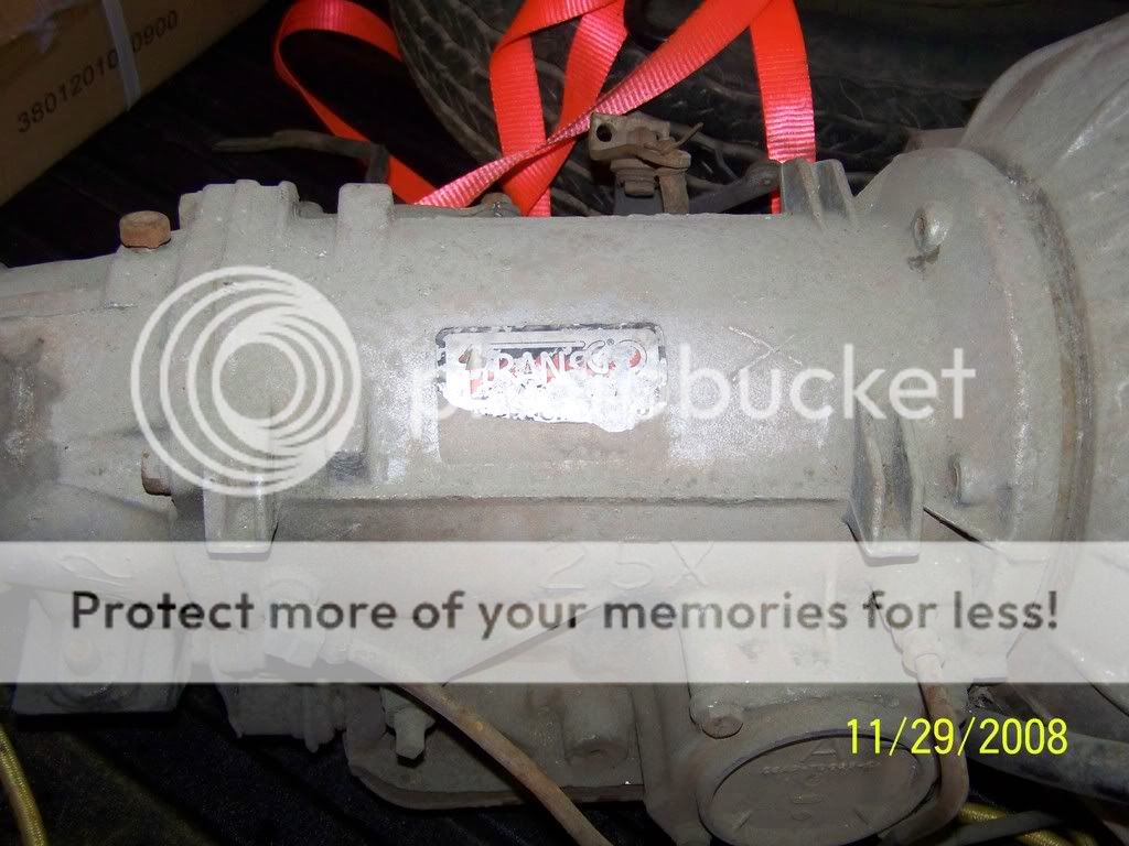

The C4 and C5 are very closely related. The C5 bellhousing is about an inch deeper than the c4. The real difference lies in the valvebodies. Alot of guys have used C5's with C4 valve bodies in their V8 swaps. I use a C5 with a C4 bell and valvebody in my setup and it works flawlessly. The output yokes are identical. I hope to see lots of pics soon. Make sure you check the fluids and bearing clearances closely before you spend a tonne of time and money on your project!

c4 tranny with a transgo shift kit (automatic)

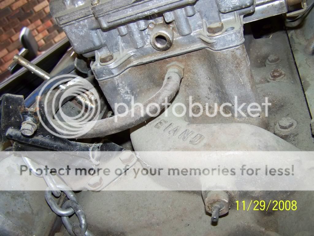

some kind of weiand intake (i need a short rise stealth so i can clear my stock hood with a 3" body drop)

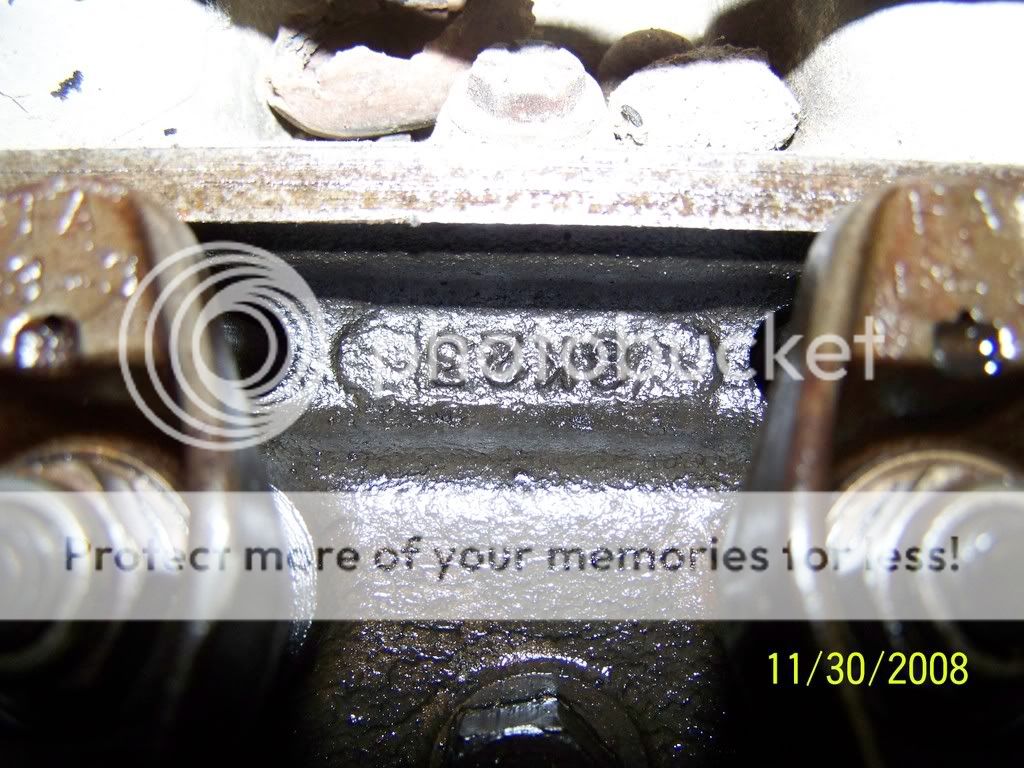

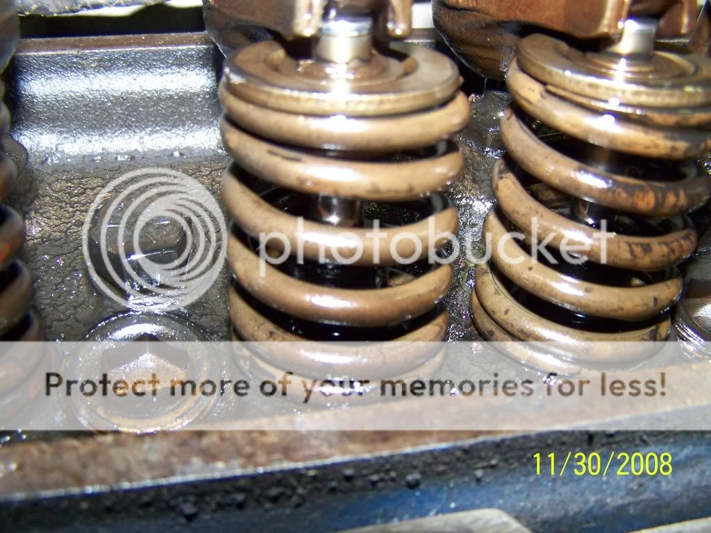

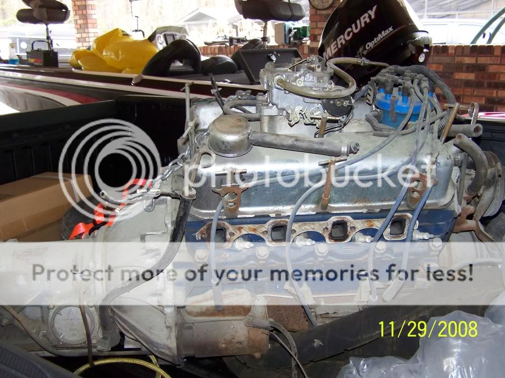

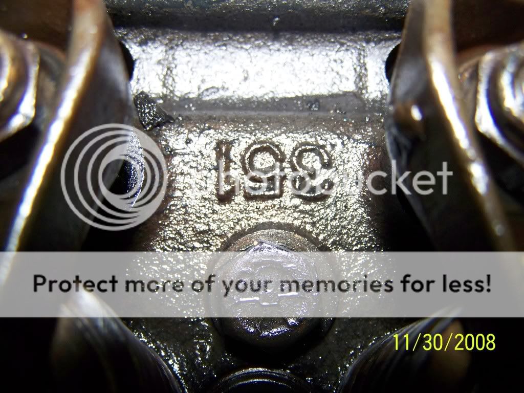

now he said that it was rebuilt and only has 10,000 miles on it. it sat up for 9 months in his shop. keith black pistons. dont know what size, oversize or forged? he said it has a cam also. no idea on the size, i think comp cam. has a weiand intake, 351 heads, and some kind of edelbrock carb. im going to use the 351 heads for now, i will upgrade later of course.

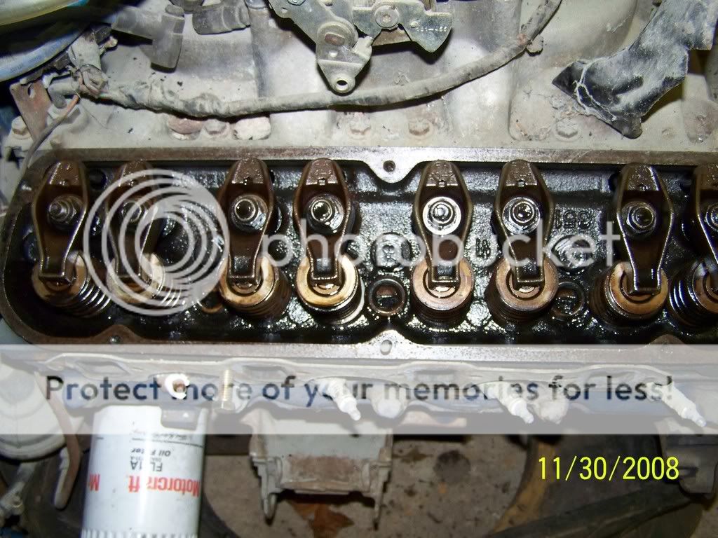

(inside of heads)
do these heads look ok?
and this isnt the same motor i talked about at the beggining of this thread. this one was 500 and closer. and seemed to be in better shape

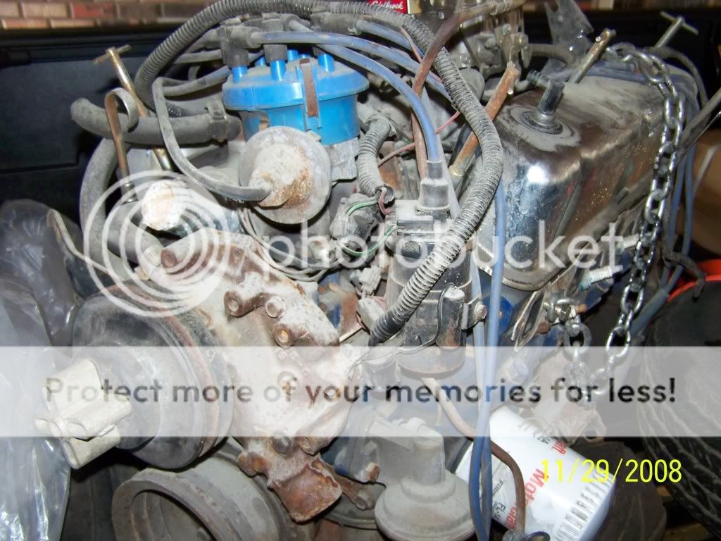

one question: what type of distributor are yall running? hei? idk what that is? but some say hei and others say no. they say duraspark or something?
The HEI looks retarded on a Ford. Damned thing's bigger than the carb and aircleaner.I'm running a points distributor (reman from Advance Auto $55) fitted with a Crane XR-1, fired with a Mallory Promaster EFI/points coil. It's fitted with the stock small to large cap adapter( Advance has these too) large EFI post type cap and Ford racing 9mm wires. This setup is reliable to 7500 rpms.

Yea, that's me too on RPS. The distributor on the motor you've got in the pics is a Duraspark. Good stuff. Little harder to wire in, but it's a keeper.
