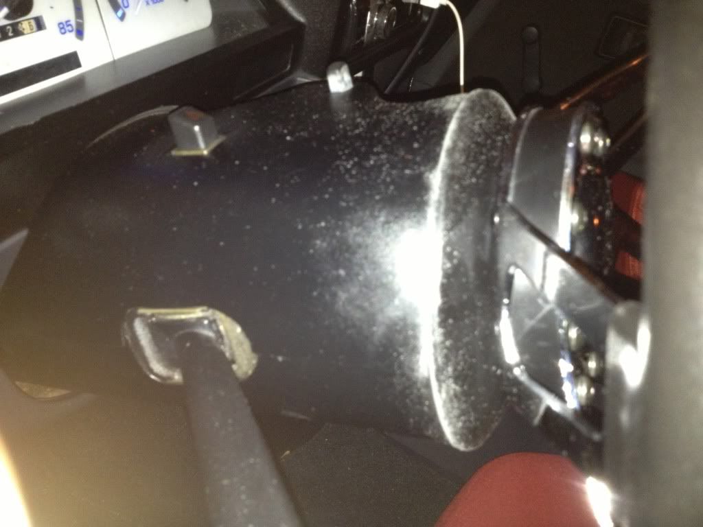

Did you have to modify anything? Mine is rubbing the hell out of the black cover around the colum... I got a new adapter and wheel.. The old one was the same on both my 89 and 90.. I had to add washers to get it off the cover.. I loosened the bolts on the linkage under the hood and had the girlfriend to pull back on the wheel.. It moved but didn't stay..
Mine rubs a little bit too, but it only really make a little squeak every once ad a while. It may have something to do with the cover being a little warped from year in the sun if I had to guess. I was thinking of grinding down the edge of the black disc to stop the rubbing. That's probably the easiest way to fix it. Are all the attachment points of you column cover still in good shape? Might be a place to start.
Everything is good as far as the colum goes.. The black disk is rubbing the plastic trim piece around the colum.. if I take the trim piece off it's fine.. The squeak may be from the horn ring in the wheel adapter where it makes contact. I used some silicone for plug boots to lube it up a little.. mine had a squeak till I did that.. But mine is cutting into the trim.. if I drive very far I get black dust on my leg from it.. Thanks for the help on this buddy!!
Mine was hitting the column cover too. I had to grind a little off the black disc and it was all good. :icon_thumby:
Want to toss up a pic multi? They speak a thousand words.
Might be able to think of something clever with a bit of visuals:icon_idea:
I'll lake a pic after work today and post it up.. Seems like since all three of our trucks are rubbing grinding the black disk is the answer though.. But before I do anything I am going to wait on your reply...

Your cover looks tight multi. It would appear as the obvious sign is that disk needs to a little bit smaller around. To the grinding wheel with you!
I figured as much.. I just dont get why Grant doesn't fix the issue with a design change...
