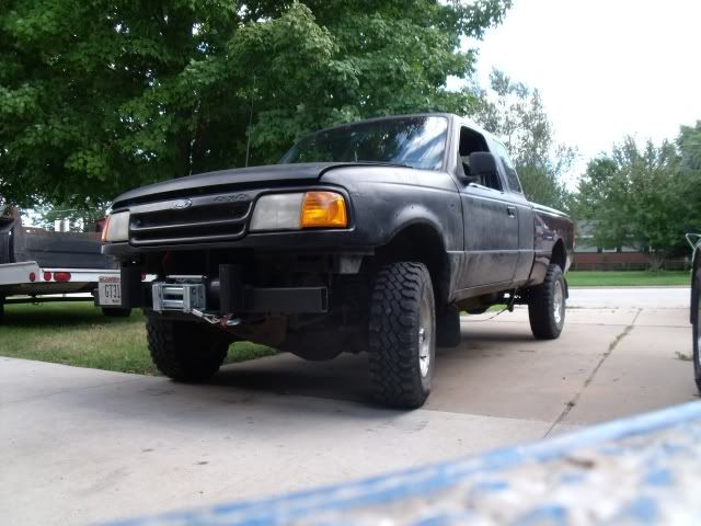

my first ranger
I'm assuming your tires are BFG re-caps? I've never seen a BFG a/t w/ that tread pattern!! For your bumper I would do the 45's around the corners for some protection . I like how your winch is mounted low and center. gives it a real custom look!!
yea theyre retreads from treadwright, ive got nothing but good things to say about them. i really wanted to keep the winch low and tucked in as close as i could to keep it protected.

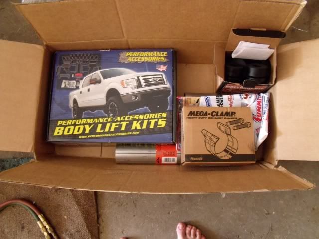

i love summit, found this on my door step this morning.
placed my order thursday. 3" bl, body bushings, a clamp and a 2.5" u-bend.
