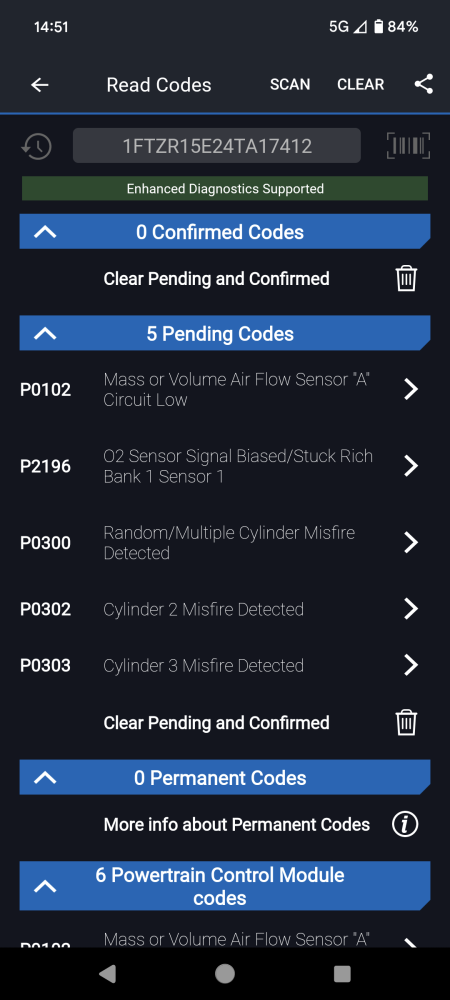

So I got a ranger on the cheap but the motor is 'funny' idles 'ok' runs ok some times, then some times it's rough as guts. Attached is the stored codes.
Changed the maf, plugs, wires, and coil.
Maf reads 0 signal on my blue drive scanner.
And some times randomly the CEL blinks slowly for a few min then goes back to solid on.

This is the lower half of the scan

Im not sure if a timing chain issue would cause that. With that many codes it seems maybe its a wiring or ecm issue. Someone who knows them more will be along to help more
Doesn't sound like a timing chain issue. It would be consistent and either run crappy or run decent. Seems like an A/F problem.

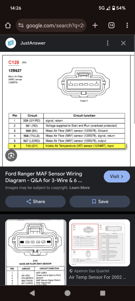

That's a picture of the wires im guessing red is normal battery / alternator voltage and the light blue opposite is the 5v. Then there are 3 others excluding ground that have no signal. My next guess is to unplug the ECU connection and tone out each line for continuity but that's a stab in the dark

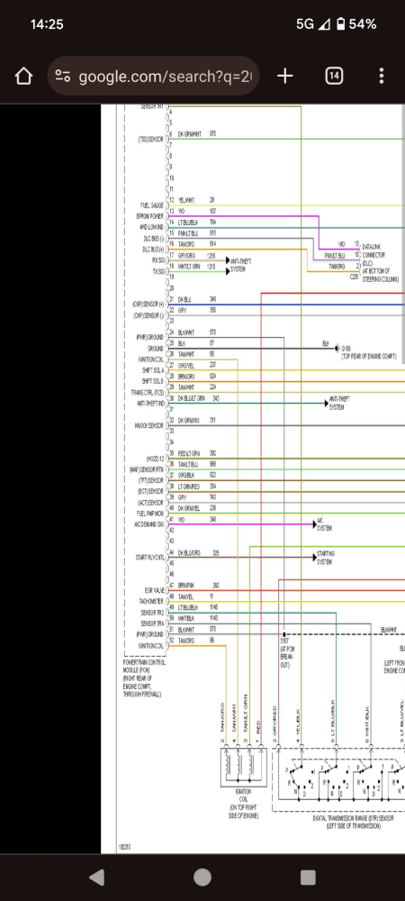

Ok so attached is the diagrams I believe are for this truck.
I have continuity for the maf return signal to the PCM (light blue/tan)
So I'm leaning to the PCM being faulty?
Ok so since it's not raining I've done some probing.
All wires to and from the PCM are fine. I unplugged the maf and truck runs fine no misfire codes, just the code for the maf being unplugged.
I'm really starting to think the PCM is junk.
