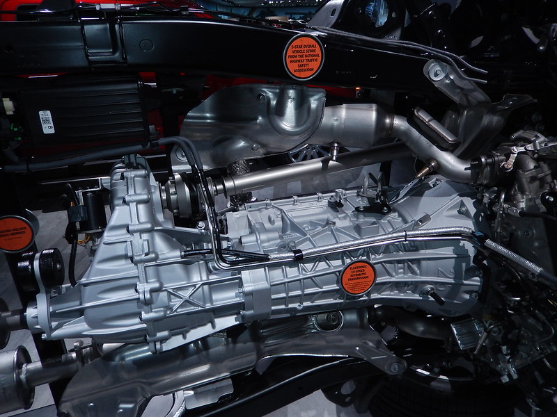

How big -is- the 10R80? I found the weight listed quickly (230lb's) but nothing for other dimensions.
Not really that huge, seemed similar in size to my old A4LD really:
Has anyone dropped a 2019+ Ranger 2.3 engine in a pre-2012 Ranger?
But for the 4wd version what we call the extension housing is now part of the t-case. 2wd would have some sort of housing on the end too.
F-150 version with t-case installed (in F-150 chassis)
Thanks. I remember looking at them in Detroit but didn't have anything side by side for comparison. The weight surprised me, I didn't realize they were quite that solid.
All those plates and planetaries that the case is full of are steel, I bet it adds weight fast.
Stupid little rubber band A4LD is heavier than one would think too (with less than half the gears even on a good day) I bet they are close to 100lbs. Double the gears, make it strong enough to hold real hp... yeah it probably isn't too far off.
As I recall, the 4R70W I've got behind the 5.0 is 170 pounds. It's healthy, but not quite that big-boned.
