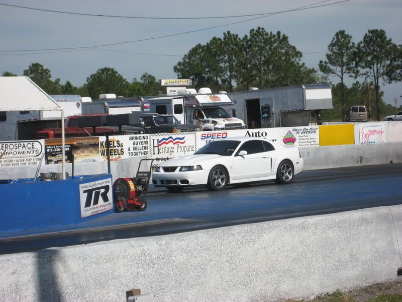

Oh here's a pic of the car

Wow, that sucks about the Cobra engine...looks like a very nice car though! Hopefully you'll get it all fixed up and be back on the track soon. What kind of numbers are you running?

The car was making 700 at the wheels, never had a chance to run the car w/ that setup but ppl w/ the same deal and good driving run high 9's. That pic of the car at the track is on its old setup and it ran 10.8's like that.
