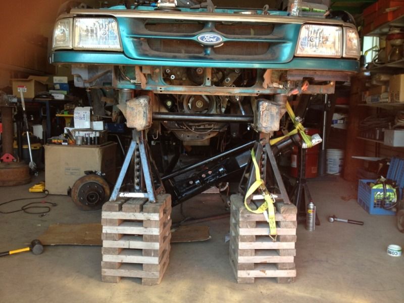

Got some time to work on the truck... get some more stuff together. Even with the 2" B/L it need floor surgery
I ditched the spacers and stock body mounts in favor of 3"x.250" tubing and Hi-density poly for an isolator, should be solid now with no issues for the exo it's getting later.

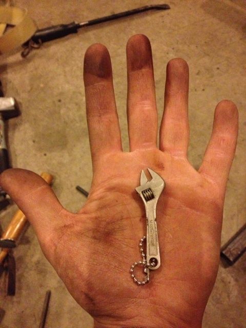

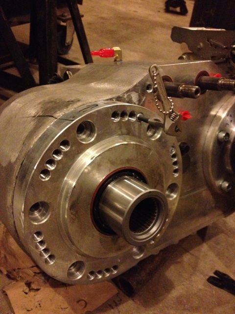

Next up was spinning the 2 broken bolts from my clocking ring on my atlas, dont't ask why... But, for all you ill-equipped gentlemen.... I finally found a use for a small tool!

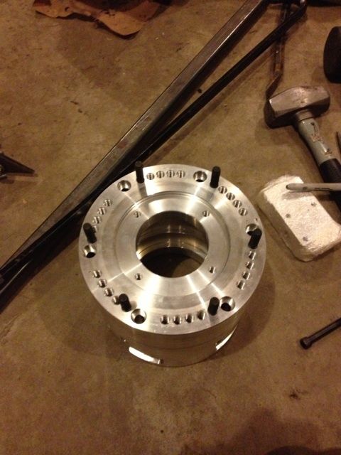

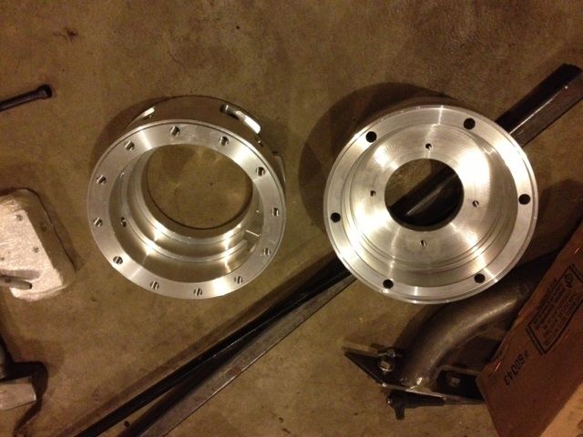

Here's my newest driveline doohicky! D&D machine billet crawlbox, note the slotted holes so it'll run chev and standard 6 bolt pattern.

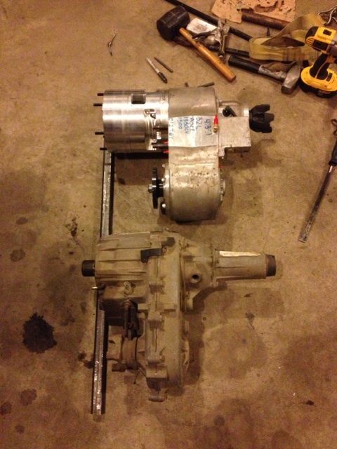

And the combo with the atlas next to the original 241 that came with my NV4500

Wow, that's freakin awesome! Duffy get his house finished? I also didn't know he was making crawl boxes. What did his kit run you?
$700 Canadian, with tax and shipping. No idea on his house, lol.
