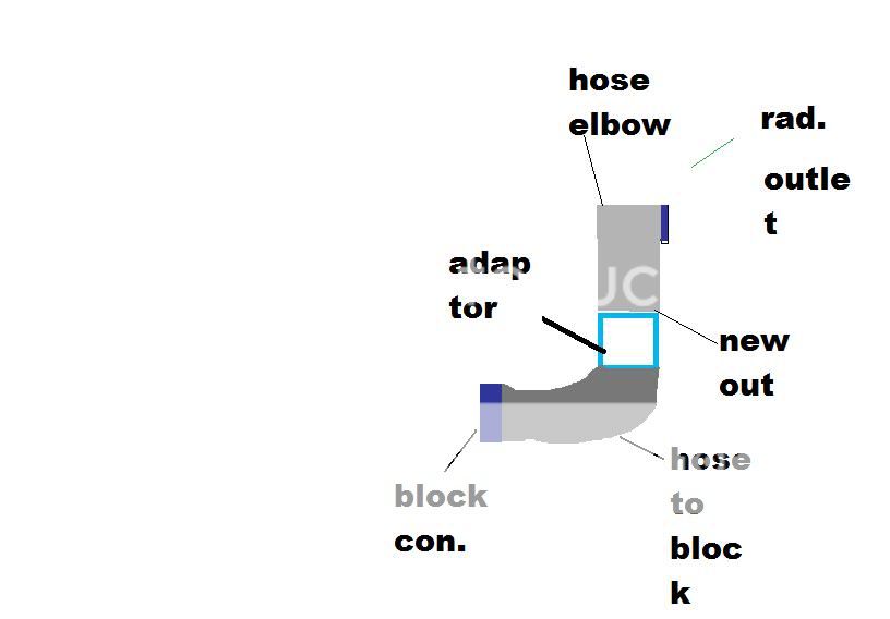

i like putting the radiator as far forward as possible and having them as large as possible as it really makes routing hose much cheaper and easier along with having max cooling potential.
I got a stock lower radiator hose for a 2.9L with a manual. I have another straight piece that's 1-1/2", but widens to 1-3/4" to fit my water pump. I'm going to splice them together with a section of 1-1/2" exhaust pipe. I have the parts. Just haven't done it. Been taking the suspension out of TRS-1 for Vanessa's truck.

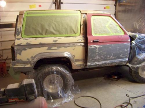

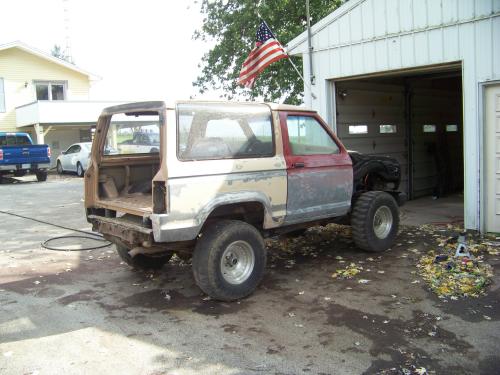

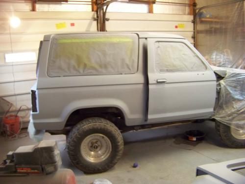

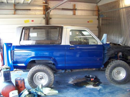

UPATE:
I swapped out the old 302 for the one I had. Got it all cleaned up and detailed.
Swapped in a Gen II dash.
Bought new front and rear seats from a salvage yard.
Replaced the doors with good solid doors that have power windows/locks.
Got the motor running and fixed a charging issue.
Bought new door lock actuators.
Sandblasted and sanded, and sanded, and sanded....
Sprayed it with primer and was sanding some more tonight.
I plan to start putting the color down on Sunday.
This is why I haven't been online here much lately.

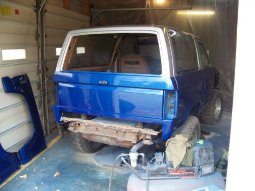

It's finally painted. It's still in parts, but they're all painted. I'm really happy with the way it came it. It's nice, straight and smooth. It seems like I spent forever sanding on this thing.

Nice Jim, paint came out rally good glad to see it's still a 1st gen. Looks like you've got it but if you ever need help with any thing let me know. Especially over the holidays when I'm off work for shut down. We could use another road trip and besides I owe you one.
