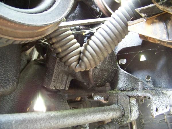

While disconnecting everything from the engine to pull it out, I noticed the lower radiator hose was kinked:
My Bronco II!!
There wasn't any fluid in the upper hose or heater core hoses.
The previous owner sold the B2 after he had the transmission rebuilt because it started to make a knocking noise.
  • My Bronco II!!
Golly gee, I wonder what ever could have happened to make that noise.
