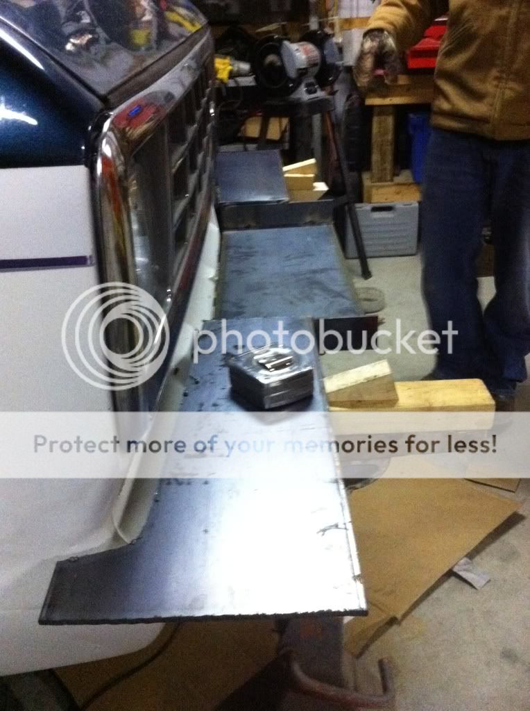

bumpers in progress, been at a friends house 3 hours away all day. just got back home actually.. by next wednesday i should have a "finished" product--- minus paint. got a few lil custom touches that the 1st gen b2 guys might like, but you'll have to wait and see
My Bronco 2
Is all we got finished with bc of the designing we did. Just the top shape towards the body. Gonna be a real finished product and look sweet

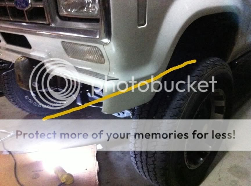

the orange line shows where i'm cutting the body b/c of the height the bumper will be on the ends. its only gonna be like 2-3 inches on the side.. this will help with approachment angle and also when i do the axle swap if i sas i'm moving the axle forward some so....
if i cut this, what's the best way to roll the cut under to finish out the cut? what's the secret? or will i need to roll it under??
I cut 1/4in notches every half inch or so then bent em up. And just so ya know it will crack the paint on the bends so you need somthing to cover it up. I used bedliner
touch up paint is not a problem... i might do a bedliner bottom on it anyways. idk yet. i may just cut it and not roll it for now, see what happens and then roll it when its warmer. in Mississippi 20 degrees is stupid cold to us! lol, i understand to some of yall that's a warm day.

and i'm not gonna roll the metal where i cut it, at least not yet, i'm just gonna cut it and leave it alone for now..
