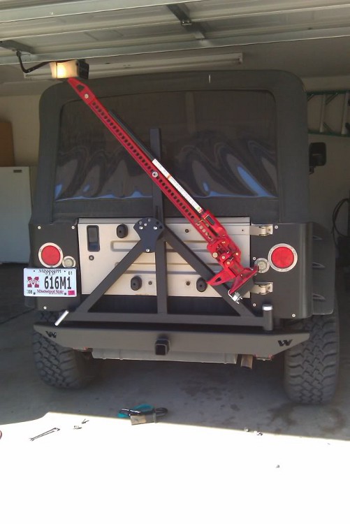

that's another thing i'm worried about.. i want a rear set up like this one...
that way the hilift is not way up top.. i may just do some type of light bar on top.. or maybe nothing on top. idk yet.. i want input! lol
There was one of those here on Cl not long ago. He wanted like $250 for it. Way too much IMO.
well the warn jeep bumper is like 5-600 so...
i'm gonna try to make something i suppose
