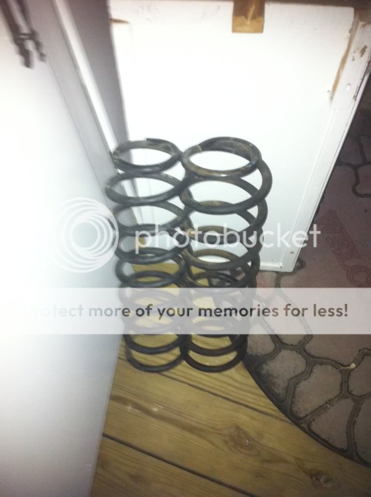

they are stock xj springs i'm gonna use as a base line figure.. this way if i'm 3 inches low, i know i need +3 lift springs for a cherokee.

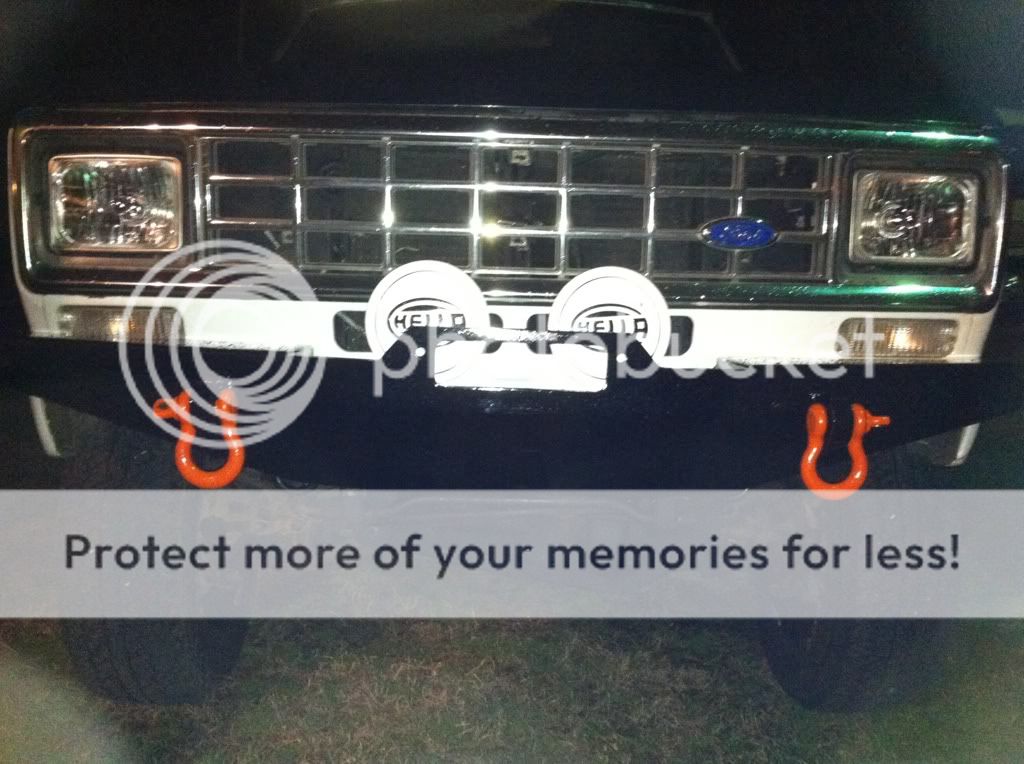

bought my shackles for my bumper today... is that a good update??
....that's all i got....
gettin a spring X" taller wont necissarly mean your truck is gonna sit the same x" heigher it can be kinda harry tryin to find a spring with identical spring rate. aside from that wont be able to get the idea of caster angle or steering/tracbar angle using them. however they would work to help initially locate the axle under the truck during mock up and what not.

i mean d-ring screw pin anchor schakles... lol

I knew what you meant i just wanted to look at the bumper again
Lol I ordered the d-rings, they ain't here yet. But I'll post up a pic once they are here. I ordered some good ole CM brand. MADE IN THE USA! lol

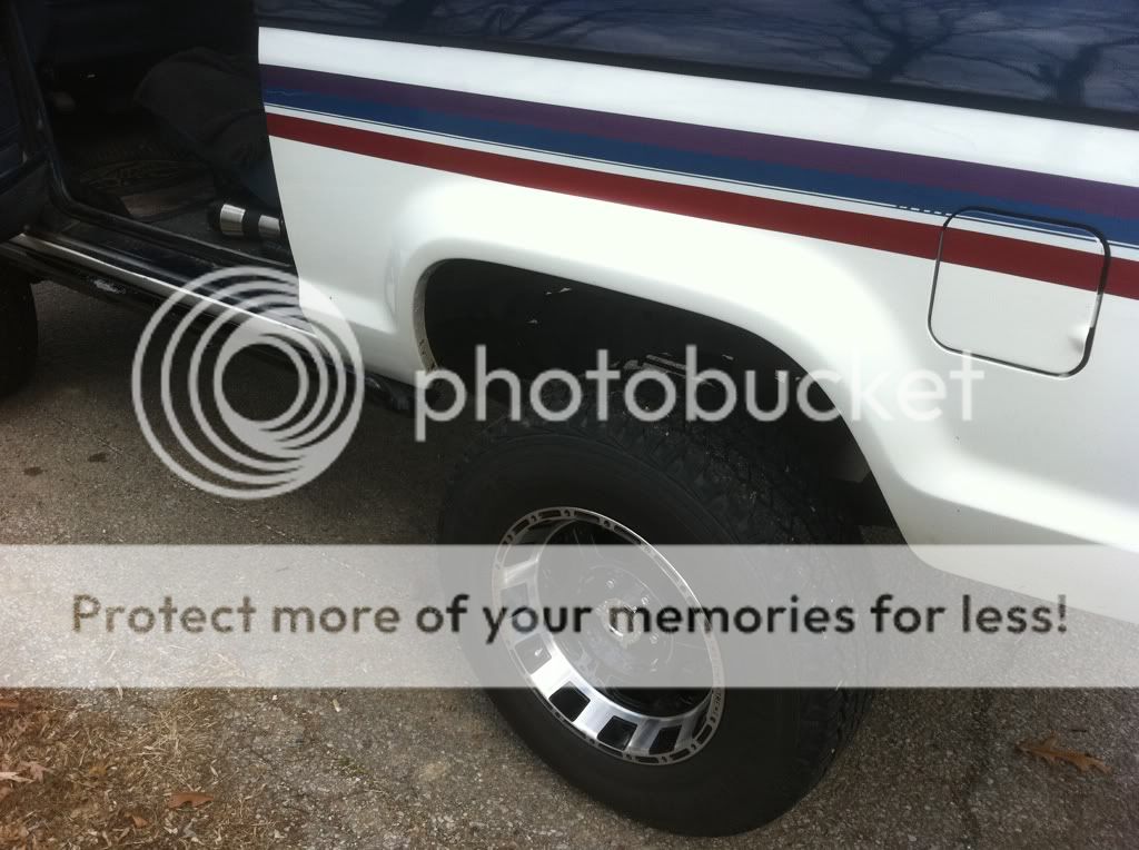

I don't care what some people say, I still love these rims

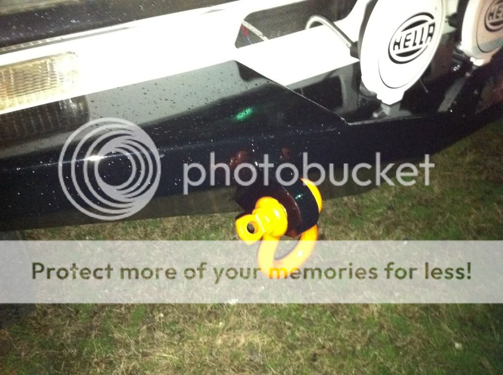

Good old Columbus McKinnon shackles. Made in the USA!
They are orange but this pic looks yellow. I might paint them. Idk yet.
