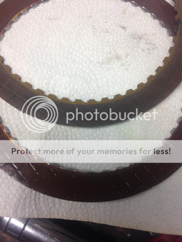

Found this.. Bottom is the one out of the trans. Top one is new. Notice the teeth...
