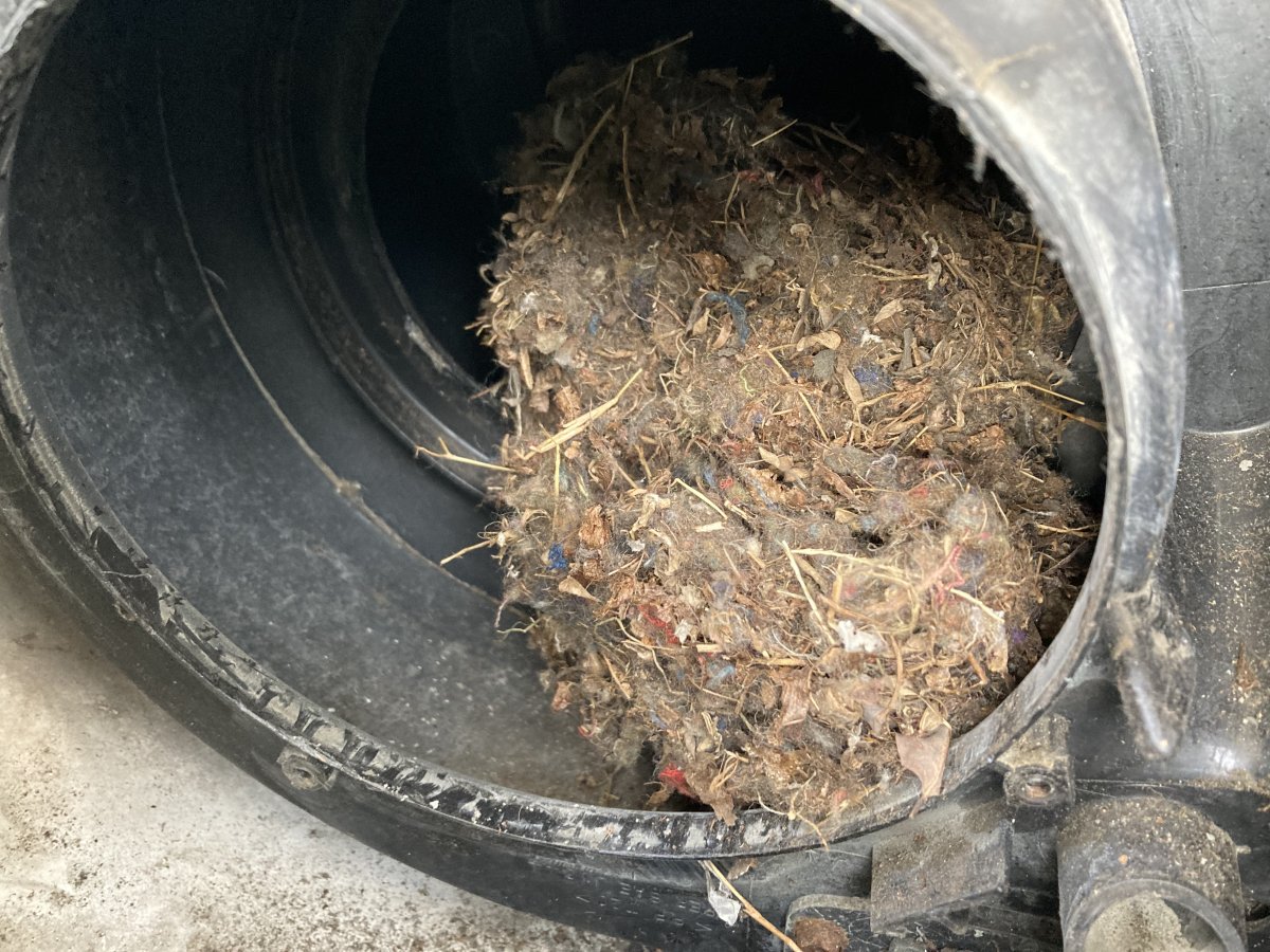

Coming from garage 1st time driving it was a cold MD day, so decided to see if the heat worked: turned on & blower made strange, struggling sounds; then HEAVY SMOKE and electric burning smell!!
Got the old blower assy out today(30 deg @ blowing 20; outside, of course!!);
This was definitely the problem!!
