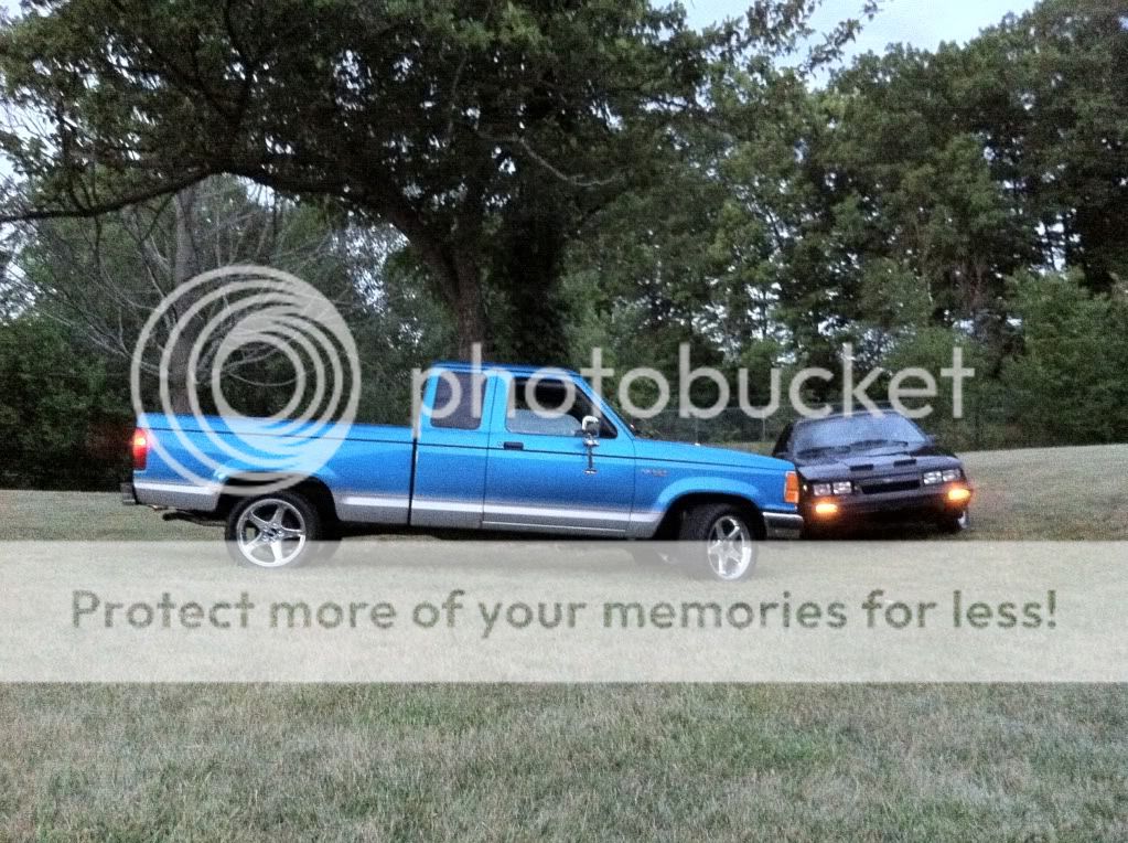

hey I live sooooooo clsoe to you that speedy shop is right down the street from me.lol.
I'm the kid who drive the clean 92' with cobra wheels
