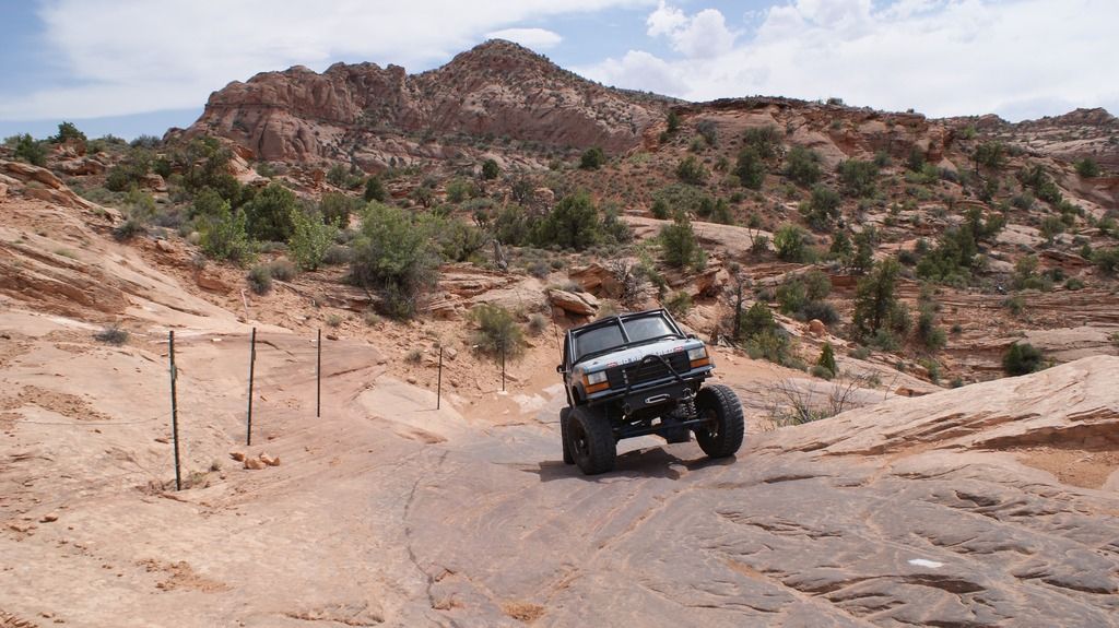

I enjoyed my trip to Moab last year. Looking at the pictures it looks like if you move the rear shackle hanger forward an inch or two you could pick up a little more down travel.
Have you heard if you made the final cut for UA?
Sent from my SM-G920V using Tapatalk
Yeah my shackle hangers will be moved. When I in boarded the springs, we were on a slight incline so all the weight was loaded forward and when I got on flat ground the shackles settled and were completely flat. We had very limited time, cut off the hangers and moved them back where we thought that they should be to fix the problem. Turns out we were off by about and inch. I am going to move them forward an inch here soon when I get time.
