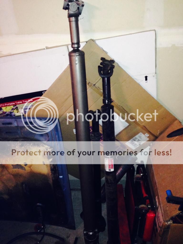

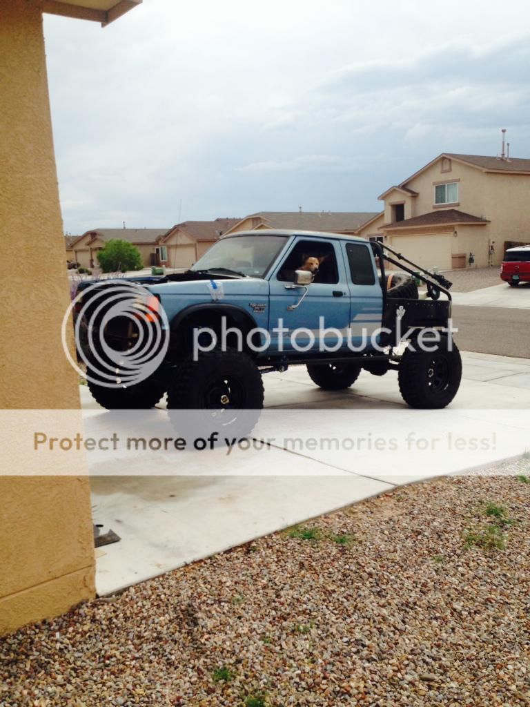

Well I got my rear driveshaft this week and finally got time today to get things together. I had a ton of little stuff to do as well before driving it out of the garage and it took forever. But I finally drove it. Of course after the first trip around the block I noticed oil puking on the header. Found a nice hole in my oil dipstick, welded it closed. I need to get vent tubing for the doubler and tranny tomorrow morning so I can drive it more and get some video. Sounds good and pulls great! I need to mess with timing and tuning more as well. It idles to high and makes the torque converter lockup and stall the engine when I initially put it into reverse or 1st. Also I need a different fan for cooling. It likes to be around 210 idle and going down the road. I will most likely try and find a taurus fan at the JY.
Here is my HAD drive shaft, 1350 both ends, next to my old driveshafts lol
And here is the truck out of the garage finally
