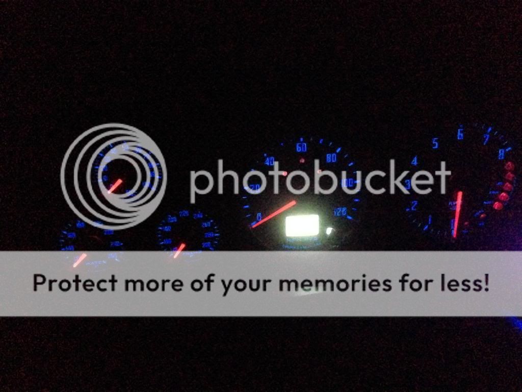

I have a lot more info on the gauges in my pirate thread, but they are 100% customizable, modular wiring, made in USA and lifetime warranty on electronics
Yours may or may not be the same, but when I did the swap on the blue jeep I used autometer gauges, and the gps module for the speedo. I noticed you have to sit for about 10 to 15 seconds after you start the truck for the speedo to start reading.
SVT
That wait is for the gauge to link up to GPS satellite if you dont hook the 12v constant power wire up.When its wired to be hot all the time {like a clock} it works as soon as vehicle is started.

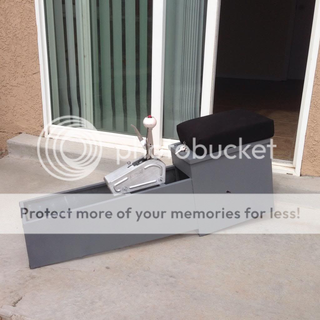

Not much progress this weekend. Finished my console though for the most part. It looks alright, the sheet metal is a pain to work with. The arm cushion I made from some high density seat cushion foam I got at walmart and some thick cotton cloth doubled up (also from walmart). I just cut the foam layers slightly larger than a wooden base board I cut, then wrapped the cloth over it. Really easy. Overall I have about $120 in metal and other materials. **** your tuffy!

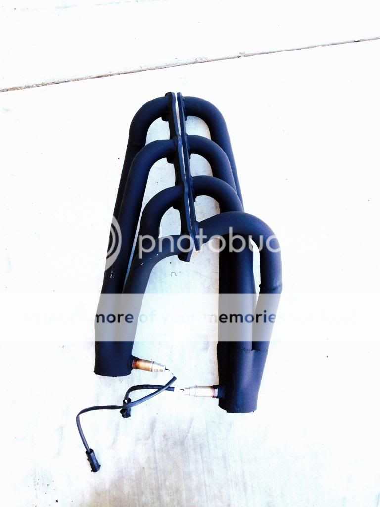

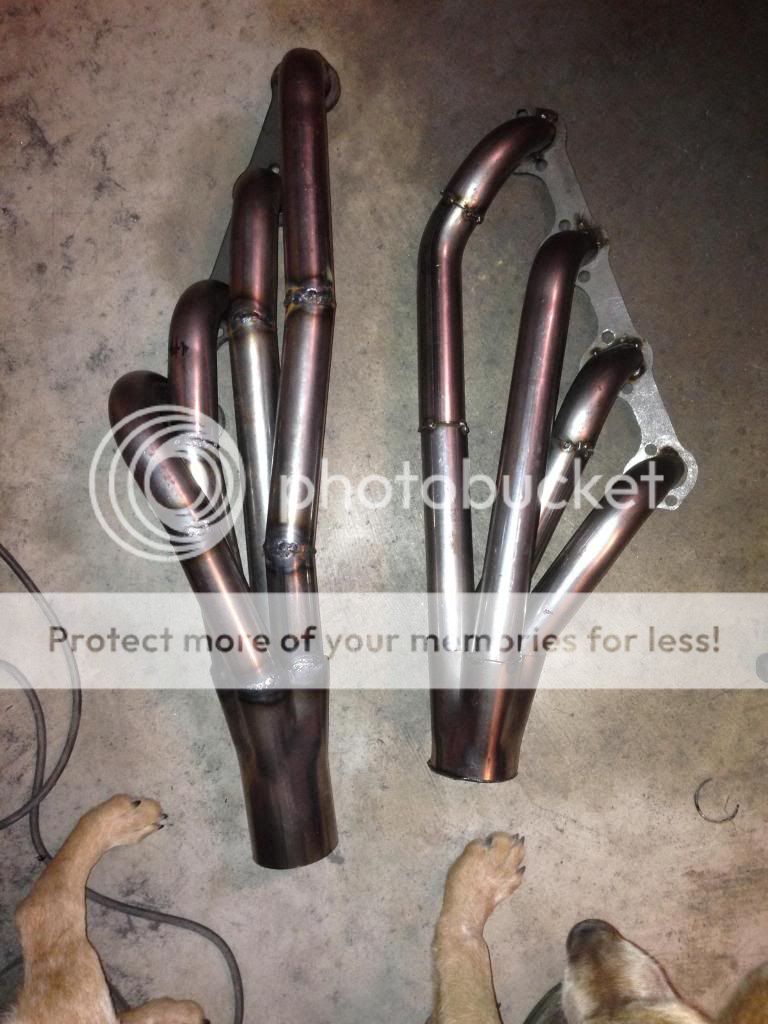

Headers are getting there, Just need some more welding and filler plates in the collector

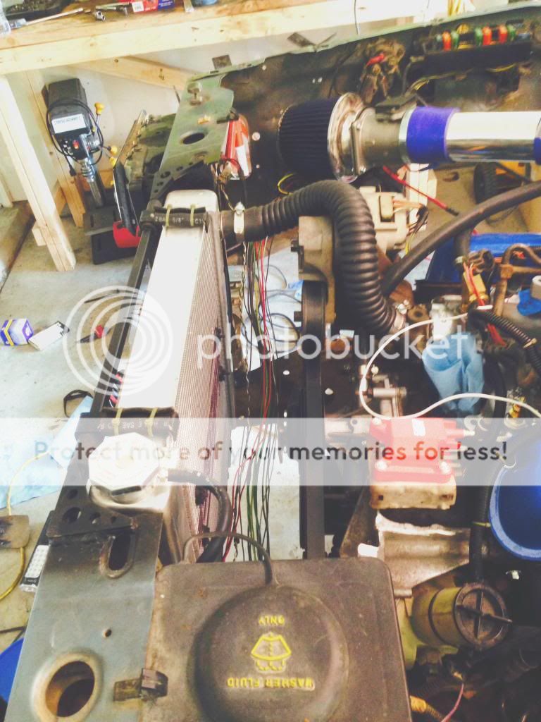

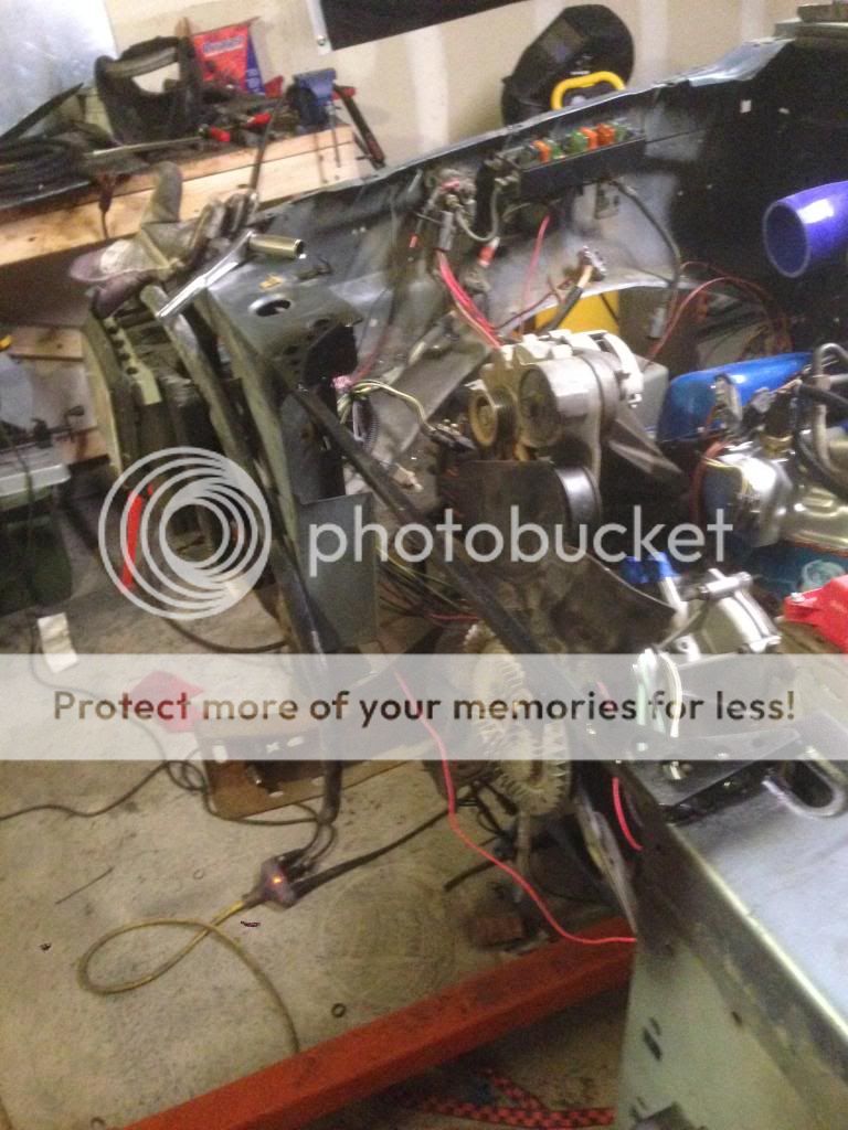

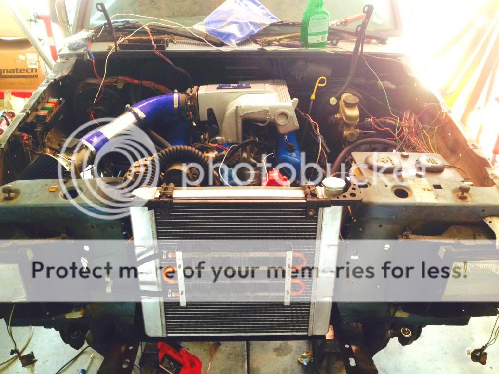

I got the headers welded, 02 bungs installed and painted. I got my radiator from speedway mounted. I had to cut the middle of the core support apart but then made a new upper and lower crossbeam that the radiator sits in. I am using the stock fan and I have clearance to install and remove it with the radiator installed. I cut the AC mount off and mounted the ignition coil there instead. Also I made my tranny hump cover, installed the console, shifter and a battery disconnect. Wired the battery back into the truck, and I hooked up my gauges. They are sweet! Finally I located my remote oil filter. Tuesday I start 2 weeks of vacation, I am planning to crank this engine over this week. I am still waiting on transfer case parts, then I need drive shafts and I need exhaust pieces to run from the headers to the mufflers.
Also the alternator wiring, fuel connects, and power steering were direct swap over to the 89 bronco accessories (except fuel line length)

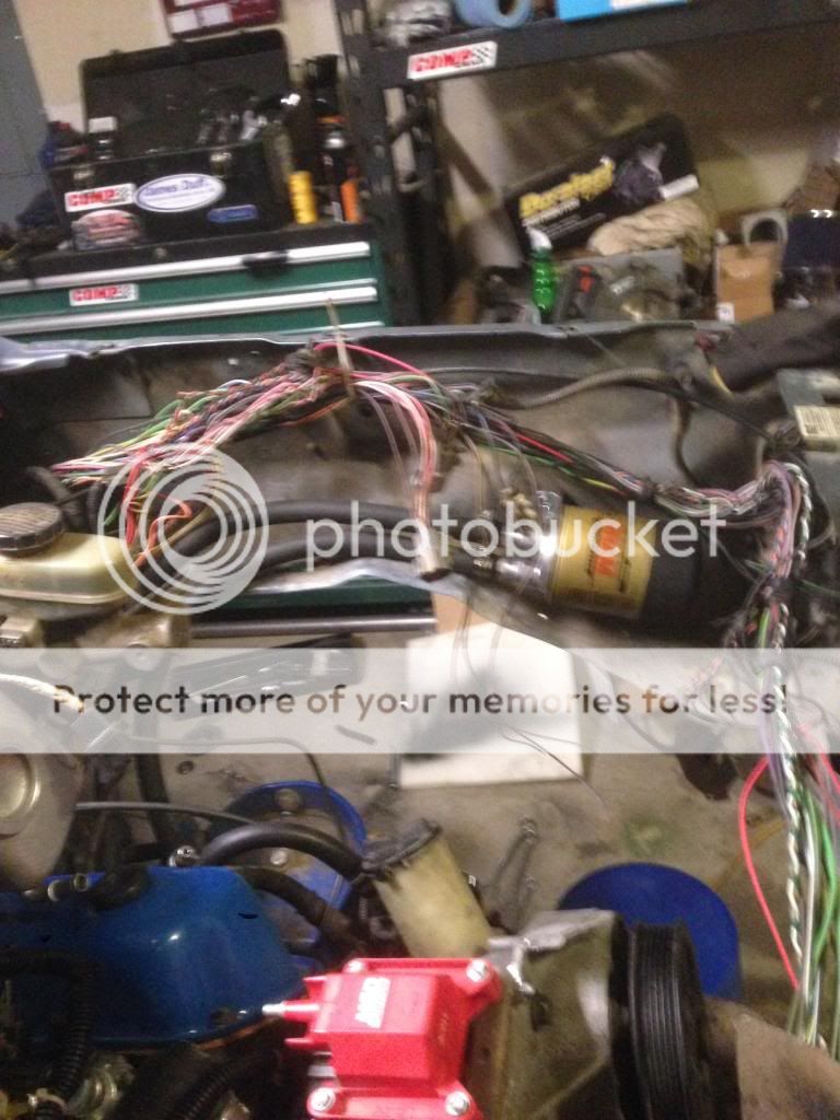

Well I have been trying my hardest all week to get this thing started. It seems the harder I try the harder it fights back. I've ran into multiple issues, had a cracked thermostat housing, junk fuel pressure regulator and now I'm chasing wires trying to get this thing to run. I think I have it all figured out and hopefully tomorrow I can hear this thing breath (open headers).
The motor and tranny are all permanently installed, Im waiting on my shifters and front output shaft to install the transfercases, then I can make the exhaust and measure for drive shafts to get this thing on the road.
Here is how my headers turned out:

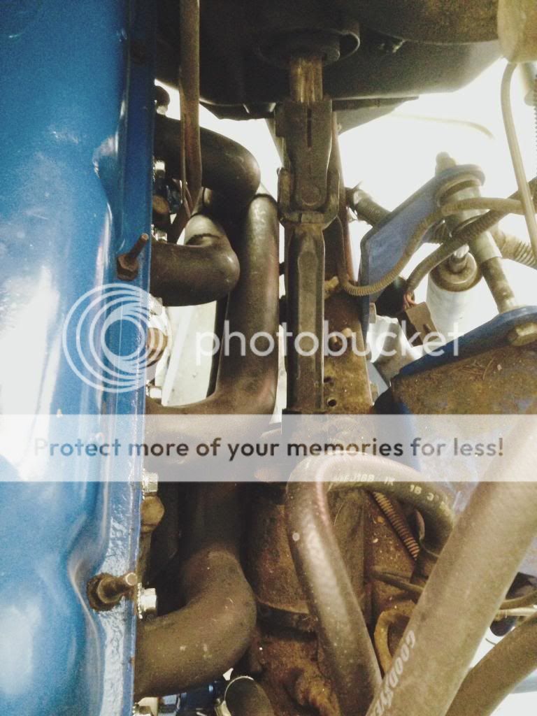

driver side clearance next to steering shaft:

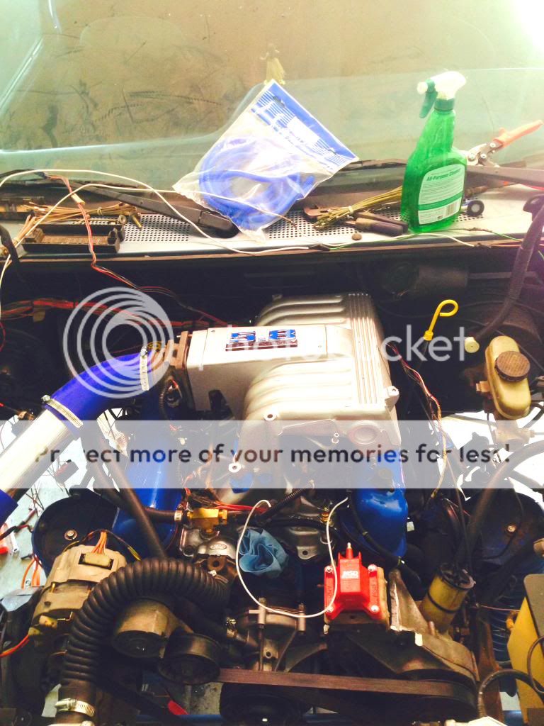

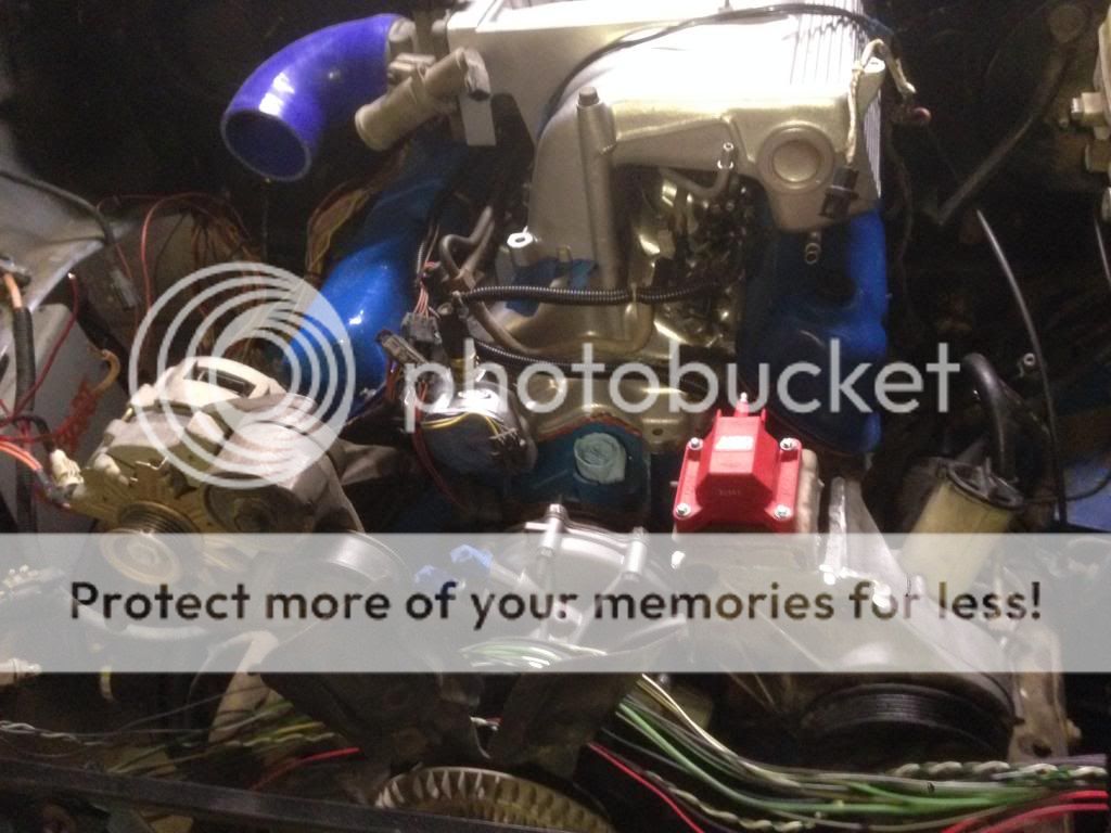

Here is how the engine and everything are looking:
My 91 Ranger the stRanger
I deleted smog and AC, I used a 83 3/4'' belt to make it work.

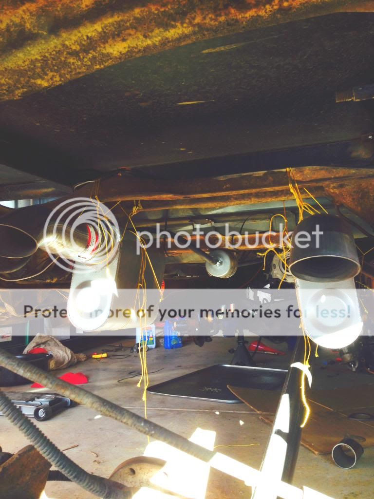

Here is how I am planning to run the mufflers, driverside is going to be especially tight with the 3'' tube and transfercase
