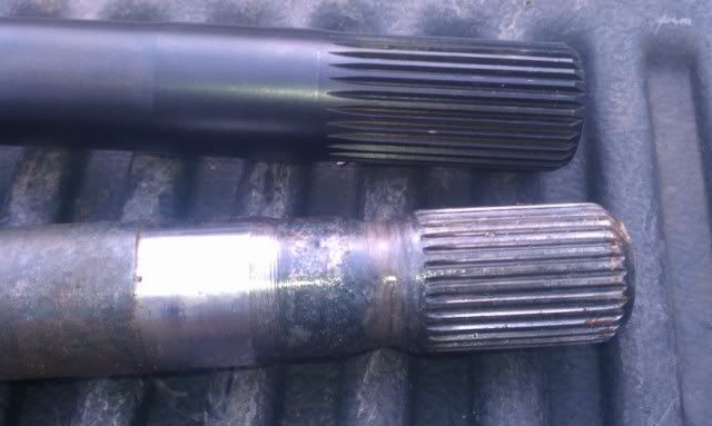

Found this when I took the also broke shit out. Never seen one break like that. lol

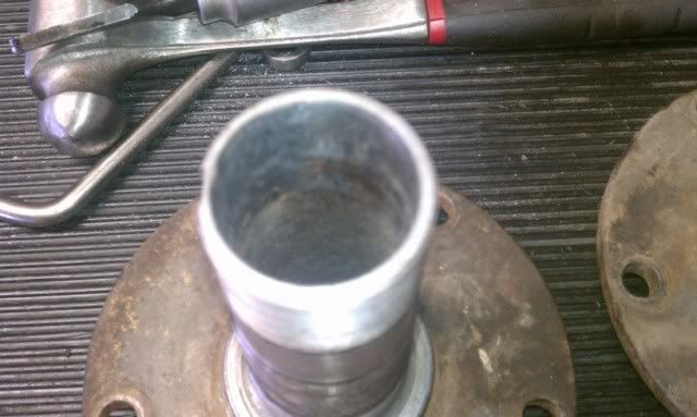

Only had to bore out the last 3/4inch of the spindles .010 to get clearance around where the splines on the stub shaft are. Just used a die grinder.

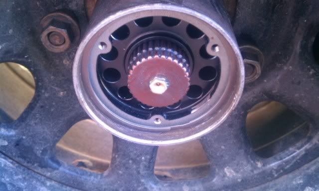

Got the drive flanges today.
