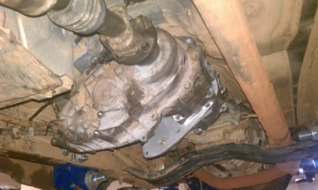

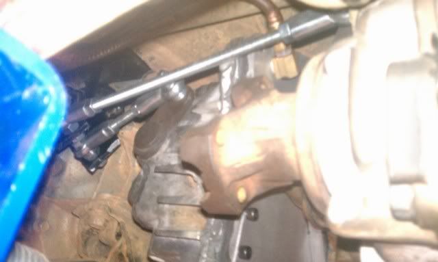

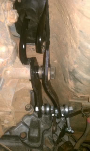

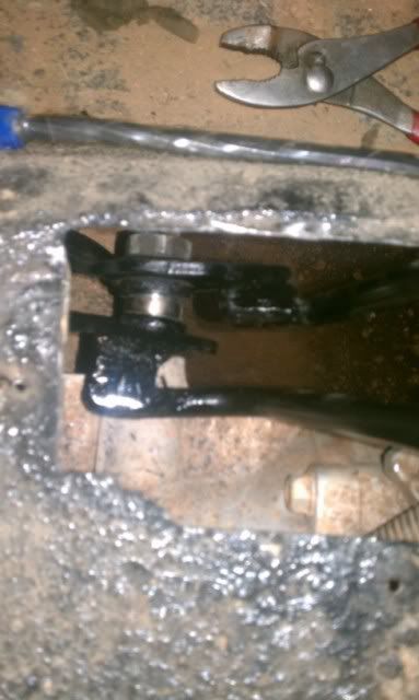

Doubler is in. I officaly have a mall crawler now. It will definitely crawl and it temporarily 2wd until I get to build the trans crossmember.

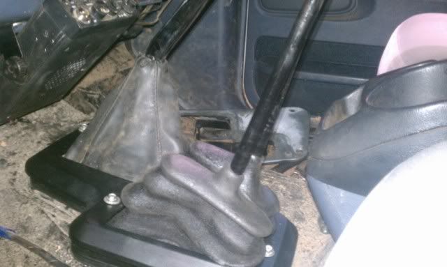

Got it all in today and make the shift handles. Double low is badass. Cant wait to get it out and do some wheeling.

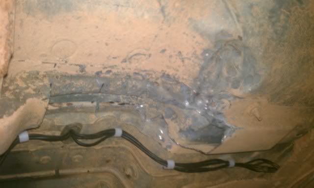

Had to get the bfh out on the floorboard.
Got room for it now.

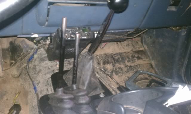

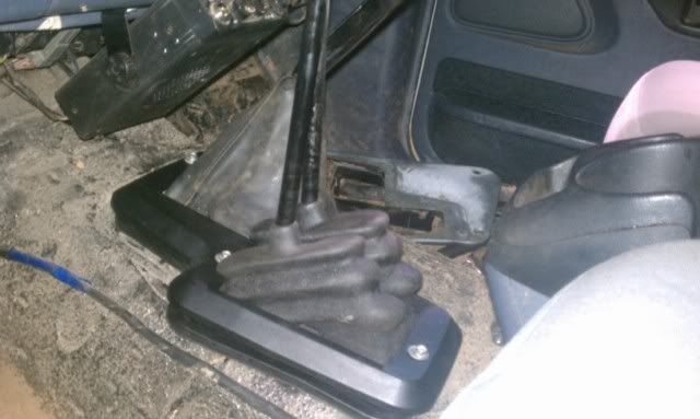

Shifters and double boot. Still got to cut the shifters to length and thread them for some knobs so dont mind them yet.
2 high
4 double low
Going to run to Napa tomorrow and see about getting a new longerspeedometer cable so the speedo will work again.

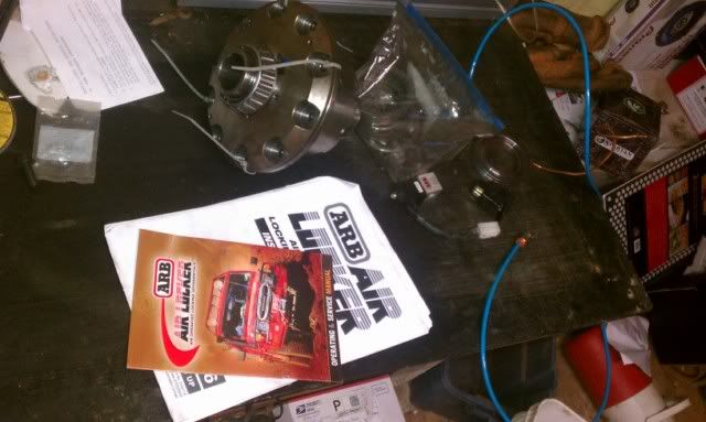

Well was about to order a set of chromo shafts for the front the other day and ran across this for a deal. ARB for the d44. Got it from bronco2guy. Going to save up a little more cash and get some chromo axles next.
Came in the mail today.

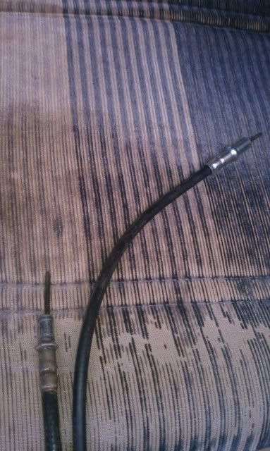

Also got a new speedo cable from Napa today. Stock one was too short with the doubler. Its for a 91 Aeroster and has the same ends and is about 8" longer. Works prefect.
Shows how much longer the stock.

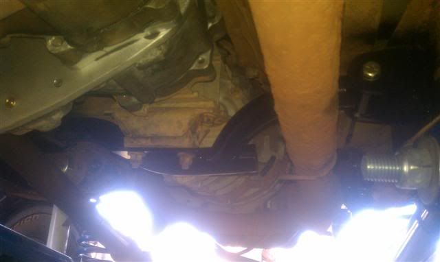

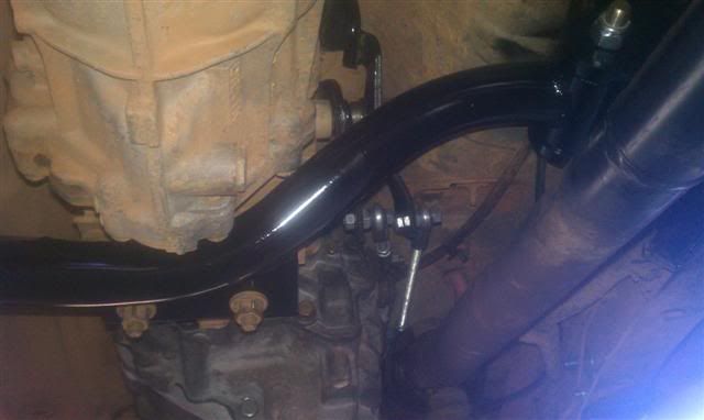

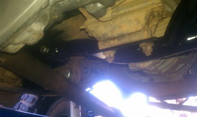

Had a crossmember fabbed up today. Not a lot of room to work with under there with the driveshaft and exhaust in the way and wanting to keep it tucked up in the frame. lol
Pics suck.
that crossmember looks sick!

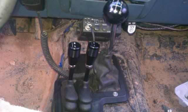

Got my shifter knobs for the doubler today so pulled the shifters out and cut them down and threaded the ends for the knobs.

those twin sticks look badass, very nice work. also everyone go vote for this explorer in the TOTM lol
damn its looking good buddy. Good luck in the TOTM. (pss.... you got vote :icon_thumby:)
