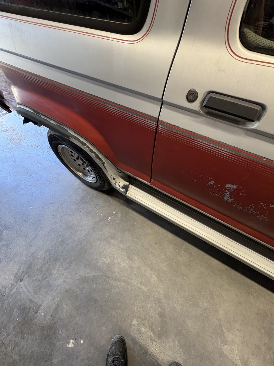

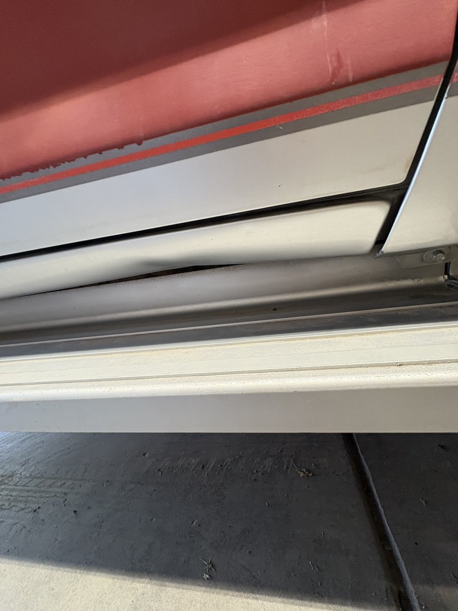

Hello RobbieD, That is a nice, mine is not as nice as yours. It is in need of some work. Your truck looks great. I am starting a build thread on it. I like the running boards but I worry about rust. If you want these, you can have them. The passenger side is broke but probably with fiberglass work, they can look good. On the bottom picture, this is biggest dent and it damaged the running board I will get a better picture soon

Hello RobbieD, That is a nice, mine is not as nice as yours. It is in need of some work. Your truck looks great. I am starting a build thread on it. I like the running boards but I worry about rust. If you want these, you can have them. The passenger side is broke but probably with fiberglass work, they can look good. On the bottom picture, this is biggest dent and it damaged the running board I will get a better picture soon View attachment 126378View attachment 126379

I will be following your build with much interest. And thank you for the offer, but the shipping would probably be too big of a nut for me or else I'd work something out you on the flairs and running boards. You may want to consider putting the set up for sale on some wide-reaching venue. They are tough to find these days, and even with the damage (glass work isn't that hard) you might could sell them for some good change.
Yes, you do need to assess if any rust is involved with those. The norm when we installed glass parts on trucks back then was to set 'em in place and then use screw guns to run 3/8" drill-point screws through the glass and into the fender lips. Same routine for the braces under the board part. I'd try to brush or blow the metal chips off before running things home, but most installers didn't care. So you may find localized rust around the mounting points, especially from metal chips.

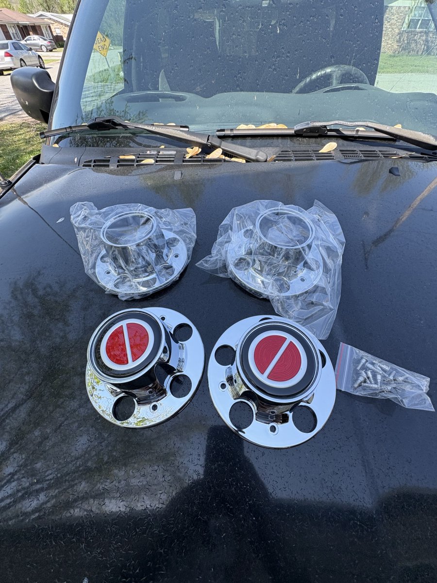

Finally got my center caps in the mail.

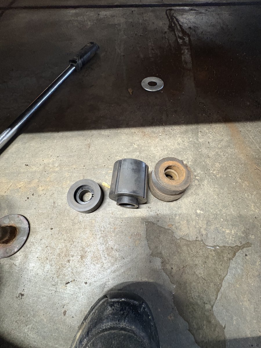

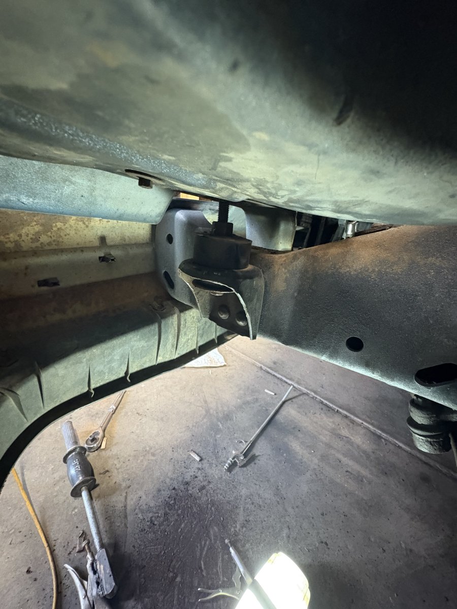

I started on body bushings. Started out great. Bolts came out easy, front bushing went in great. Then got to floor board and rear cab section and bushings don’t want to come out.
My 87 Ranger I will be restoring soon   I want to keep track of my progress and add information as I find it.
New bushings should get cab level with the bed. These are stiffer then factory do not expecting a smoother ride but bed will be level and new parts will be on.

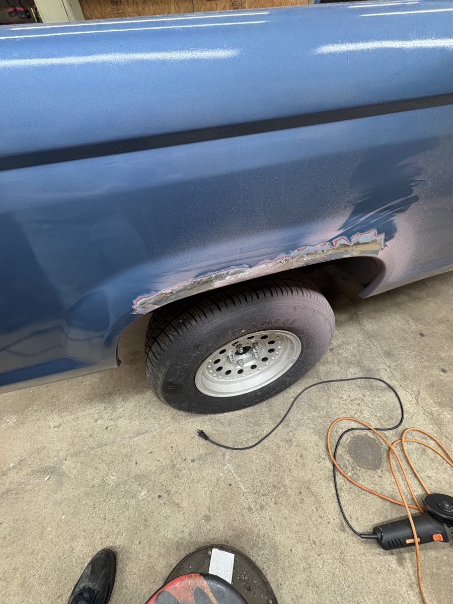

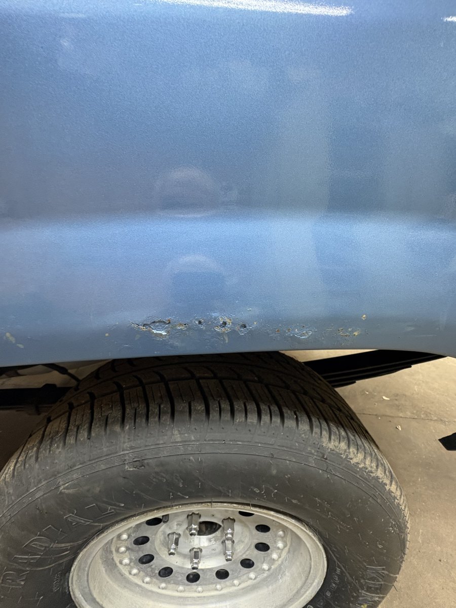

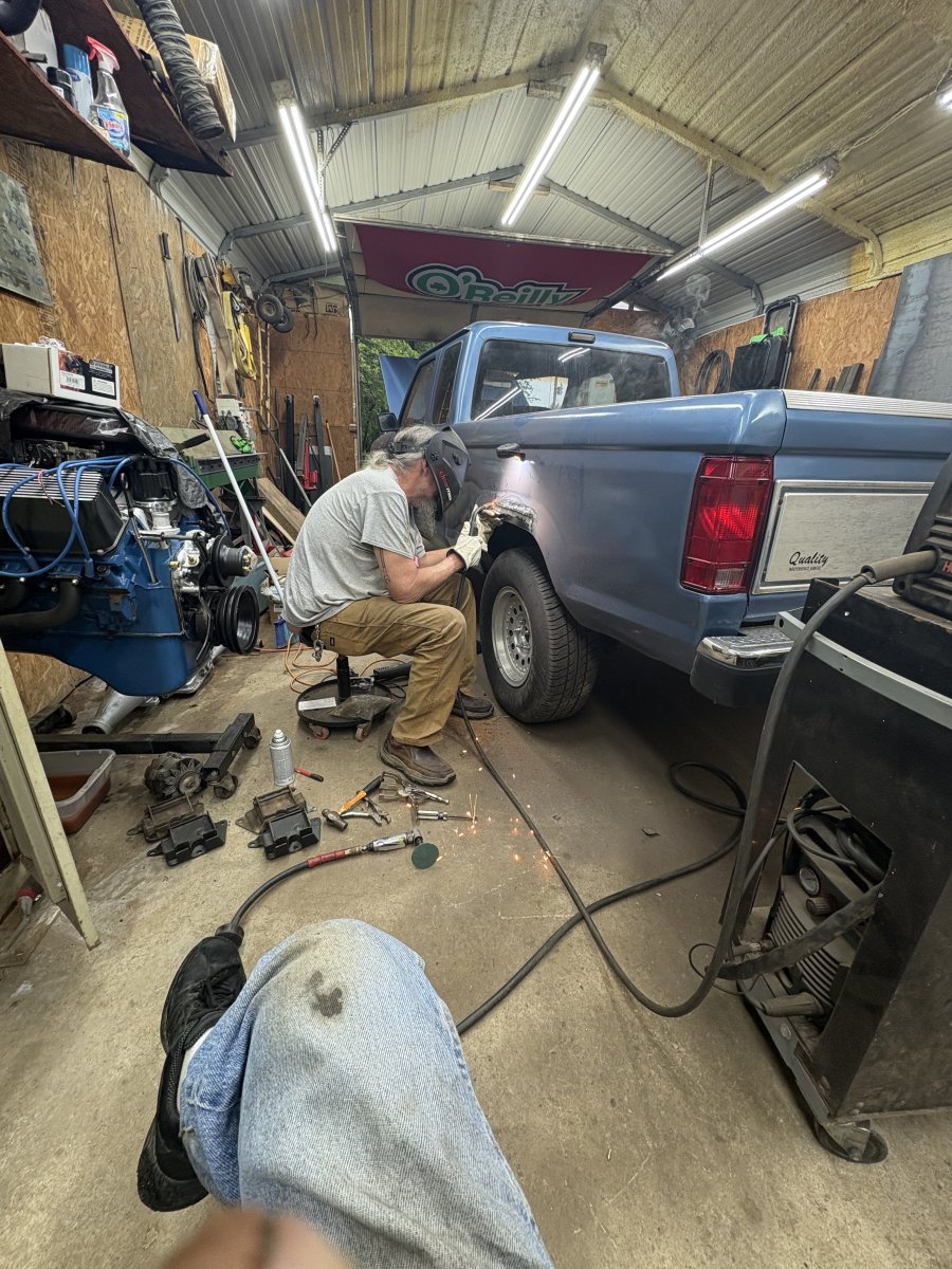

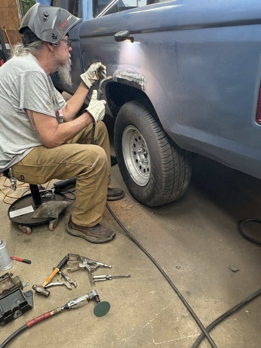

Last weekend I went to a buddy’s house in Tennessee. 1000 mile round trip. Longest journey for this truck. I mentioned earlier in this build I would paint over the rust until I could have my friend do the patch panels.
Here is driver side done. I will repaint at a later time.
He can do a better job than me. While he did my patch panels, I did mechanical work on a 79 Dodge he is taking on Power Tour. Occasionally we get together to help each other out to get projects done. You can get quite a bit done doing this.

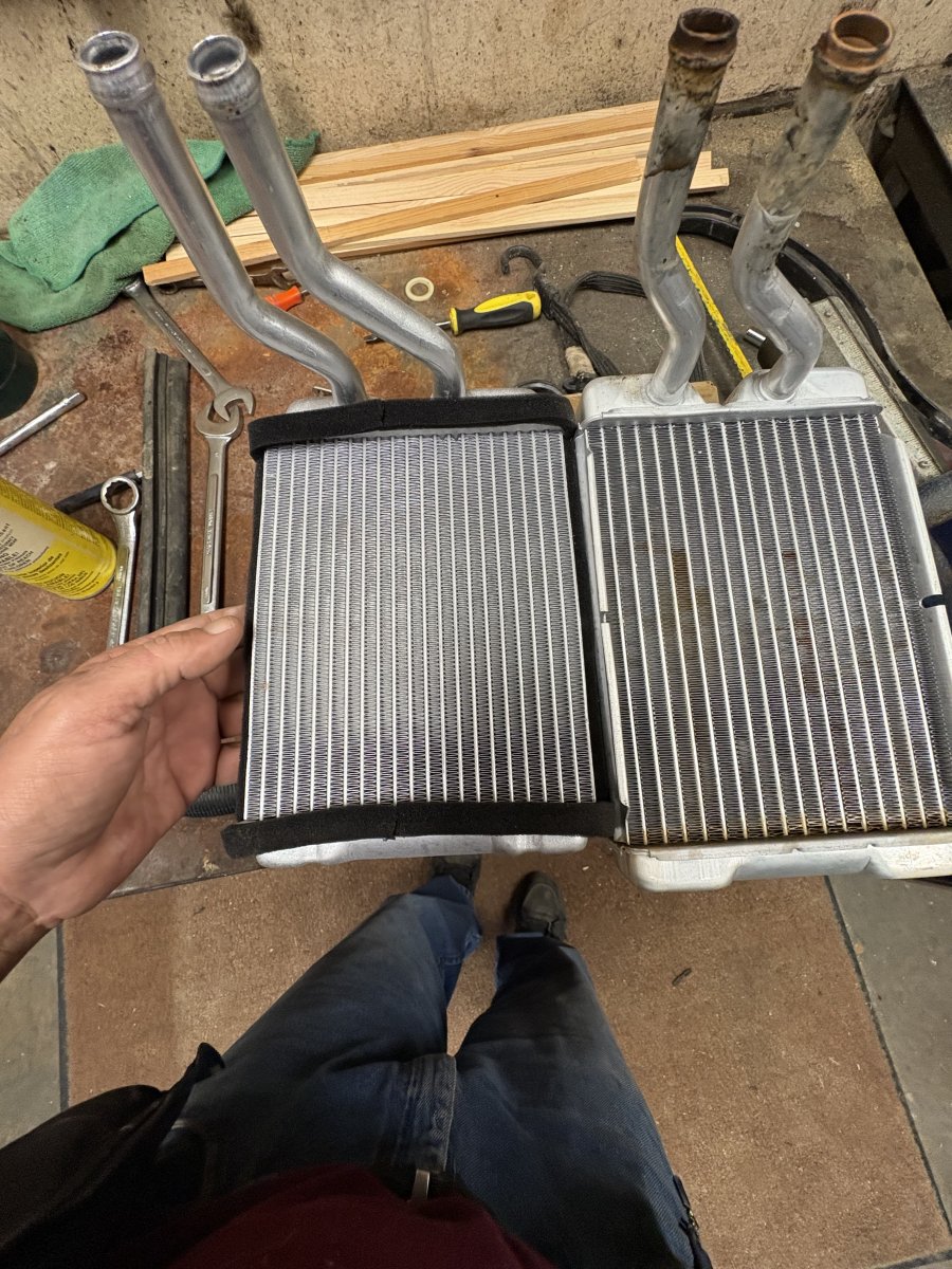

On my way home, first two hours I froze my butt off. Heater leaked. It’s a new heater core. I just by passed it and drive home. Other then heater core issue it ran great. Jason doing drivers side.

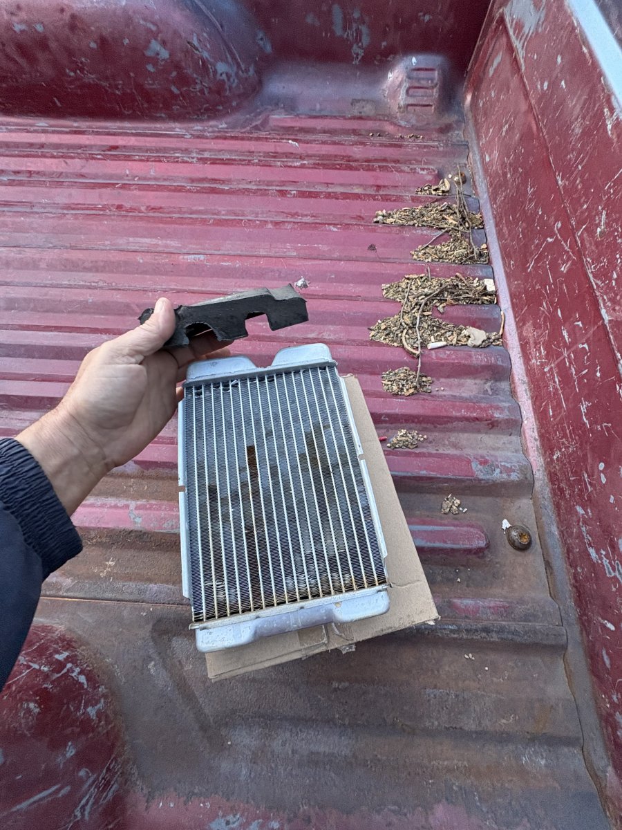

When I did my cooling system I did change heater core. This did not fit the best and already started leaking. Froze my butt off for first two hours on my way home drone Tennessee.
The one on the left I got from Rockauto and it fits better. It was originally for the Bronco.

This is the brand I got from Rockauto.
