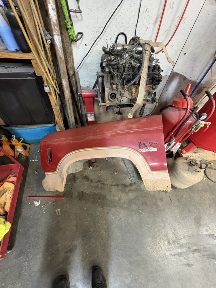

I posted an aftermarket fender I bought. It is actually well built but just has fit ment issues. I got one out of the boneyard.

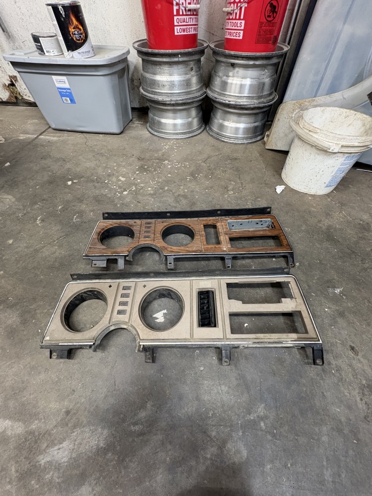

As I understand it. These are the early style Bezels. I grabbed them as parts won’t be available forever. I don’t need them but might be able to help someone in the future.

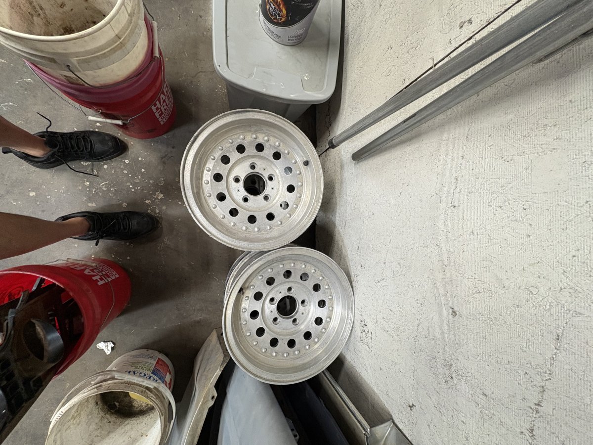

I also got a set of stock rims. I have several hours polishing them. Not really happy with results. We have powder coating company near by and will check into cost of having that done.
I also got a set of stock rims. I have several hours polishing them. Not really happy with results. We have powder coating company near by and will check into cost of having that done.View attachment 119772
That many nooks and crannies would make polishing those pretty miserable! Glad to see you working on your Ranger again!
My 83 has a solid tan colored bezel like the bottom one in your pictures. I wondered if they came that way or if the previous owner painted it. Yours makes me think it was a factory color. Cool.

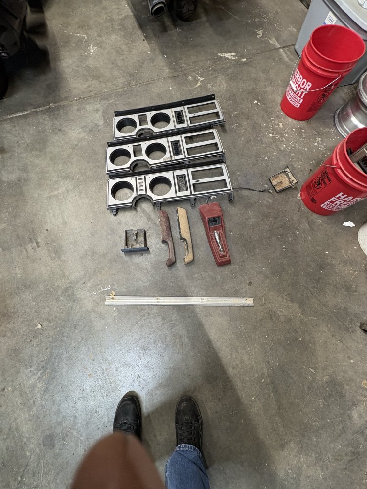

I did make it to the boneyard the other day. Got 2 chrome bezels in better shape than what I have. I got another early model bezel. My ashtray is broken so got another. I am missing door trims. I was able to one out. I will get the other when I go back in a week or so.
I got a map light. I am guessing this was an option in the older models. Grabbed it as I figure it is hard to find.
Original sheetmetal is almost alwaysd the best, but isn't always worth the time and effort to track down good examples.
Top bezel could be 85, hard to tell from that picture. 85 was one years only having the 4 indicators and the DIN radio cutout.
Bottom bezel is a cut out 83-84, and looks like it has been painted.
Not going to say that ttan didn't exist, but every first gen ranger bezel I've seen came from the factory with either a brushed metal (silver) or a wood grain finished. Seemed like 83 had several one year only things, so that may have been one of them.

Bezels... Top two are 86-88. Bottom is 85 only, it'll fit 83-85 but only came in 85.
Does that map light have 4x4 buttons and/or indicators? If so that was definitely a good find. Decent map lights are hard to find regardless, but the 4x4 ones seem even harder. If not 4x4 what is in the information display?

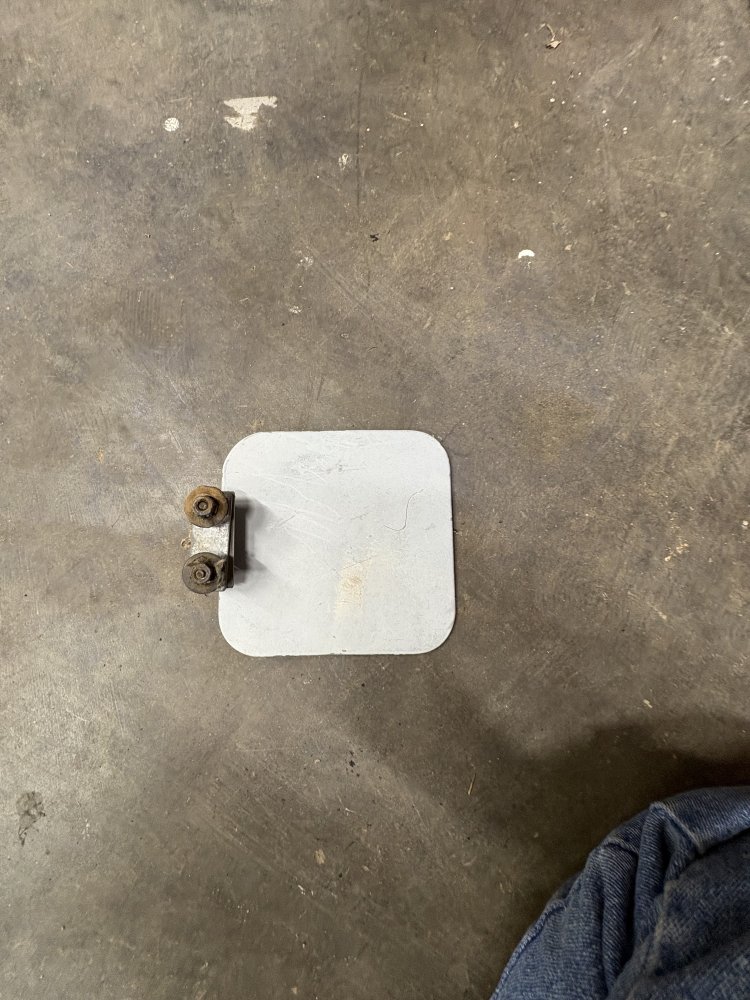

Seems like ytou enjoy picking the salvage yards, so I've got a request and it'll be a long shot. Some early Rangers had a flat fuel door, no finger bump. From what I can gather it was an 83-84 only thing, and not even all of them got it. Might have been an individual assembly plant thing? Anyway I'd like to get my hands on a few of those fuel doors if you happen across them.
Hello Josh T … It has Date,Time and ETime. I think this did come out if a two wheel drive.

Ray or Jballard. I guess I found the hens tooth. I’m on my phone and not showing who was looking for it. It came off of a Bronco2. I don’t see why it would not fit. It is a flat door and does not have the finger bump like the newer model does. PM me your address and I will get it in the mail. It is in great shape. Paint is just really faded bad.

Not the 4wd map light, but that would be a good fit for someone with a 2wd or without the manual shift transfer case that wanted it. Either way, don't often find them in that good of shape. I was just giving the bezel years as an FYI for you or anyone that may be curious about the differences.
Am I the hens tooth or the fuel door? It could apply to either I suppose. I doubt many people would even notice the difference, and even fewer would be actively trying to find one.
My first vehicle was an 84 Ranger. It had the flat door and that was one of the little quirks that always stood out to me. Totaled it back in 2009, but still have it hoping to do womething with most of the good parts at some point. Picked up an 85 a couple of years ago to fix up and that is one of the pieces that want to move over when I start working on it. Problem is that the 85 is a dual tank truck and I've only got one door.

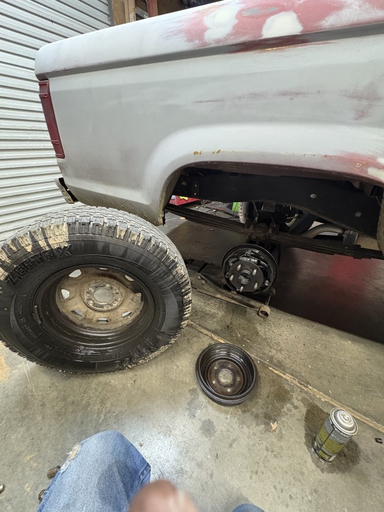

Well … Rats!!! When I did the brakes on this truck. I did EVERYTHING!!! with all new parts and with best quality parts I can get. On the back side it is not the line so must be the Slave Cylinder. I had to add brake fluid one day and did not think much about it as my brake light come on. Just barely low in the reservoir so did not think much of it.
Next day brake light came on again and knew I had a problem. Did not take long to find where problem was at. I hope to get it fixed tomorrow.
I do have a rear main leak. It was just a drip every now and then. Now it is more steady. I plan on doing clutch and rear main this winter. Clutch Slave Cylinder is getting spongy so a few more bugs to chase out if truck. Painting is going to happen this winter.
