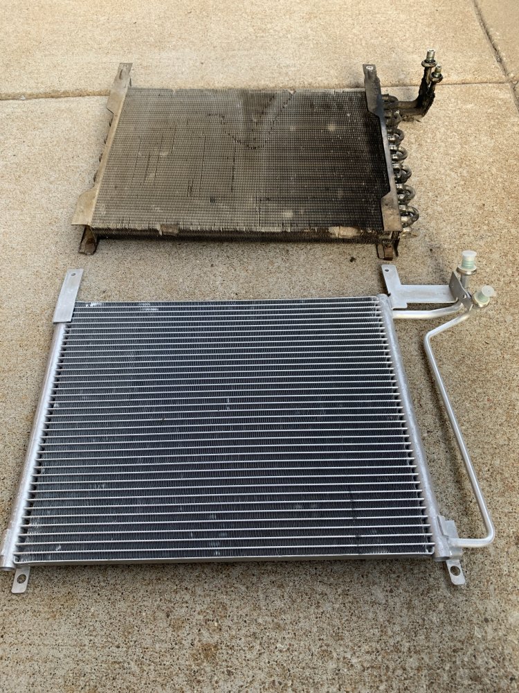

The new Condenser is half the size of the factory one. I just don’t think it will do as good if a job. Don’t think there is a way to see if the old one can be cleaned inside all the narrow passages.

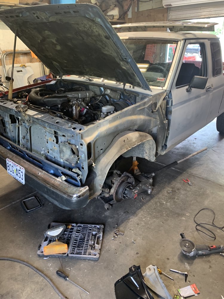

Seems like I get to do everything twice. My new Condenser does not fit. I would need to trim some clearance in the shroud. Not a big deal but I want as close to factory as possible.

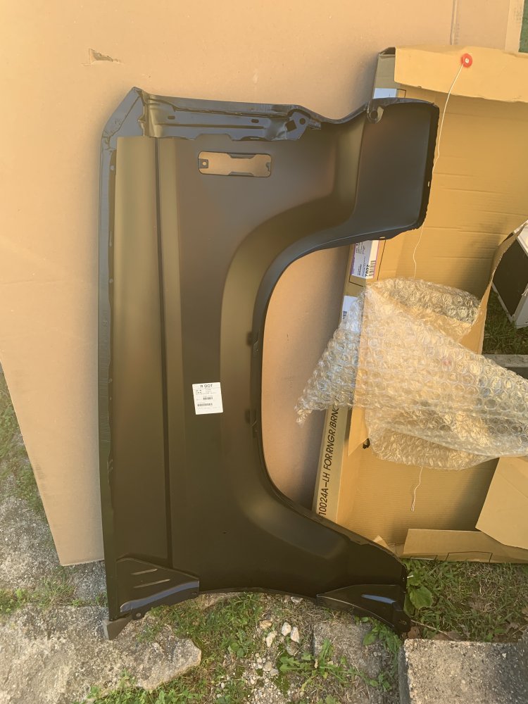

Never had anything like this before. This is my fender order.

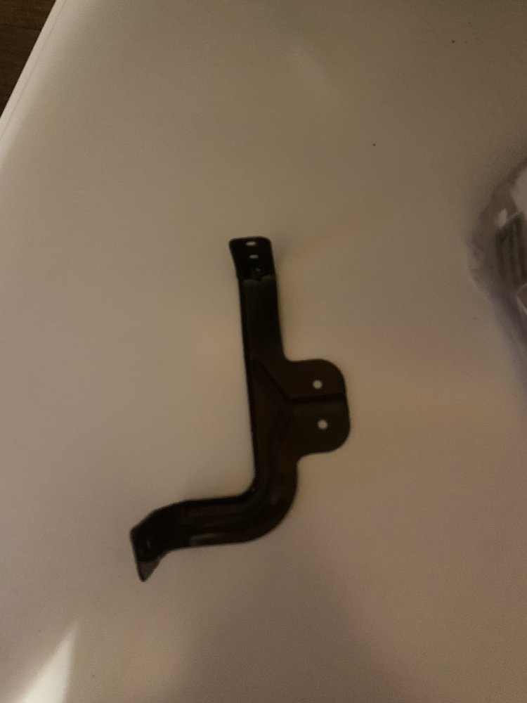

A Big Thanks to Awesom-O. I got the Cruise Control Bracket today. I appreciate it. Send me a PayPal and I will get you paid for it. It is in fantastic shape.

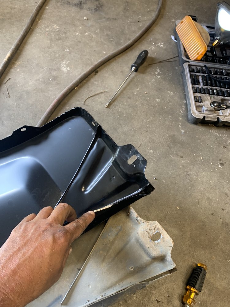

I got my fender from Amazon. It is made in Taiwan. I have worked with aftermarket on the past. Some were terrible and I really feel some were better made then factory.
am completely satisfied with the packaging of this fender. I then looked at the inner brackets and it really looks to be a great fender. It made by Tang Yong. The seller is Koolzap. I am looking forward to seeing how the fitment is.
All the inner structures look to be factory.
I went ahead and installed the Condenser that is half the thickness of factory. I just don’t see how I could get all the runs cleaned in the original and not knowing its condition.
I could guess at how much Freon to add but am having a local shop to do it for me. I also installed a new Compressor. I still have all the components with the plugs to keep moist air out of the system.

That fender actually looks pretty good.
I have those fenders from Tong Yang. The stampings are very prominent and some lines are harsher than factory. I chose to fix my front OEM fender, but have these for the BII and will be using them.
Hello Robbie D... I am quite impressed with these fenders for replacement fenders. I am having one small issue but until I can find a factory fender it will work. I know a guy that might could tweak the little bit that I cant just cant get just right.
Hello Awesom-O.. These fenders are really great quality. If I can get them to sit a little further back by the door, I would stay with them. I will eventually find a salvage fender in the yards around here. But all in all I am really happy with the replacement.

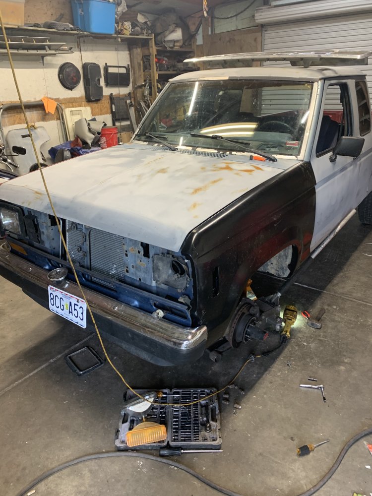

I am finally getting around to getting my aftermarket fender on. I need to get two nut/ clips to hold the rear and top fender bolts on as mine were rusted up and broke.
I did have to do a little grinding to get the fender to sit against the body a little tighter.
I am going to need two nut/clips to completely finish the job but I think this fender can work. Taiwan parts can get a bad rap but I have seen some great parts too. Got some surface rust that broke thru the primer and plan on getting it knocked off this weekend. Probably still going to be a month or two before I get it in paint. I’m ready for that to happen.
I know some can have a hard time finding fenders, but Tong Yang, Overall, I am really happy witht he quality of the fender. I have seen some really junk replacement fenders but these are proabaly about as best as you are going to find. Original is best.
Yeah I think they are going to be fine on my BII build. I got one for each side as I stated earlier the first gen fenders OEM are rare as hens teeth in good shape around my area. Either rusted or severely dented or cut out for large tires. Glad to hear it’s going good on your build. I’m almost ready for paint myself and can’t wait.
