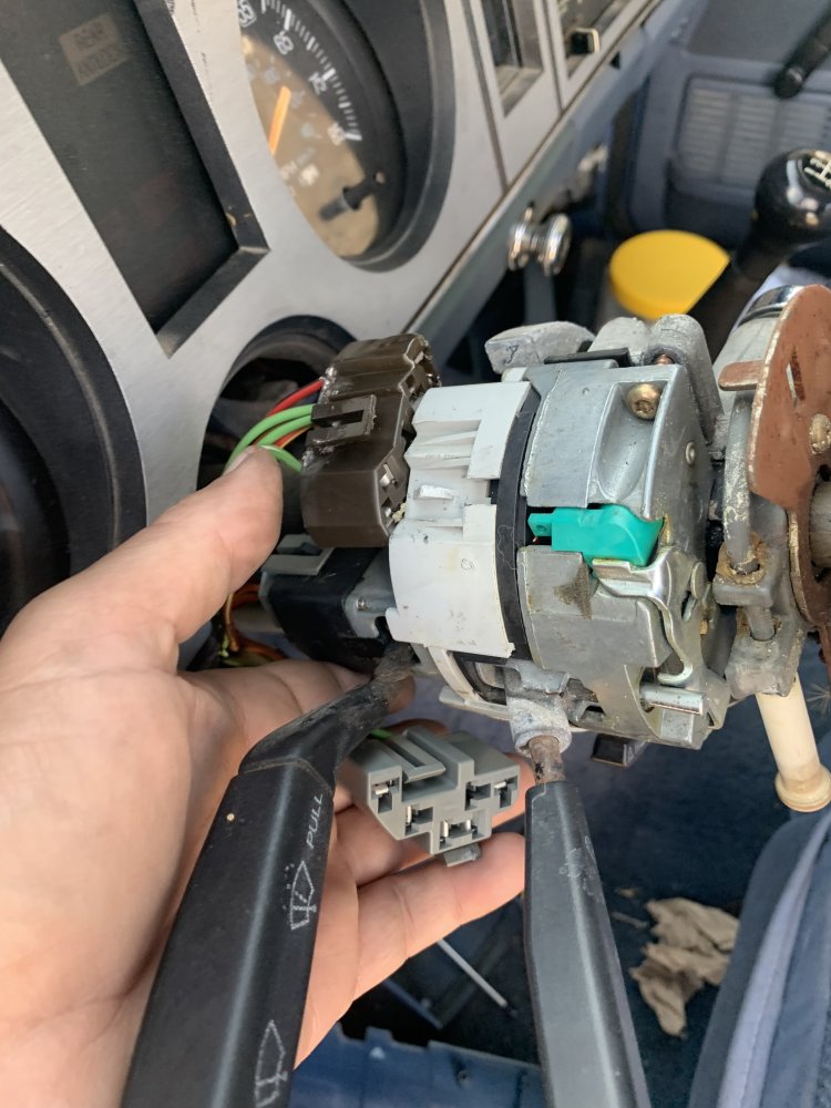

I need to replace this part. My dimmer switch likes to jam up. I’m looking for videos on how to replace it. May actually have to do it the old fashion way and look into a manual.

replacing that switch is probably not terribly hard. looks like a pull the guts out of the column from behind the steering wheel type of deal

Hello suoerj.. I was watching some videos and cannot find one on thses trucks. I dont think it will be like the full size trucks. They have to cut wires or un pin the harness, I sure hope I dont have to go down that road. I can and will do it if I need to but sure hoping it is just an easy fix. Fingers crossed.

To replace Signal Switch/Dimmer. Remove steering column cover and then gently remove foam dust cover and two plugs.
Then the two gold torx screws and it slides right out. Easy job except I cannot get my lever to release from old one. Otherwise a 10 minute job.

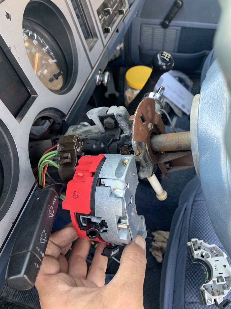

Two issues I am having. Getting the lever out to swap to new switch. I have tried penetrating oil and I am thinking a nail or paper clip to release lever from assembly. Not happening as of now.

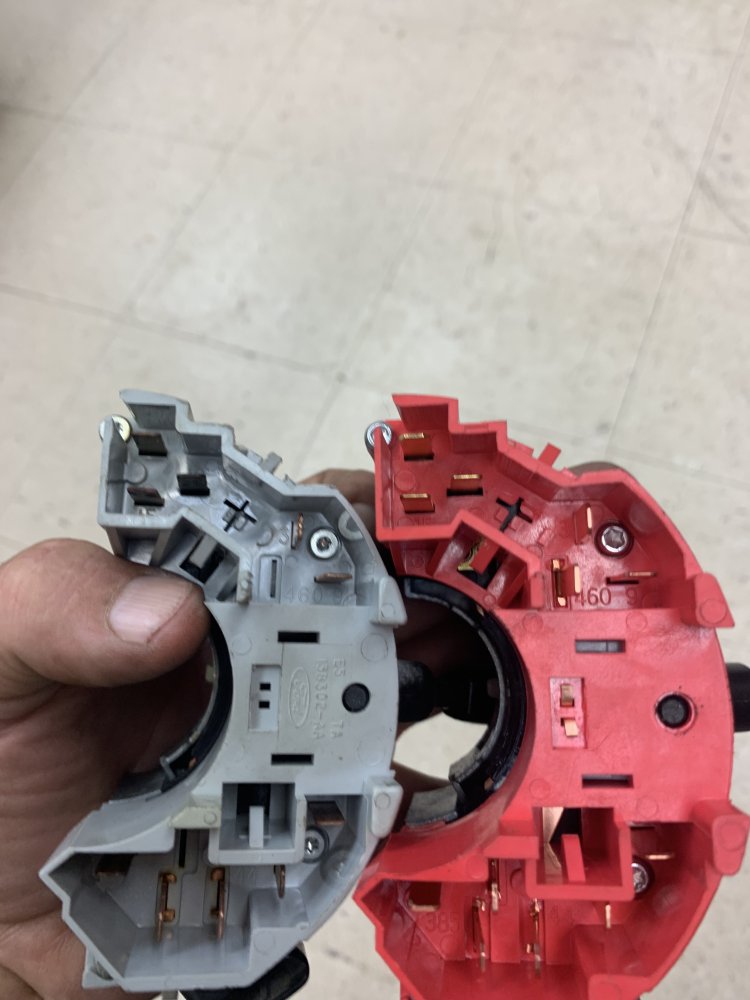

Other issue is my new red one has an extra electric tab on top and an extra on the bottom. I got this one from Rockauto. I will check my local Orielly tomorrow and see if they can get correct switch.
It may interchange but do want to risk it.

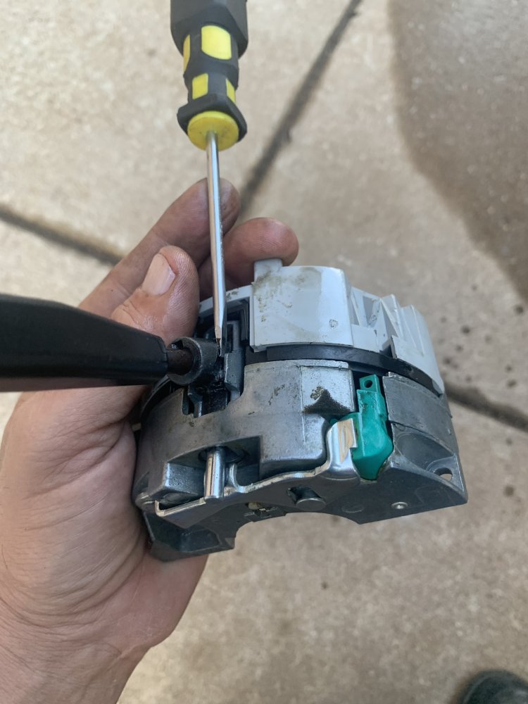

If this is a release pin, I am not having any luck moving it either way. Where my thumb is.
I think that that's the pivot pin (by your thumb) for the socket that holds the lever.
Try hitting the base of the lever in the socket with Wild Dog (WD-40), and let it sit overnight. Then GENTLY tap on the lever with a plastic head hammer, on the end and inwards, a few times (to help break loose the stuck retainer). Then get a grip and pull the lever straight outwards. It may need some "tough love" but don't go overboard.
At the tip of my screwdriver may be a release pin. It is not budging either. Could be rusted.
