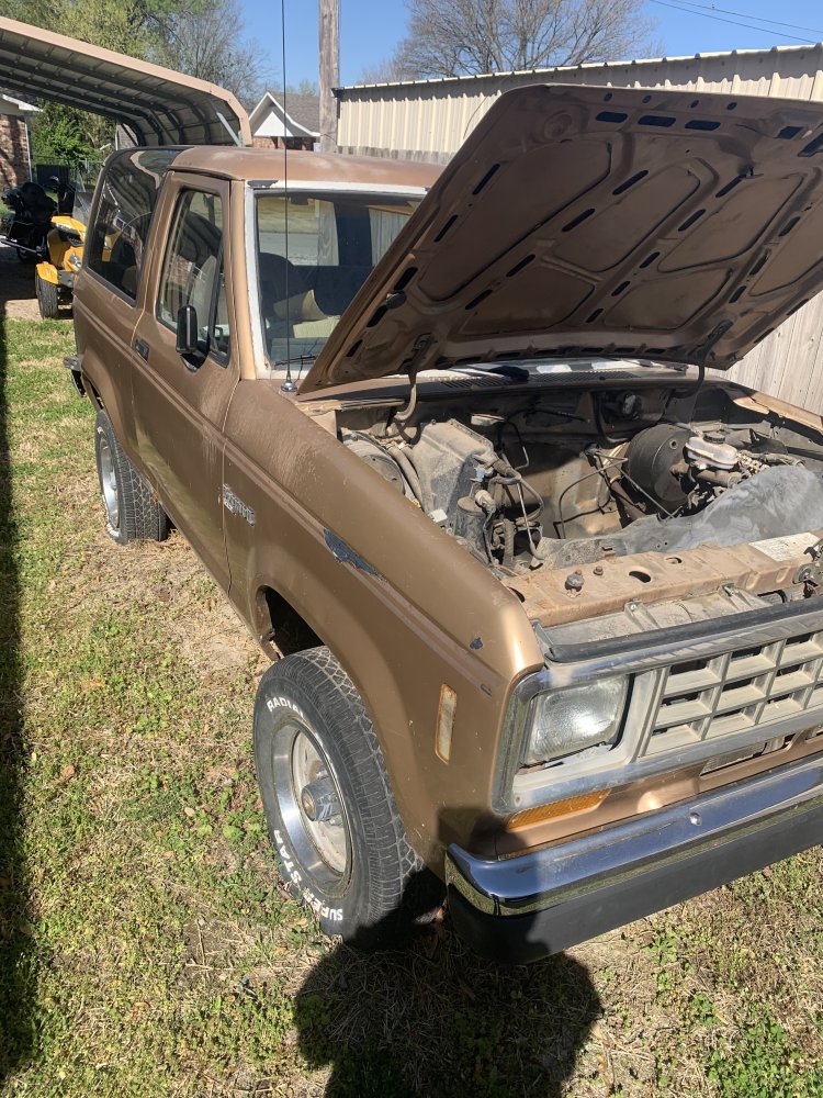

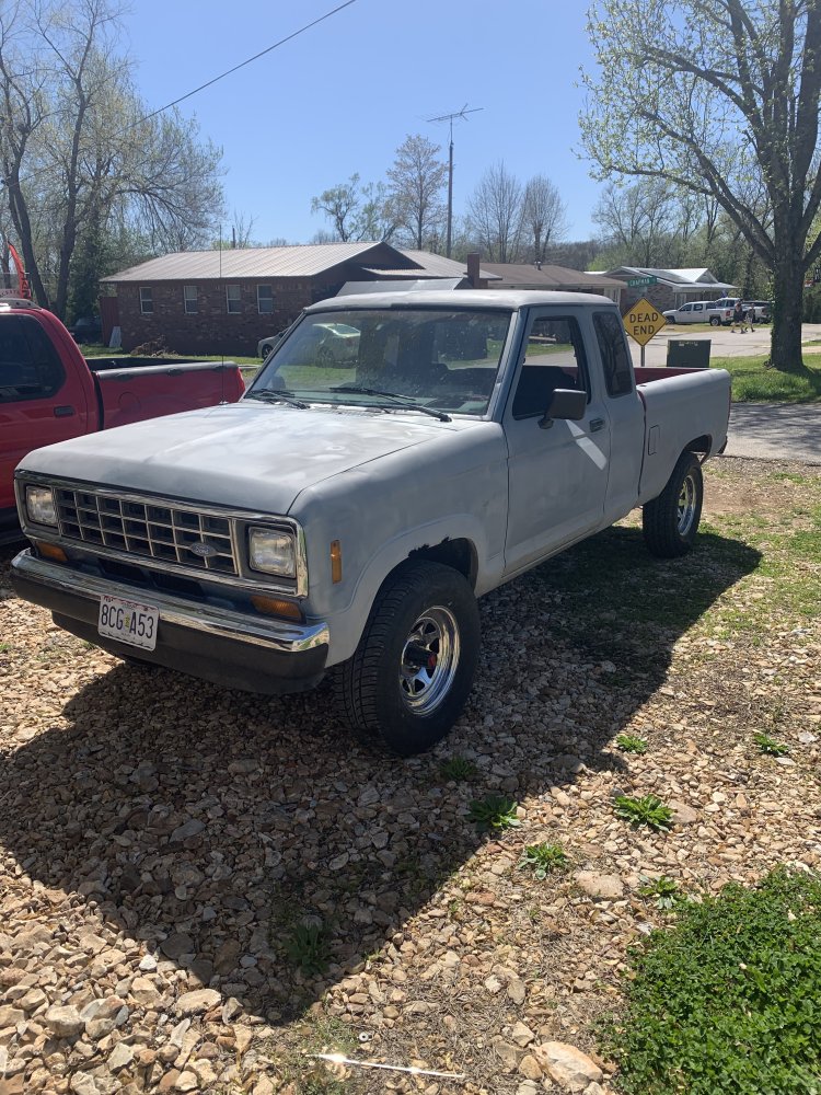

My 87 Ranger I will be restoring soon I want to keep track of my progress and add information as I find it.

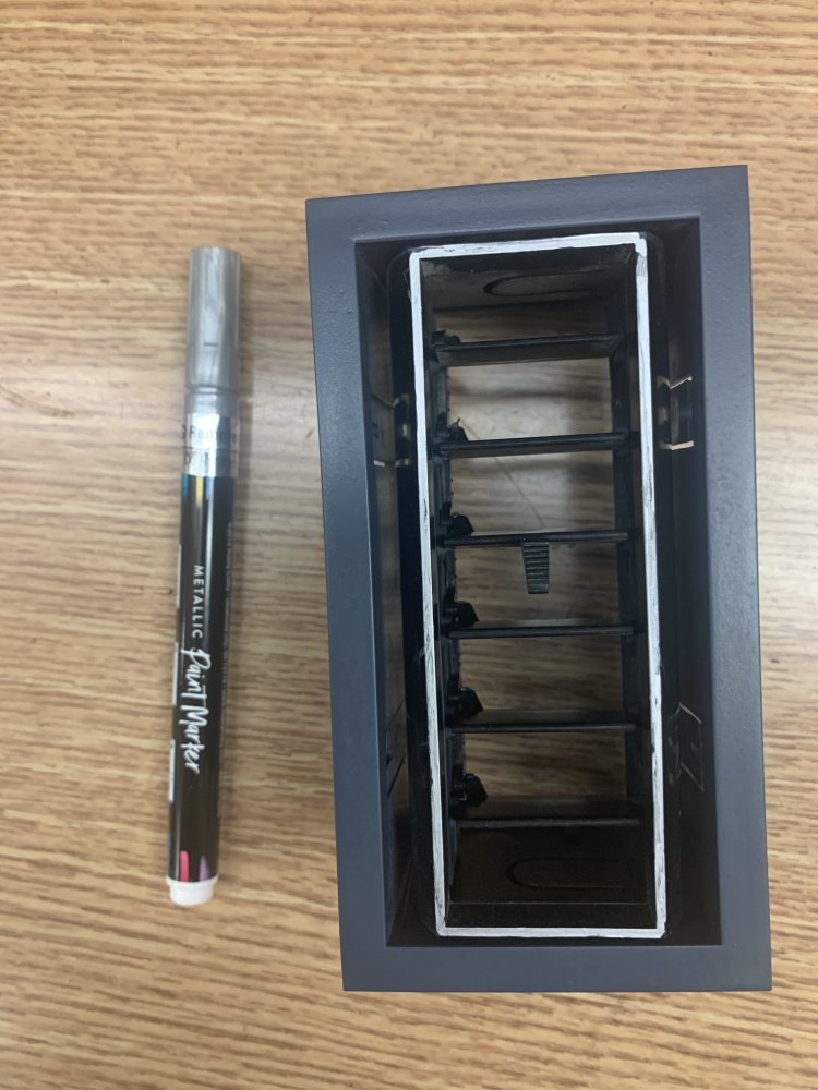

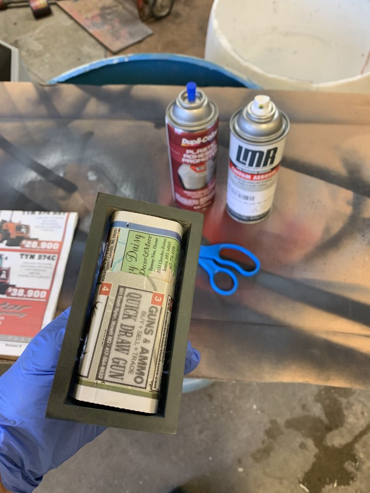

Hello JoshT.. This is a good one I just finished. I wrapped the front if the vent with two strips of newspaper and the squeezed it tight. I was able to spray between walls and vent real easy. No risk in breaking it. I got a Metallic Silver marker at Hobby Lobby.
Hello JoshT. I got my Silver marker from Hobby Lobby. Awsome-O found some chrome ones on Amazon.
I just posted on my thread with one vent done, and a way of not breaking them. Pictures got out of order but hope it shows a good way of doing it.
I saw your pics. The finish looks like the typical silver paint pen. Nothing wrong with that, but I'd like a more chrome like finish.
I was wondering how the ones that Awsome-O posted worked. I've seen the claimed finish of the chrome pens like he posted, but have always wondered if they lived up to those claims. Was hoping that he might share a pic for all our sake. This is the only chance I've had to ask about results that was a similar use case and likely to be real results.
You got a pic of the results? I've been trying to figure out a nice chrome marker to do the same when I start into the 85 Ranger.
There are some pics in my thread. I’ll try and get into the shop tomorrow and take some close ups. There is nothing out there that matches chrome perfectly as a paint except futurechrome painted products.
Ok, I'll pick this up in your thread. Will say I'm not expecting a morror chrome like finish, just want a better match for the factory trim than the silver paint pens I've used.
Hello JoshT.. That one is silver. I ordered Chrome that Awesome-O posted. It is supposed to be here tomorrow. I am looking forward to the results as I am getting ready to start on my trim.
Thanks Awsome-O...I got those markers on order. Will look so much better then silver and my trim needs some help.

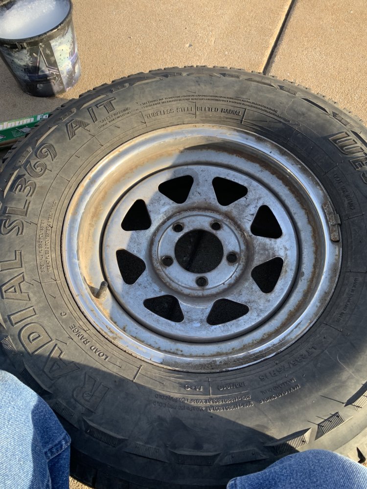

I did remove the rust from passenger front wheel. I need to remove drivers side and get around the lug nuts.
Here I am pinching the back of the paper and prepping for paint. I ordered a chrome marker pin from Amazon and hope it matches I bezel as well it has several scratches and just looks dirty.
Here they are done. My chrome marker should be at house tomorrow. Just need trim painted in chrome. Also will be staring on other trim as well.

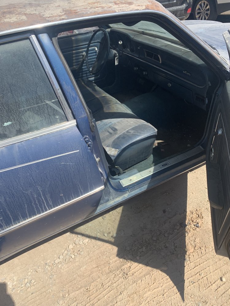

Im not a 4 door fan but this is 74 or newer by the bumper. It was at boneyard. I think they are going to sell it complete.
Even interior was in great shape for its age. Wish I could find other cars for its age and condition.

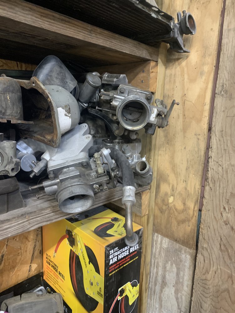

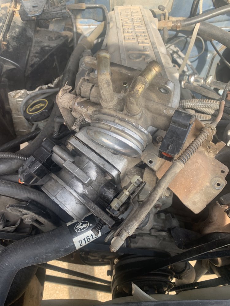

I have read that the 87 Throttle Body is larger. I have an 87 motor on an engine stand I need to put into my Bronco2.
86 measures 2.081 87 measures 2.364. After I get a new TPS sensor for it, I will try swapping and see if there is a difference. I have read that it is an upgrade.

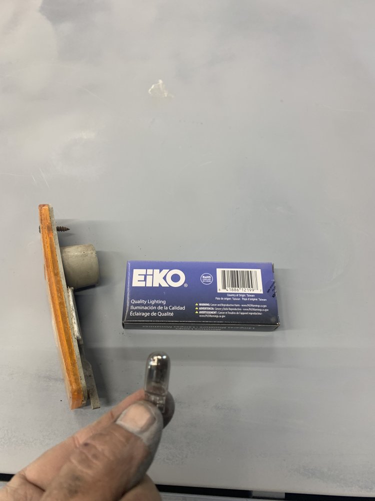

Something I wish I had known years ago. My side marker lights were burnt out. $7.99 for a 2 pack. If you ask for the 10 pack it was
$8.49. Go figure.
I was looking around and found I have two other Intakes. One is 87 and one is 88. I ordered a TPS for the spare 87 and see if it is an improvement.

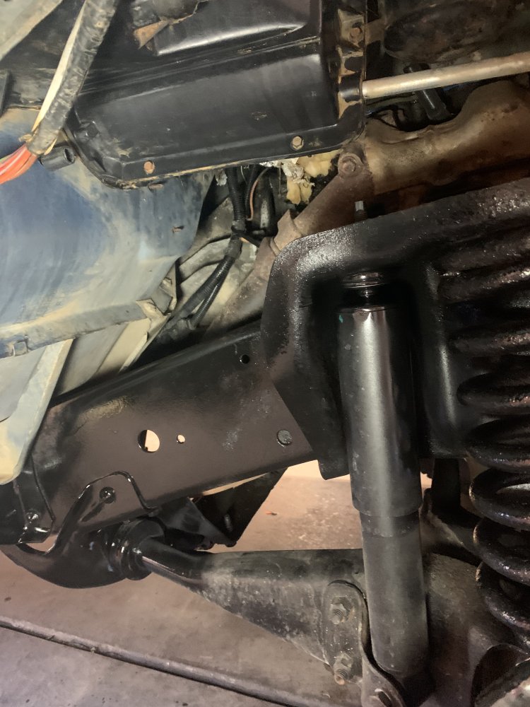

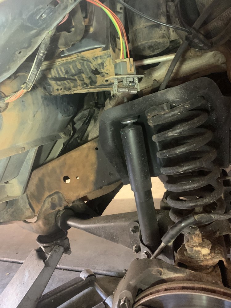

Yesterday I got my two front tires replaced and an alighnment. That also got the steering wheel in correct position. Basically 3 improvements done to the truck. It drives so much better with all new tires and alignment. My front end just needed a tie rod. So I am considering my steering and suspension system done. Wahoo!!! Did some more cleaning and painting of the frame.

I swapped an 87 Throttle Body in place of my 88 Throttle Body. Can’t really tell any big difference If anything it may helped on the
bottom end .

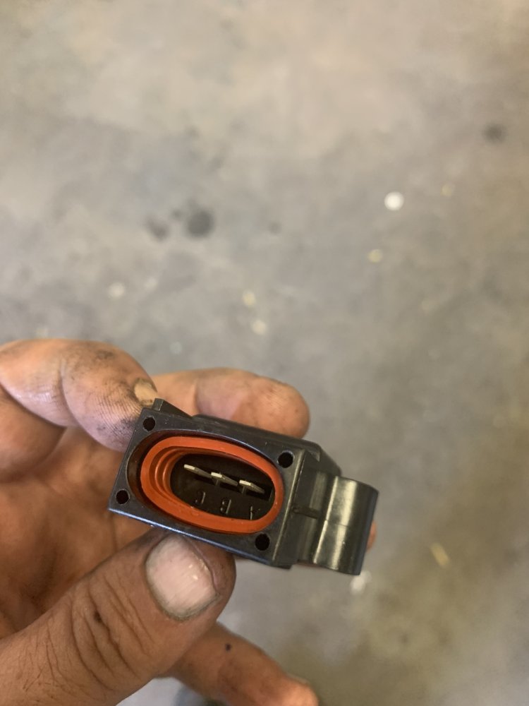

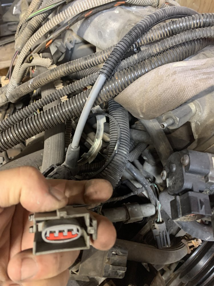

Ford used two different styles of TPS. This is the offset where my pointer finger is.
This has the center tab. At first, I did not know what parts guy was talking about when ordering the part.
