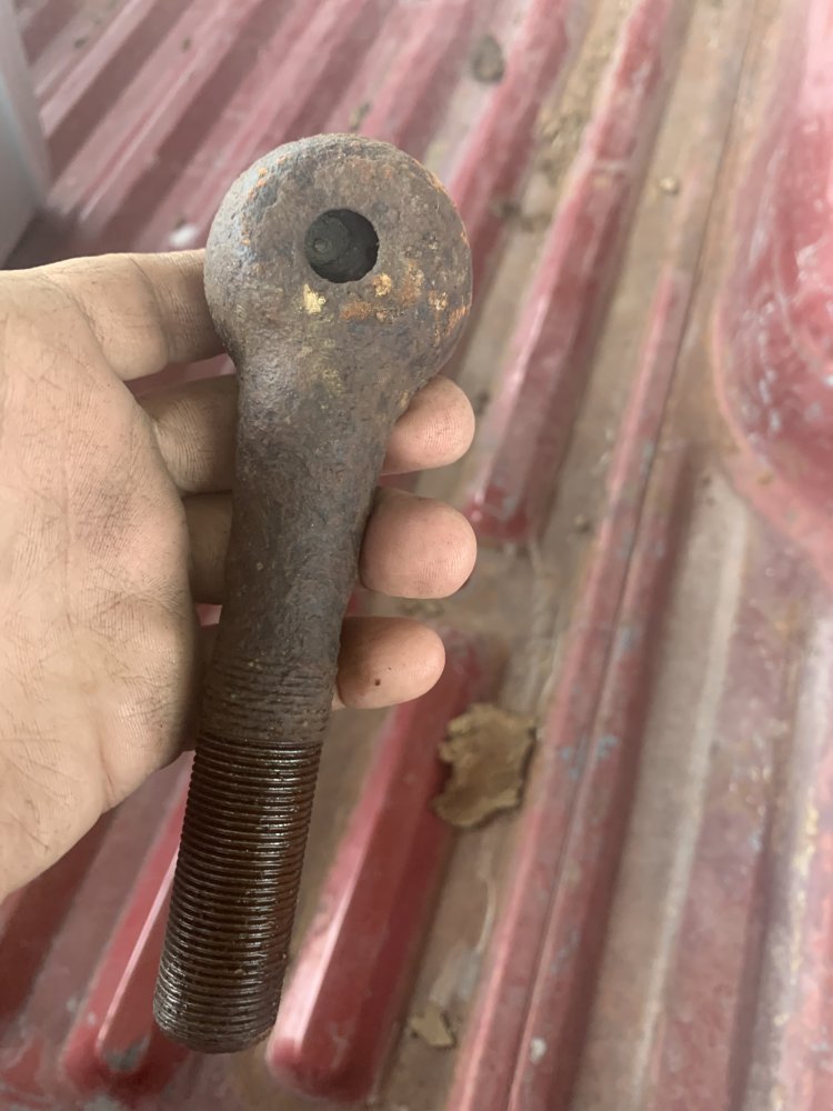

Actually, a bit of bad luck turned to good. I had an Alignment shop to check my front end. He said Passenger Side Tie Rod could break with one good bump. Scary. I eased home and changed Tie Rod. He said my Ball Joints and everything else does not need replacing. Actually everything else looks great as far as Suspension and Steering. Saturday I get two new front tires and Alighnment.

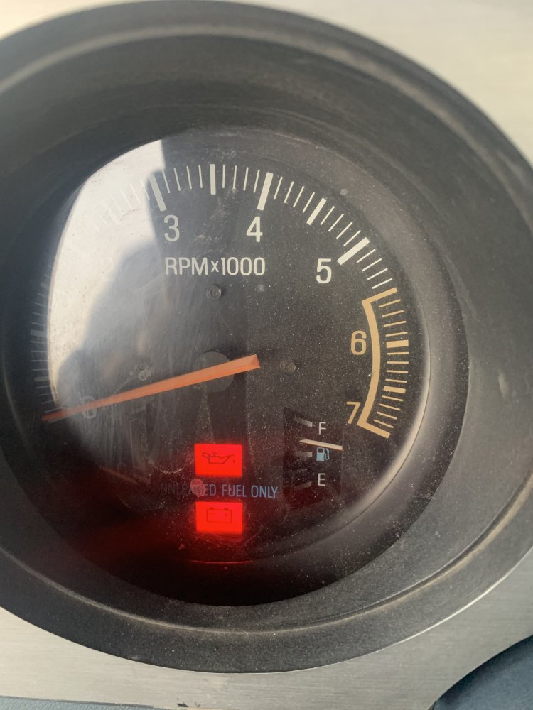

More good news. When I replaced my Fuel Pump Assembly,I tilted the bed. I’m guessing I jammed the float all the way up. Today I was on 1/4 tank. I wanted to see what 5 gallons of gas would do. I moved it to 3/4 tank. I am going to wait until I hit 1/2 tank and see if my gauge goes to Full.

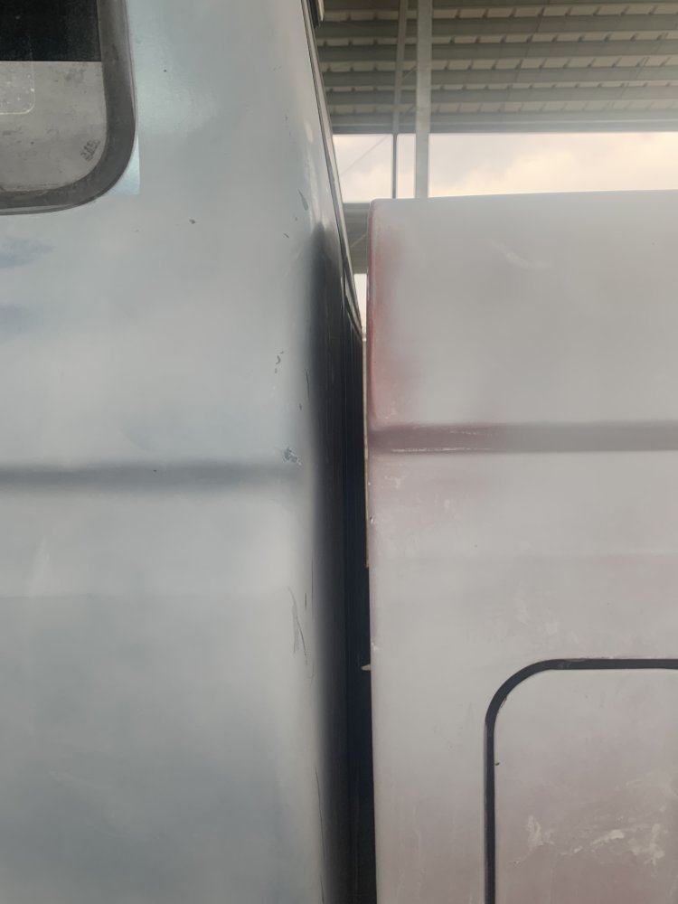

My bed is completely resting on the frame. I was under truck and seen Body Bushing are cracked. I plan on replacing them in hopes of a smoother ride and to make cab and bed lines even.
In long term I am hoping new Body Bushings will give me clearance to run 31 in tires.

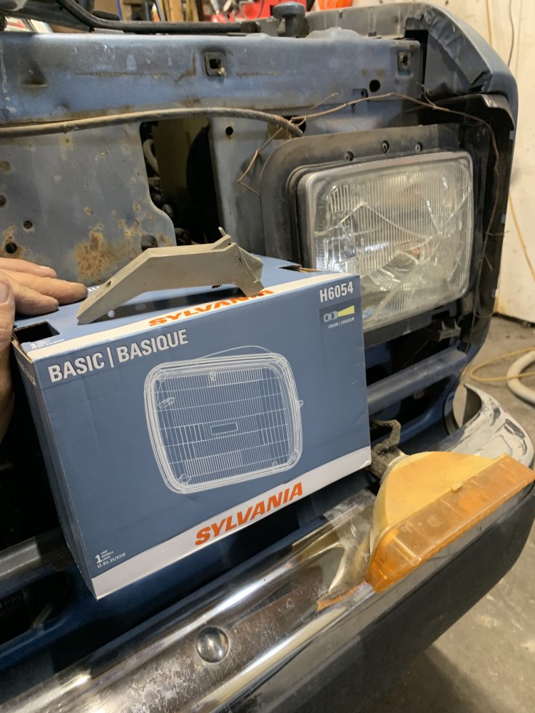

My cracked headlight finally gave up the ghost. Been cracked a while but still worked. While removing the grill, the plastic piece on the headlight box is broke on both sides. Previous Owner did not know you have to remove blinkers to get access to lower mount. Not sure if Gorilla Glue or 2 part epoxy is the better way to fix. Also missing to bezel screws so will be going to bone yard soon. Add that to the list.
