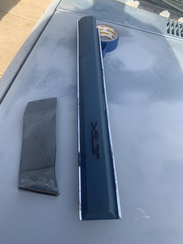

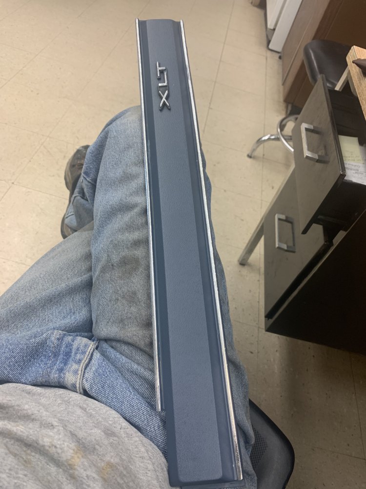

Here I scuffed the chrome finish with wet 1500 grit sand paper to give chrome marker something to bite into.
My 87 Ranger I will be restoring soon   I want to keep track of my progress and add information as I find it.
After masking and painting, I used small circles to fill in the chrome strips.

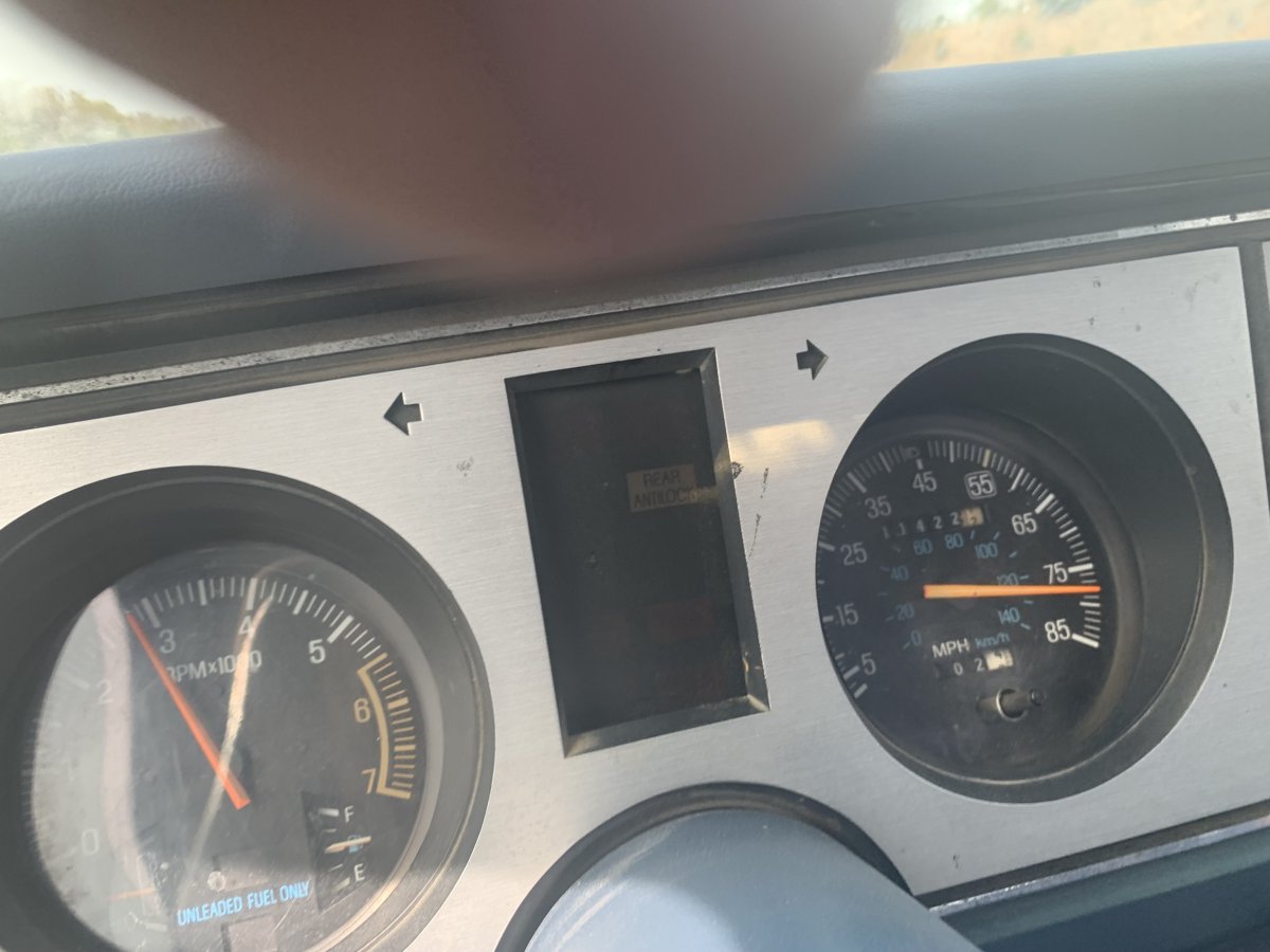

May not seem much but until I got all the front-end work done this was only a 60-mph truck. This truck has come a long ways. Fastest I have had truck and ran so smooth. Wind noise gone due to new window seals. Gas gauge works now but still needs a little tweaking but it is getting there.

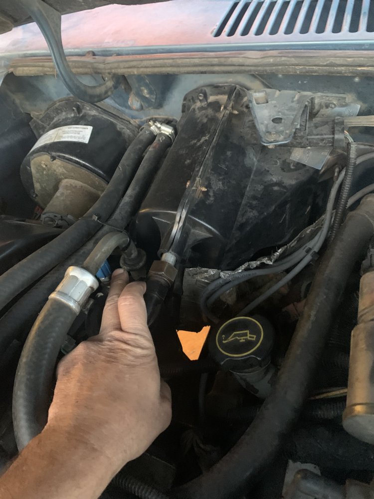

Worked on my AC this weekend. It would not operate. Cleaned some contacts, added some R134 and got compressor working. Still not blowing cold. Talked to a shop and after I swap evaporator and dryer, he will get my system going for me.
Sounds like a good improvement. I was there not too long ago with the F-100, but I think it is sorted now. I've taken it up the interstate keeping pace with traffic, but that was a couple of years ago.
My first gen was a 2wd, but I don't remember a time when anything limited it's speed. Don't know what the top speed was, that 2.8 would bury the speedo in third. I had the tickets to prove it too. I might have been better off if it was a 60 MPH truck.
When I know I am getting into another area, I try presoaking all nuts and bolts ahead of time. AC is probably a couple of weeks away, but I will keep soaking them. Doing same thing with my Body Mounts.
If you were local I'd try to help you out with this, we just finished up redoing the system on my 99 and it works good.
First check to make sure your system is setup for R-134, I don't know of these used that or still on R12. I'd convert to R134 if it isn;t given the scarcity of R12. You'd have to look up what needs to be done to convert, all of mine with AC were already 134.
Given age of the system and not knowing how long it hasn;t worked, you'll definitely want to replace the dryer. I'd recommedn making the new dryer be the last new piece you install and install it right before you get ready to close the system up and take for servicing. It contains a dessicant pack and it will draw in moisture from the air the entire time it is open and exposed. If dessicant gets spent (soaked/saturated) the dryer is no good.
If it were me I'd replace everything else in the system that needed to be replaced and reinstall the old dryer. Then the day or morning before you take in for AC service open and install the new dryer. We did the service ourselves, the system was only opened for minutes after the dryer was installed and was at full vacuum shortly after that.
I'm assuming that your leak was determined to be the evaporator? If not I wouldn't change it unless you are starting fresh with everything.
Again given age of system and that you might be converting refridgerants, I'd replace all o-rings in the system. Old o-rings are liable to be a source of leaks now or develop them shortly after the system gets charged. Also if an old R12 system, they may not be compatible with R134 causing them to break down and leak later.
While replacing the o-rings change your orifice tube. It also acts as a system filter. Replacing it will remove a potential restriction, and give a clue as to condition of the system. If therr is black gritty stuff on the filter show it to your AC shop guy and figure on replacing the compessor and condenser (in front of radiator) as well. That is typically a sign of a failed compressor and the stuff gets into the condenser and near impossible to clean out.
Back in 2009 when I got a 95 probe on the cheap, the ac system was dead. Compressor shot. We did a full replacement (compressor, condenser, evaporator, dryer, and orifice tube) of that system at home and it worked great for the short time I had it. Last I saw of the car was 2 (?) years ago when I got the opportunity to buy it back, one of the few selling points listed was that the AC worked excellent. Seller didn't know I was a previous owner.

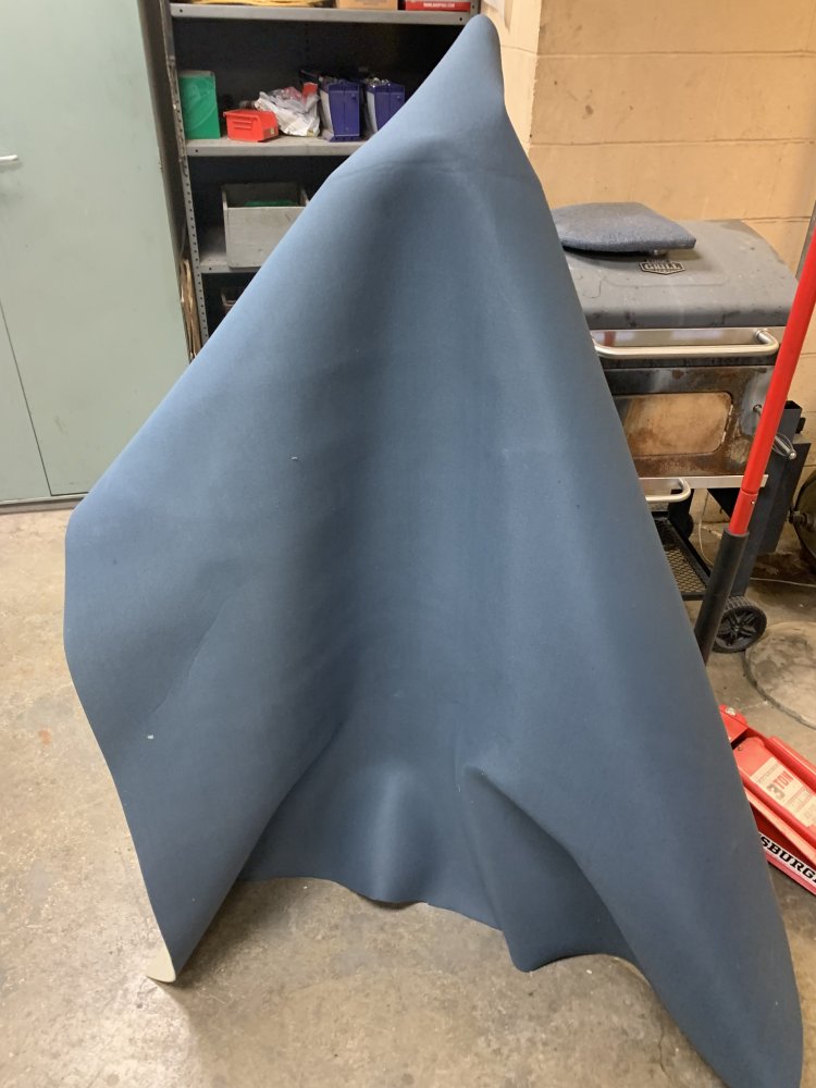

I picked up some headliner material from a local mom and pop shop. Hope to get it installed this weekend but not sure. I am going on a 2 1/2 drive to get some wheels I found on Marketplace.
Somehow, I just noticed the rake it has. Body Mount Bushings are on the list. Now I think Coil Springs are going on the list. Could be one if the last things I do. I can live with the rake for now.
If you've never done a headliner, check out some of the pointers that @jballard81 got in his recent thread.

I will check out jballard 81 headliner tips. Never done a head liner but have watched a ton of videos. I want this truck to look as new as I can possibly make it . I have taken some junk trucks and they turned out really well. Just stockish but that is all I am after and maybe a little upgrade.

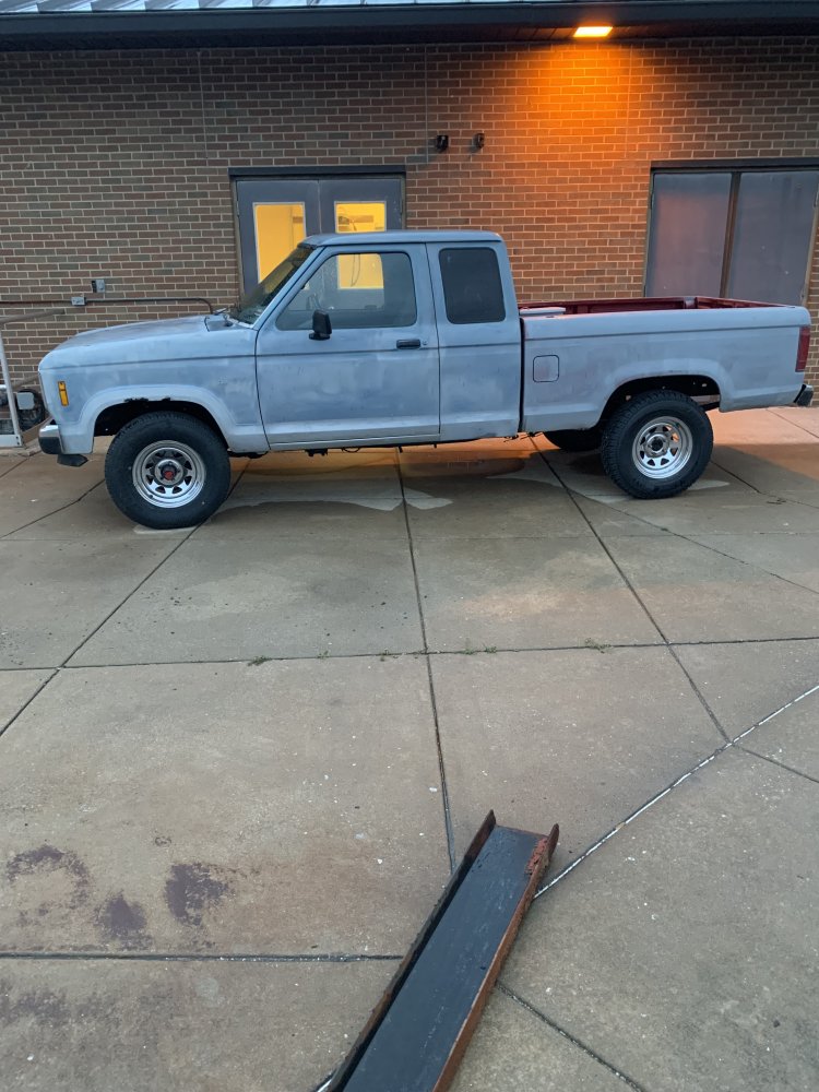

Today I had the bed pulled off. The gas tank seal between tank and fuel pump assembly would let a little fuel out with a full tank sloshing around. While I had the bed off I fixed the seal. While at it I went and filled the tank. I had to bend the float rod down a little bit as the gauge would only read 3/4 tank. Now it reads full. I think I have that problem fixed. With all the driving I did, I am now at 3/4 tank which is about where I should be. Currently I am getting 18-21 miles to the gallon depending on how fast I drive and if it is on interstate or back roads.
I wanted to leave bed off so I could do body filler on the back of the cab corners but that will have to wait until another day. Saturday, truck is going on a 2 1/2-hour drive to get the factory aluminum wheels that I found on marketplace thru a Ranger/Bronco page. I really think truck will make the drive .

Good looking dog! If you've watched videos on the headliner job you're probably already better prepared than me :icon_rofl:
Some tips you may already know, but just in case:
-the plastic trim and (especially the large b-pillar) is old and brittle. I only mangled the top plastic tress out when I did mine and tried to bend it out of the way. It cracked. Badly. Either roll the dice like me or be prepared to remove the seatbelt and that whole panel.
-if you do remove that big panel, probably want to pull the seat out. The seat was in my way getting the headliner back in
-mark and cut your holes before putting it back in. Don't be like me 😂 I had to chase it around to find all the holes. Pretty dumb.
Thanks Jballard81... I feel really confident about getting the head liner installed. I am waiting to get carpet as it will take about all the panels out to get either one. Once I get the carpet, I plan o n taking a day or two to strip interior out and do both. I know it is going to be a work out. Not really looking forward to it but when done, my interior should really look as close to new as I can possibly make it.
