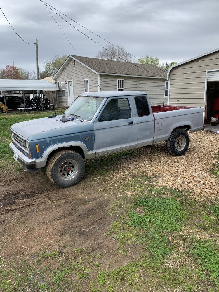

My 87 Ranger I will be restoring soon I want to keep track of my progress and add information as I find it.

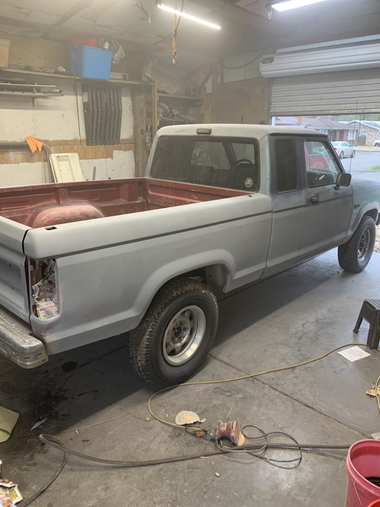

Here I primed it.
Then wet sanded it.

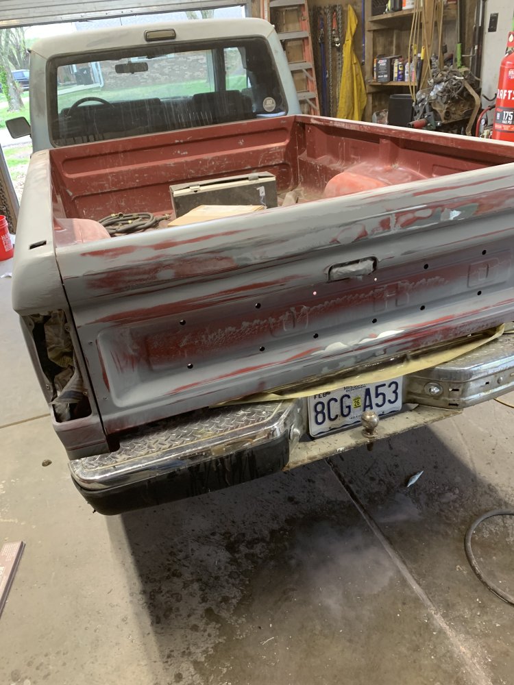

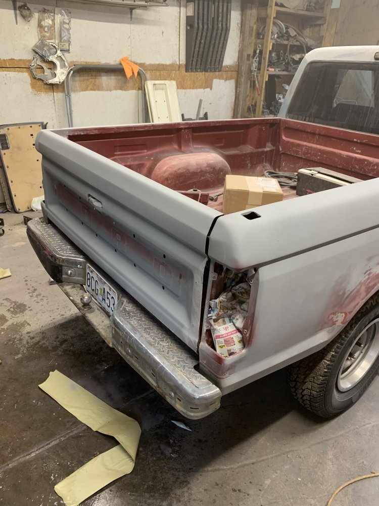

Then primed it again. I have two small imperfections that glazing putty will take care of. I need to remove bumper to get bottom of tailgate and get the rest of the factory striping off. A lot smoother then it was.

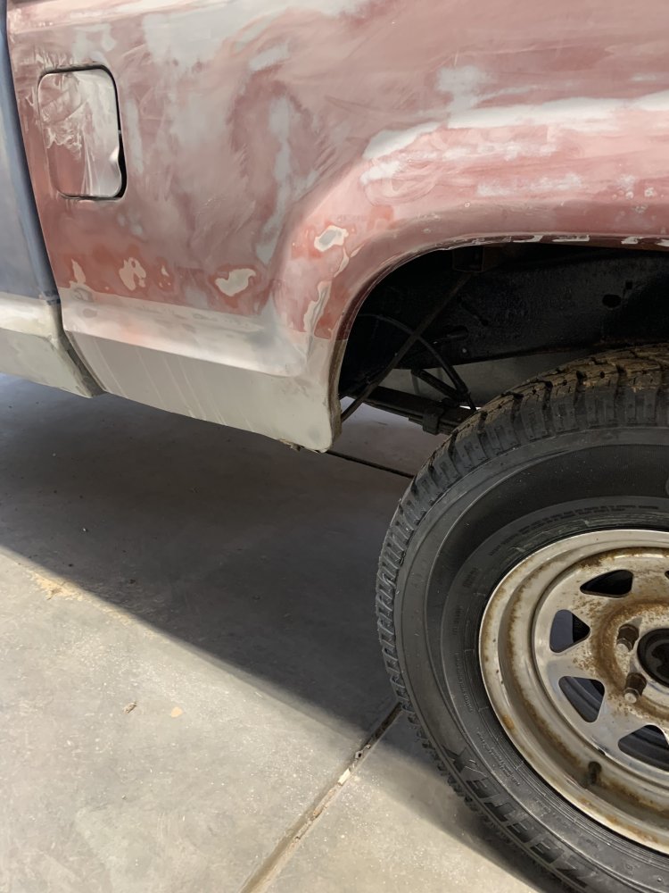

I am going to find a body shop. You may not be able to tell but in front and behind the tire is some damage that I just can’t get back to perfect.
I want to get the truck all in primer as soon as possible. Maybe I wont look like a crackheads truck and all in one color. I bought some Dollar General masking tape and it has been nothing but a pain in the rear as it just keeps ripping coming off of the roll. Letting shop air out and see if I can get some more done while I still have some time today. A step closer.

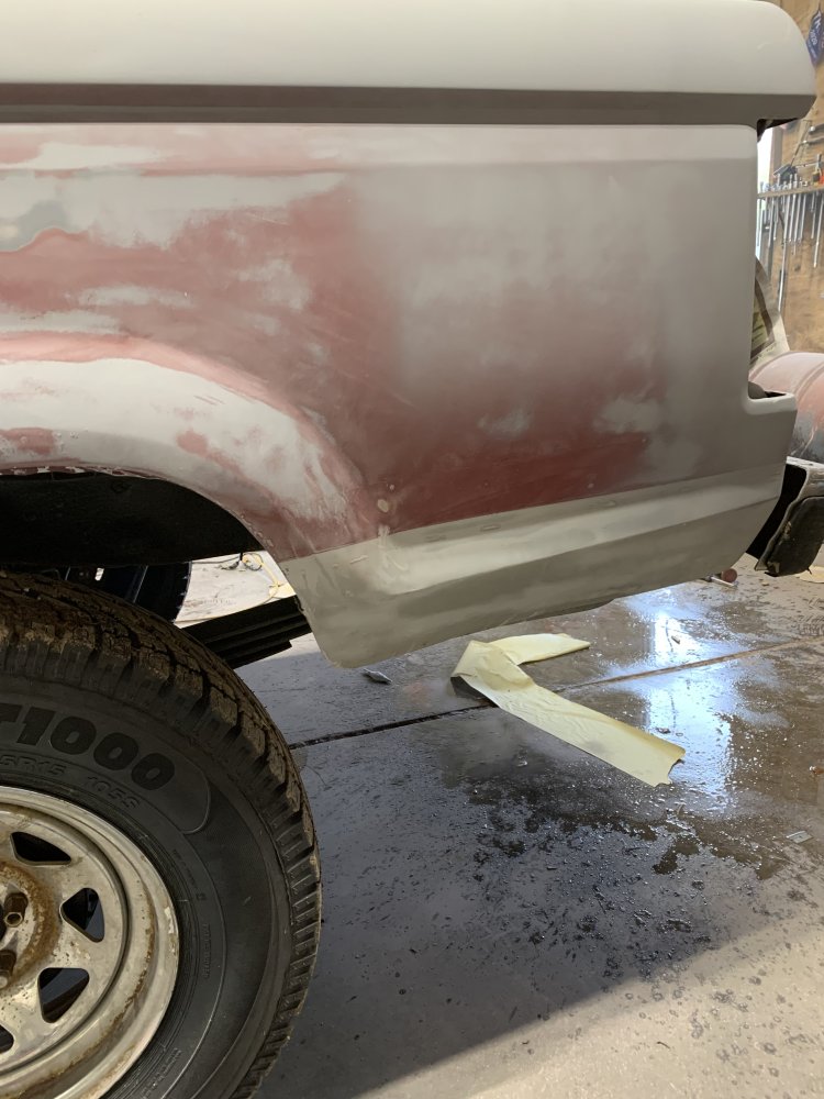

Truck looks better already. Now I need to go get some news paper and masking tape to get cab done. Masking is my least favorite. There is still tons more sanding to do. Just wish I could afford fenders this week but not happening. I got to get the front end rebuilt

I got some more done. I figure 2 more long days of sanding and it will be ready for paint. Painting is still a ways off due to cost and I will take some days off from work when I paint it. I will strip it down to paint.

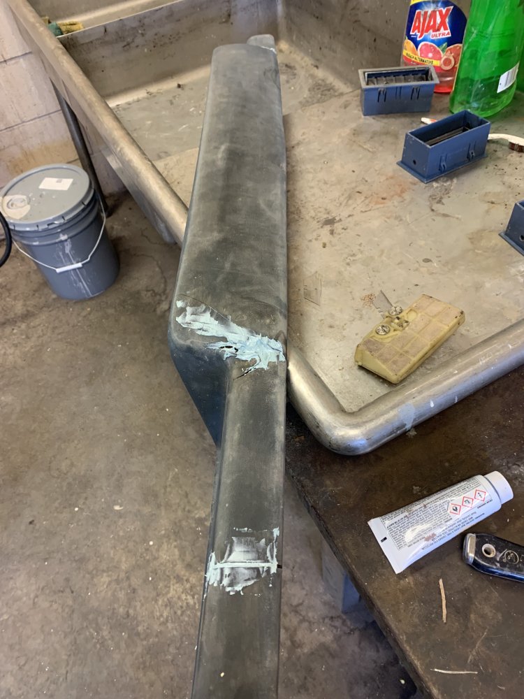

I did quite bit of work on the dash pad. It is drying now. I did run out of LMR paint but it does look better now The metal plate was primed and satin black to prevent glare
Do you mind sharing what you used to fill in the cracks/tears on your dash pad here? I've had zero luck finding anything better at the JY and have been thinking about attempting something like this on mine...

Hello jballard81.. I use kitty hair fiberglass to fill in the cracks and then I just use interior paint from LMR. Earlier in this thread, I started on my original dash pad. I tried using Marine Grade Vinyl. It would work for a flatter dash but is difficult when trying to do contours. Eventually I am going to get back on getting the dash covered. I have read about a 4 way stretchable vinyl but have not got my hands on any of it yet. I want my dash in perfect shape when truck is done. Filling the cracks in with fiberglass definitely helps with overall look but is not the best solution. I will eventually get back on learning what to use for re coveringthe dash.

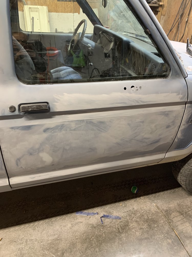

I long blocking and where I had to weld in previous owners hack job for mirrors and big dish dent on passenger door I am really happy.

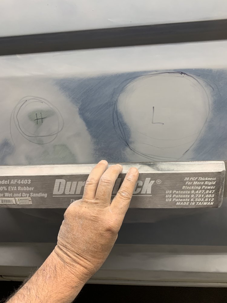

On the other side, not so much. The High spot should work itself out. The Low spot I could not see it and barely feel it but it will show in new paint. All manual labor sanding and I’m feeling my age. Have not done this in a few years. I’m just doing the flat areas and still have curves to do. One step closer though.
