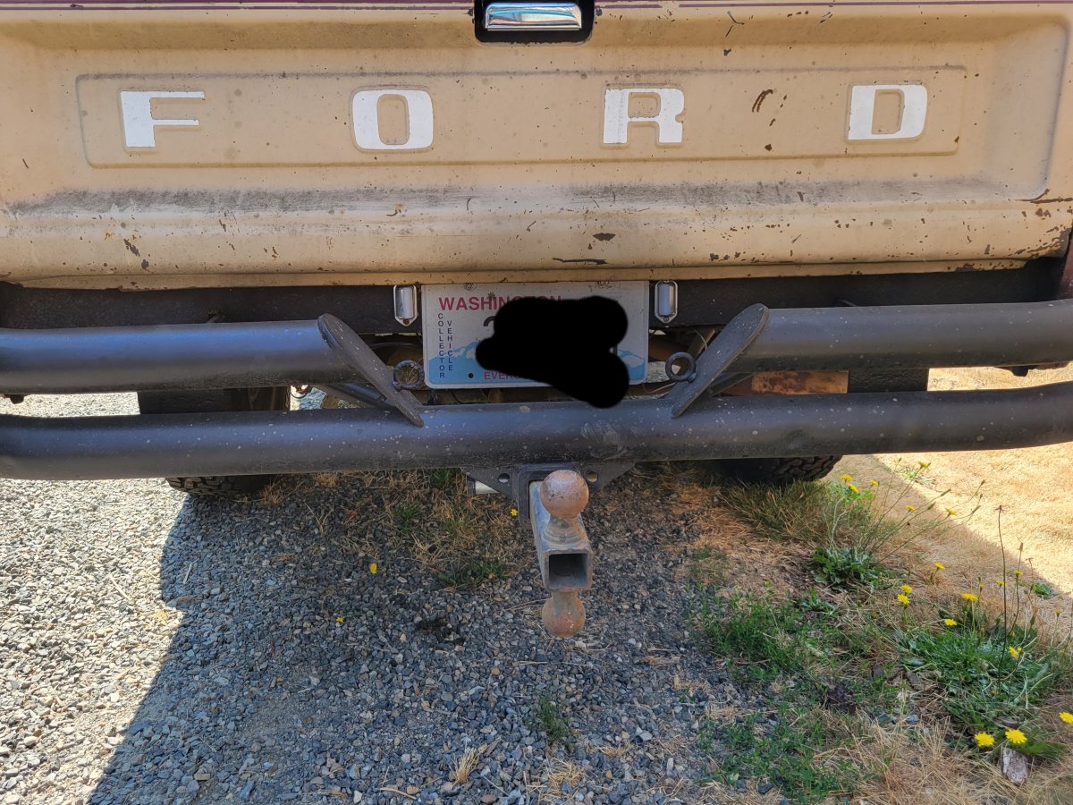

Here is the pic of the rear bumper, and how I delt with the license plate.

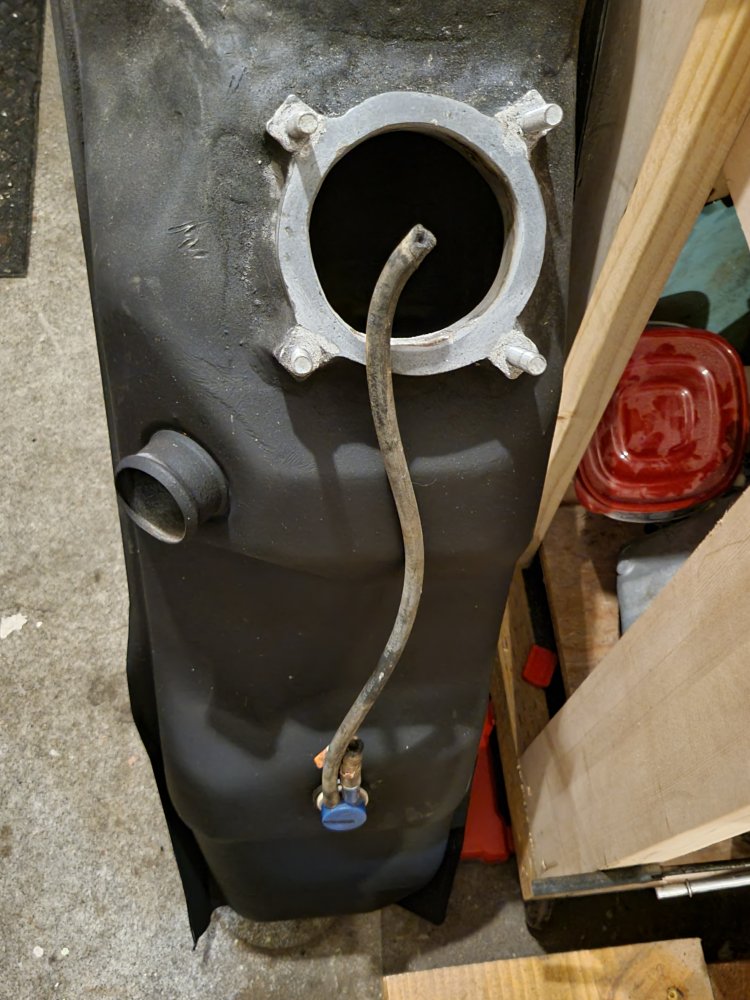

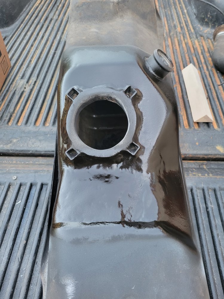

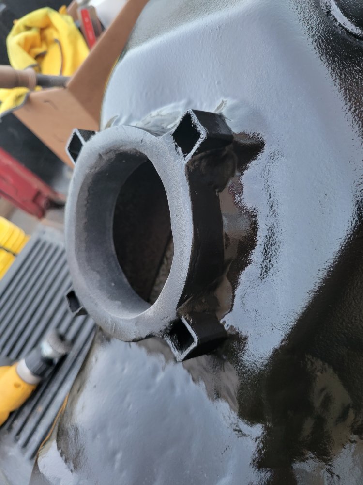

I had been going back and forth with myself on what to do about the fule tank. I finally decided to use the 83 tank and modify it to install a fule pump and sending unit for a 4.0. The sender assembly was 1.25 inches longer than the 83 sender, so I based my design on some 1.25/.25 flat stock. I bend the first one into a circle the same outer diameter, as the new sender, than bent another smaller that was just big enough for the little locating tabs on the underside of the sender, about 3/4 of an inch between the two rings. Than I welded them to a piece of 1/8 inch sheet, I cut out the center, than welded some half inch square stock in 4 locations around the perimeter, these will house the mounting bolts. I then cut out a badly rusted section of the tank and welded in a patch panel, than I welded my custom adaptor flange to the tank about where the stock sender sat. My welds wernt perfect and I had a few leaky pin holes so I then went over the patch panel, and all the way around the flange sealing it with jb weld. I then cleaned up a few inches around rust converted, primed, and under coated the tank and new flange, at this point I still need to refinish the rest of the tank, flat sand the seal seat of the flange and install the bolts. First pic shower the 83 sending unit next to the 4.0 sender

Your weld doesn't look bad, just need to work on getting a consistent travel speed to get a more even bead

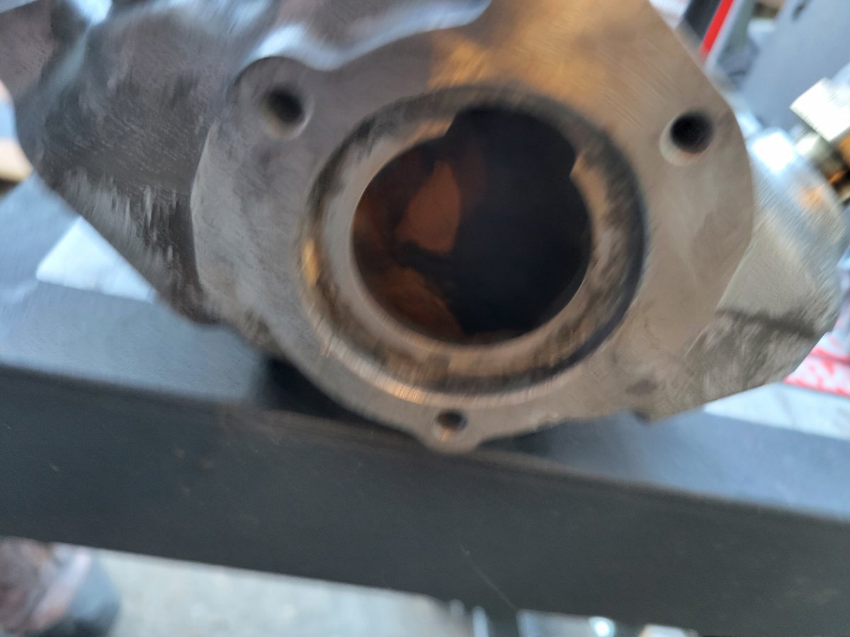

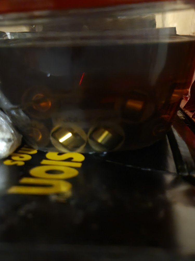

Well I droped the block off at the machine shop today. He told me it would be 8-12 weeks, wow that's a wait time. This weekend I finnished the mounting flange for the gas tank, and today I started cleaning some parts. Even got paint on the oil pan. I've got 10 out of 12 new melling lifters sitting in oil, hopefully I'll get the other 2 this week. The national
shortage of engine parts is making it hard to get them, on top of that oreilys keeps partial filling my orders with sealed power brand, that are used returns, or have seized internals, so I refuse them, and get them to order more. So far I've got all the lifters from Washington, Denver, and Sacramento, slim pickings out there. Thanks covid.

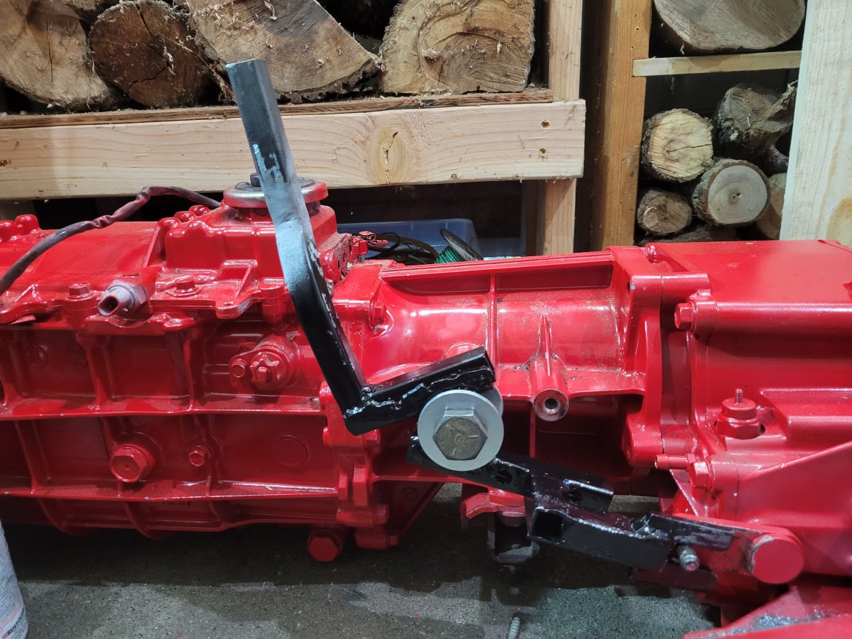

Well I've gotten the trans and transfercase cleaned and painted. During the process I started trying to find a transfercase shifter. Turns out the early transfercases, like mine from 83 have a diferent shift arm than all the others, and no stock shifter will mount and work with an m50d. Si I ended up fabricating my own. Still needs some work to get the shifter just right, however that will be easier once in the truck can only guess so much while on the ground.
Great job so far. I commend you for taking on such a project as such...
