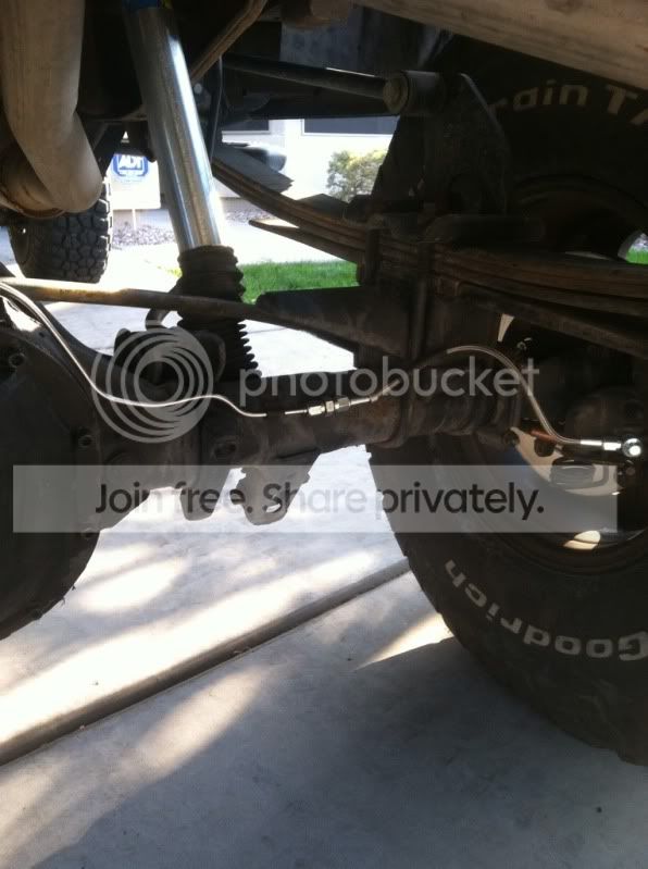

And the 8.8 28 spline rear Disc Brake swap:

Looks very nice man. Clean swap, and the disc swap looks perfectly done.
How is the rear bias using the F250 M/C?
