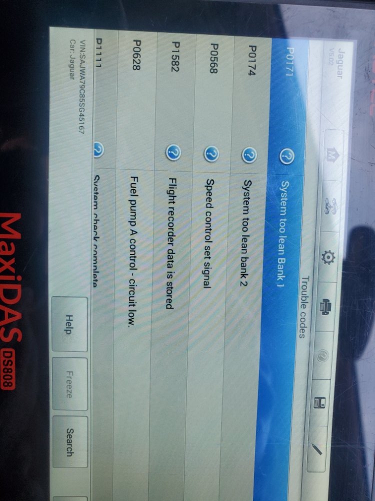

JaaaaaaaaaaaaagI haven't scanned the codes yet, buy the seller sent me a pic of the codes he got:
I've been trying to search online for possible solutions.
P0628 - Fuel pump A control circuit low. Sounds like this could be a poor ground, corroded connection, bad relay, or bad fuel pump.
P0171 - System too lean bank one.
P0174 - System too lean bank two.
From what I've been reading, having both of those codes at the same time can be air leaking at the intake / filter, leaking breather hose, or vacuum leak.
