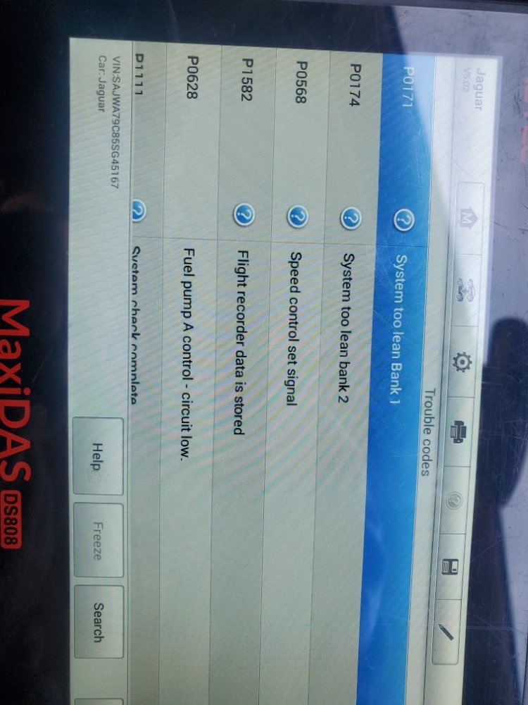

I haven't scanned the codes yet, buy the seller sent me a pic of the codes he got:
70959
I've been trying to search online for possible solutions.
P0628 - Fuel pump A control circuit low. Sounds like this could be a poor ground, corroded connection, bad relay, or bad fuel pump.
P0171 - System too lean bank one.
P0174 - System too lean bank two.
From what I've been reading, having both of those codes at the same time can be air leaking at the intake / filter, leaking breather hose, or vacuum leak.
If you are not getting enough power to the fuel pump do to a bad ground or broken wire this could cause you to run lean, hence the readings from the 02 sensors.
Agreed. Fuel issue may be the source of the lean codes so sort that first.

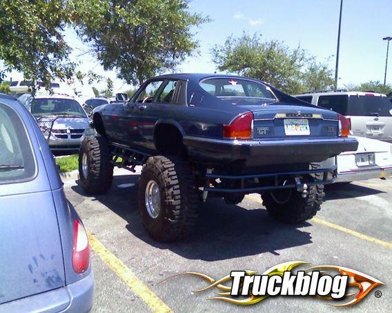

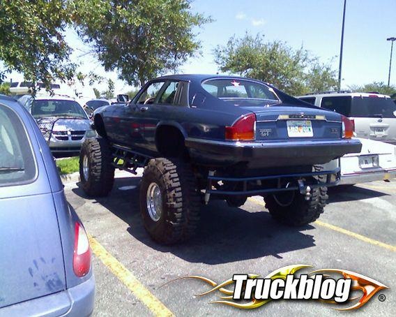

I could wheel that.
20-something years ago we took my ‘87 Escort 4 door down a dirt trail with a jet-ski sticking out of the hatch... this is classy compared to some of the stuff I’ve had offroad.
