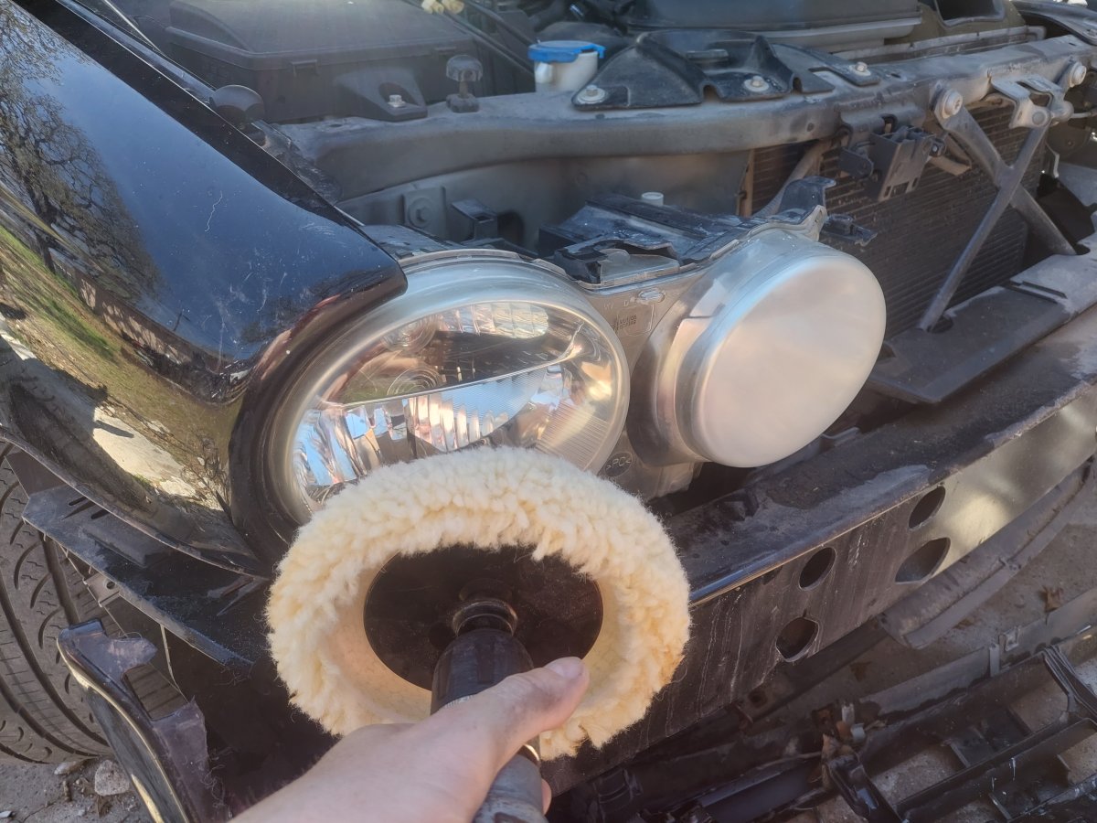

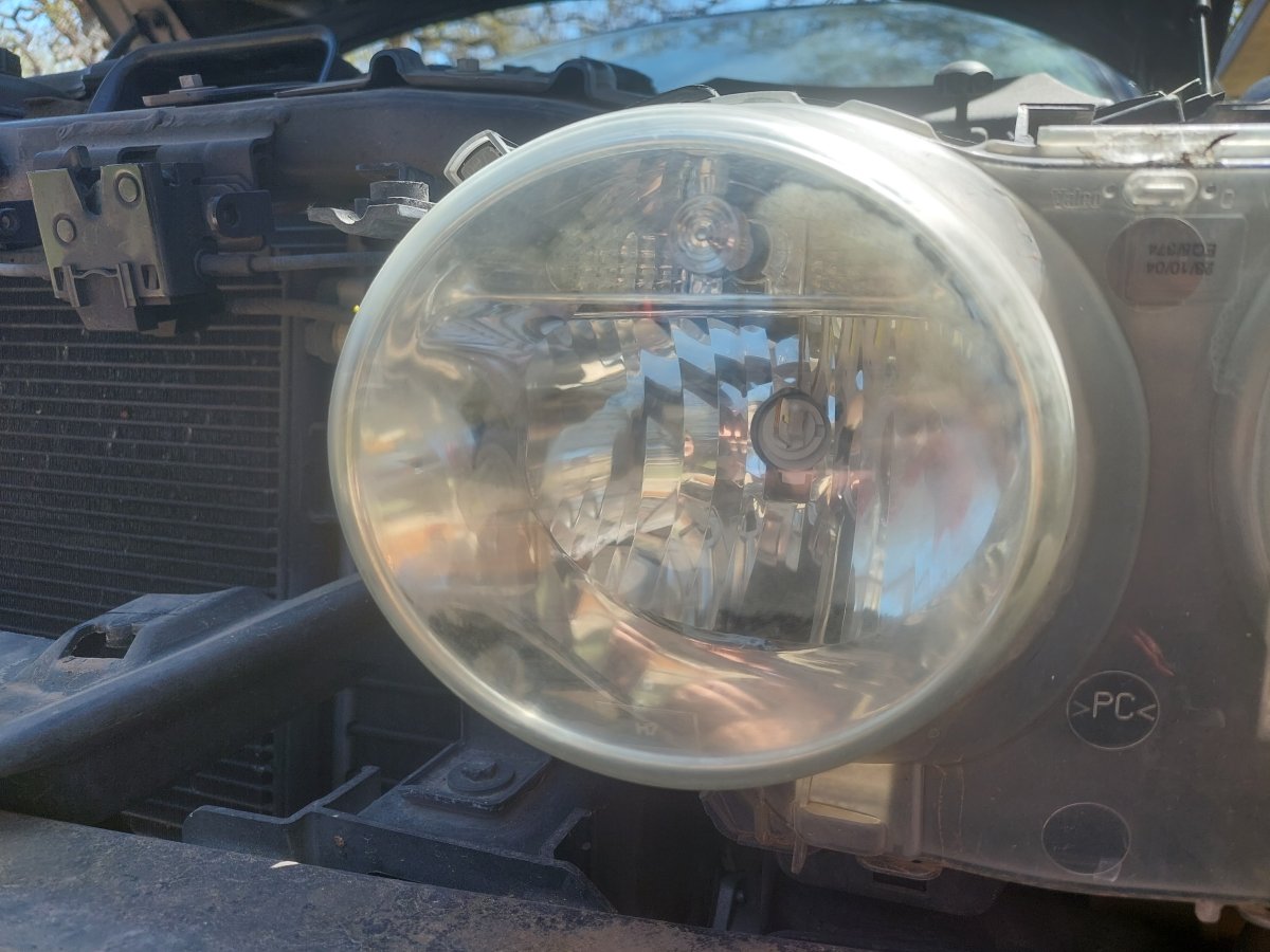

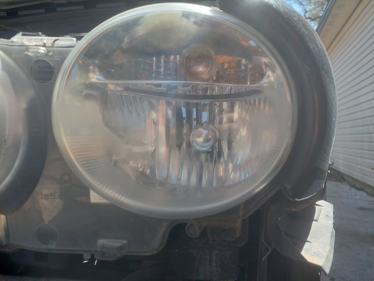

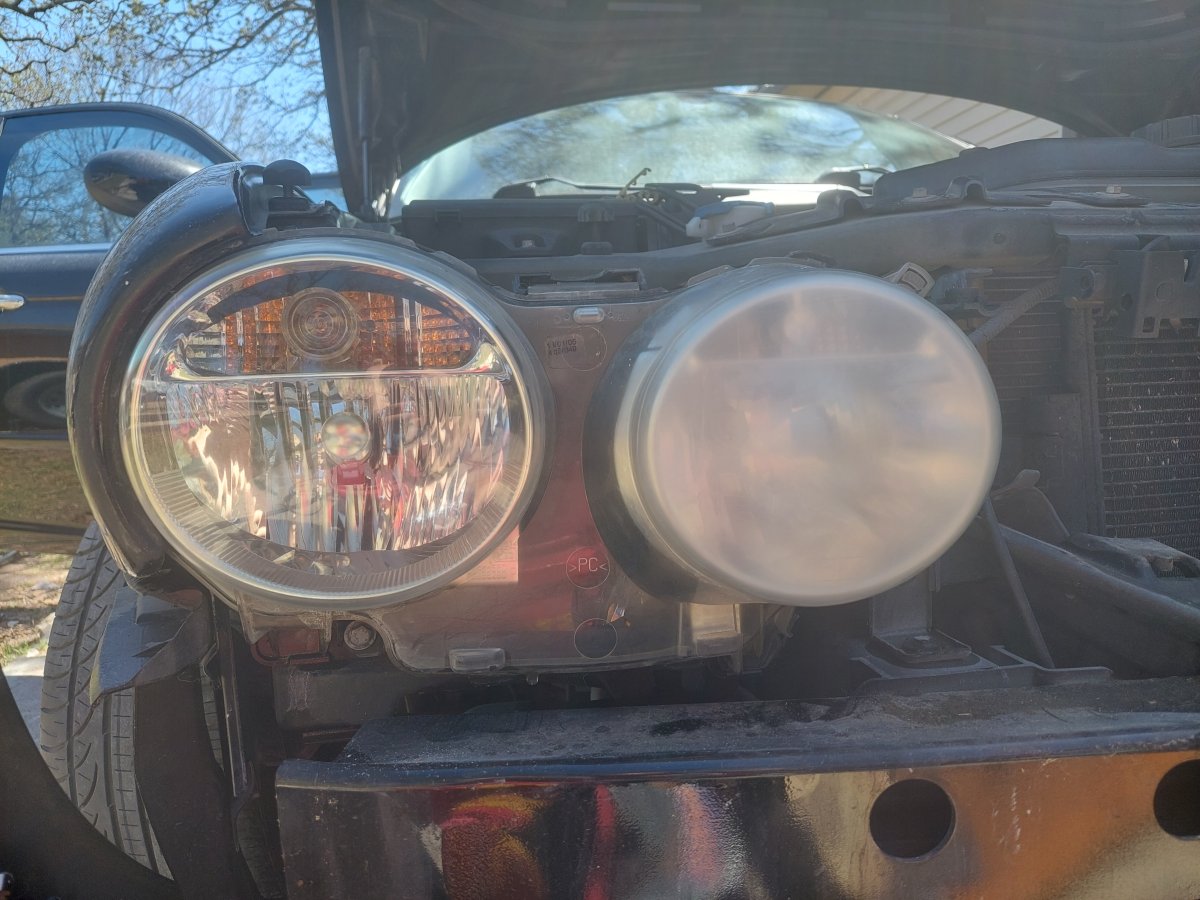

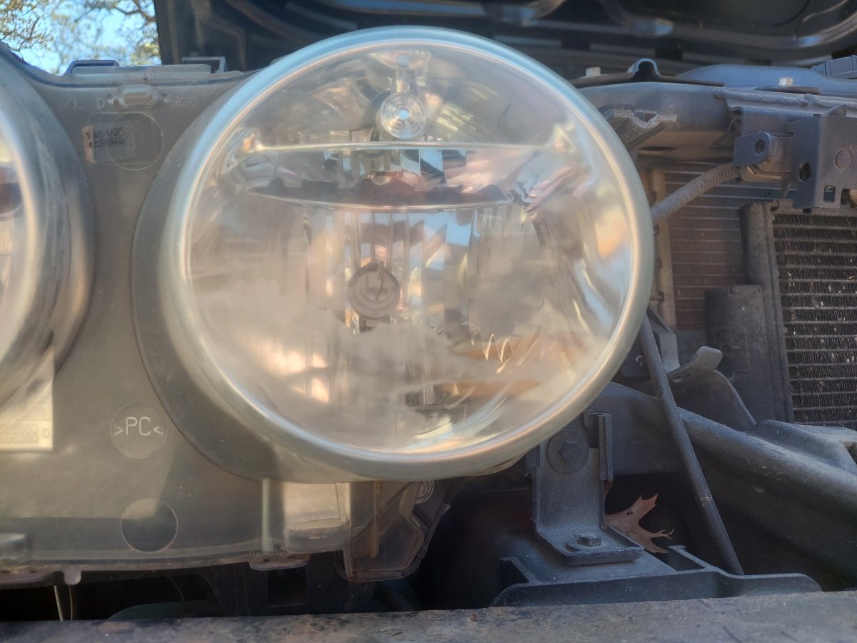

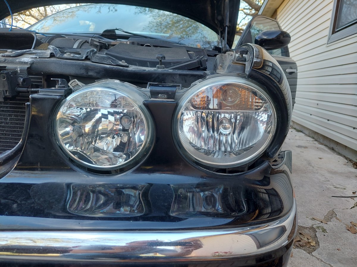

The Jags headlights were dull and hazy in spots so I wet sanded them with 800 /1200 /2000 grit paper and then buffed them out.

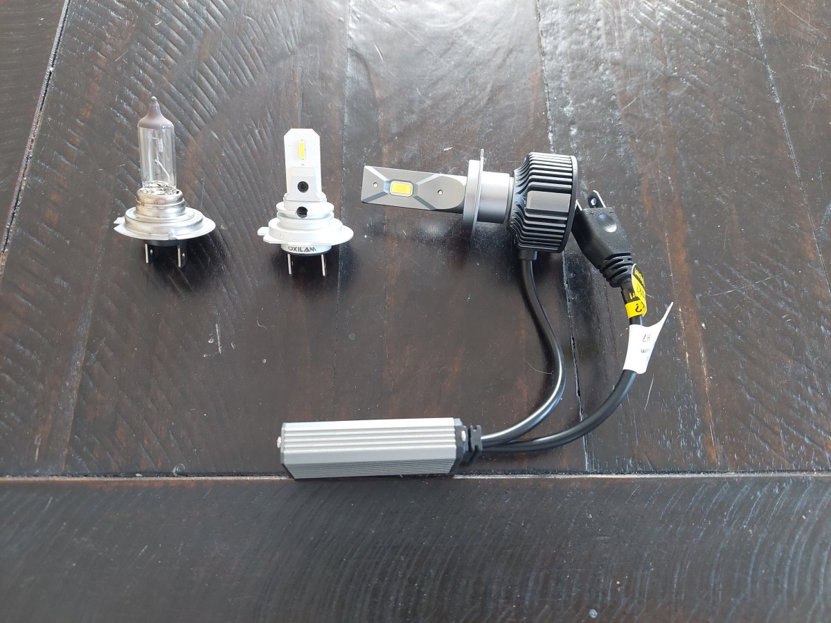

I upgraded the Jaguar headlights to LED. Left is a stock H7 bulb, then the H7 LED replacement, and finally a much brighter H7 LED for the highbeam.
The Jags headlights were dull and hazy in spots so I wet sanded them with 800 /1200 /2000 grit paper and then buffed them out.​
Nice! Any specific compound or pads you used?
Mine aren't as hazy as yours were but they could use cleaning up, especially the RH side.

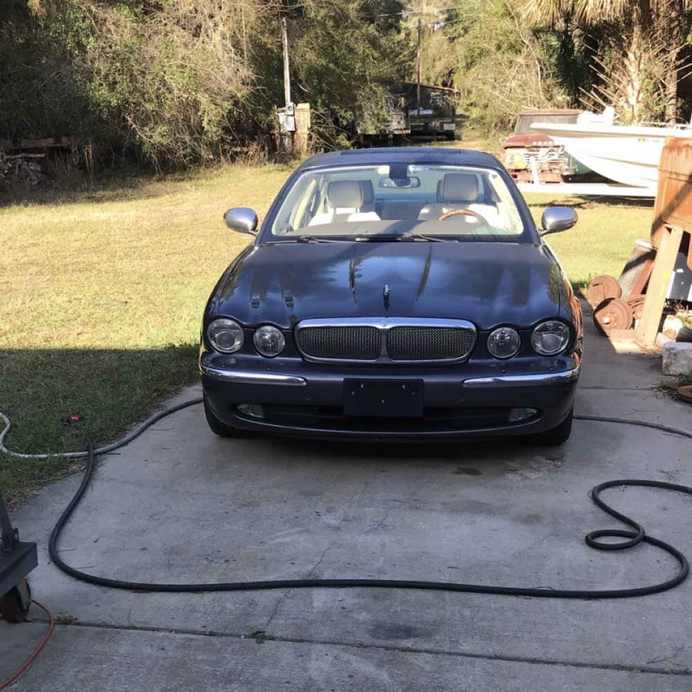

74766
(That's dew on the paint, not clear coat failure ;))
Are they tuned for the existing housings? I hope you dont end up blinding oncoming traffic. One of my pet peeves....

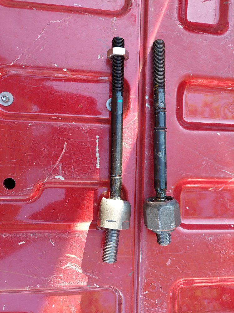

Went to replace the tie rod ends and realized the inners were worn out as well. Ordered a set of inners and as you can see, the threads that go in to the rack are to long. Right part number. Every site I find it on says it fits my car.
Found a TRW 1069 that also fits my car and has the shorter threads to match my old one. Guess I'll have to order those.
I stuck a screw driver in the end of the rack where the tie rod goes. It's deep enough. I guess it's just not threaded deep enough. :unsure:🤷‍♂️
Could cut them to length. Few minutes with hack saw, Sawzall, portaband, teeth, etc. Its much easier than stretching threads that are too short.
