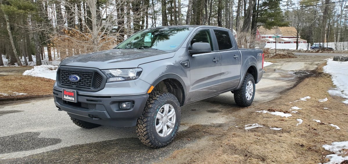

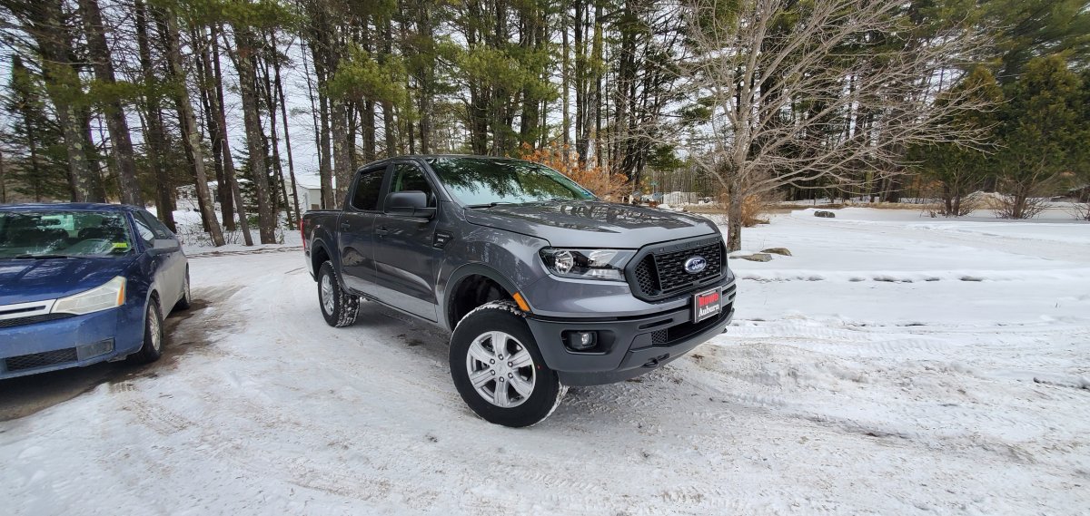

4x4, STX, e-locker, tow package. Paid 32k for it on presidents day of '21, price including a 2.5" rough country leveling kit and re-alignment.
My '21 STX
(Post leveling kit & 255/75/17s)
I had some 255/75/17 kenda klever mt's put on when the dealer installed my leveling kit. I liked the tire, especially for the price. NO good in snow however.
I drove the truck just like that for 26k miles or so happy as a clam before I did anything else..

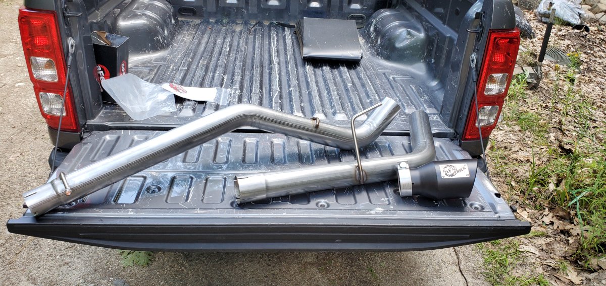

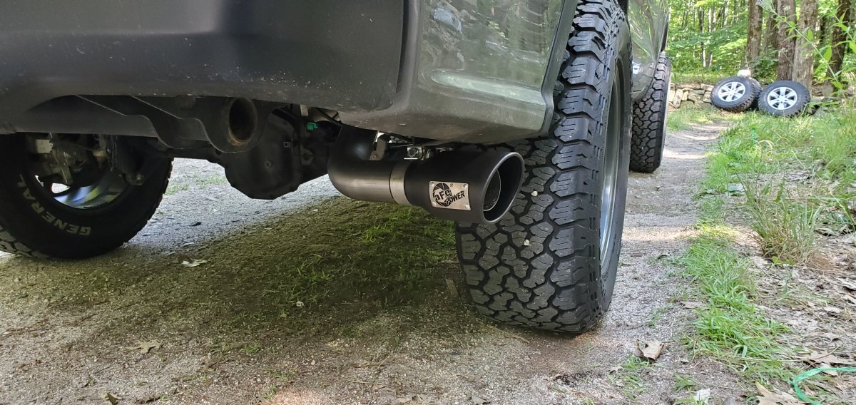

Then I installed an AFE muffler delete. I didn't want anything too loud.. this is perfect IMO. With the radio at a reasonable volume you really can't hear anything from the exhaust at cruising speed.

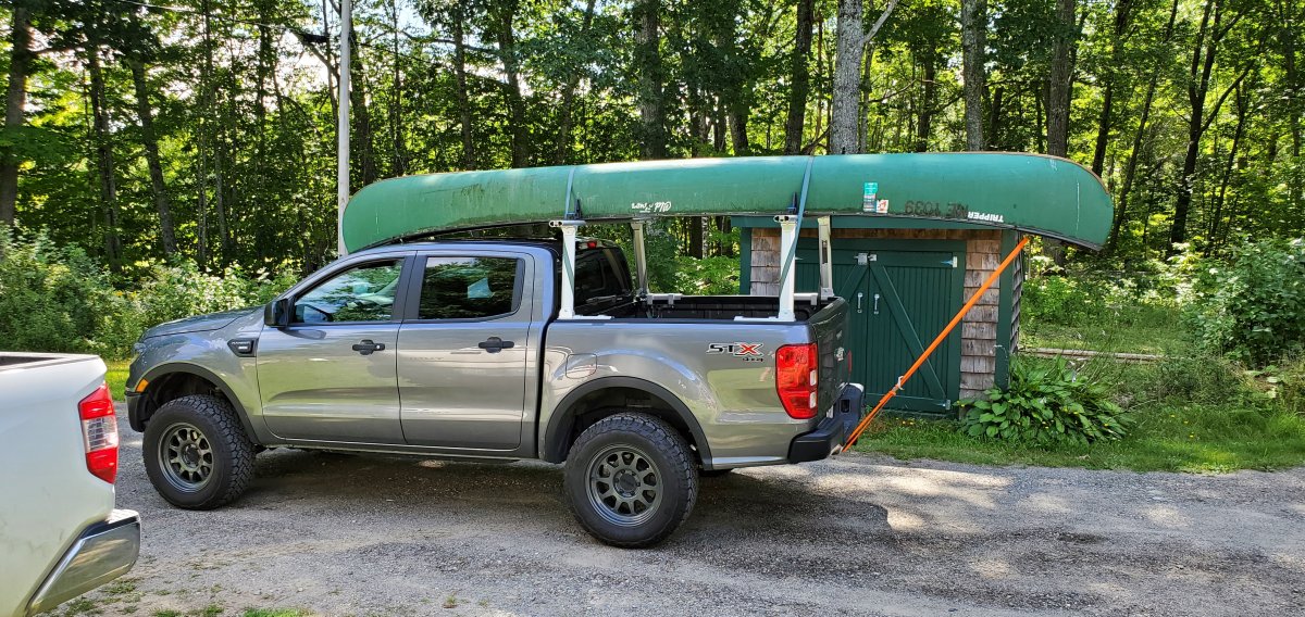

Finally I slapped on a set of hazard fart aluminum bed racks (cut the legs down 4") so I could haul around a canoe. I'll likely modify them so they can hold some fuel cans or a hi-lift at some point.

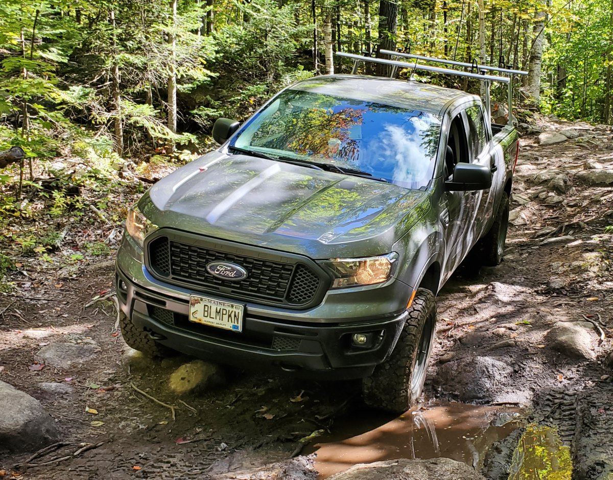

Took it wheeling over the weekend, suuuuuuuper good time.
