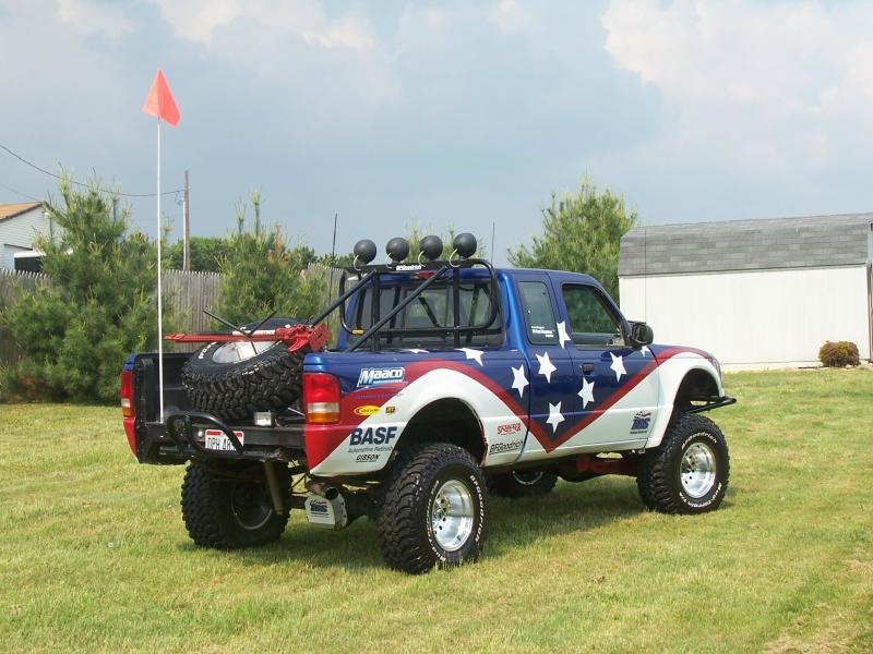

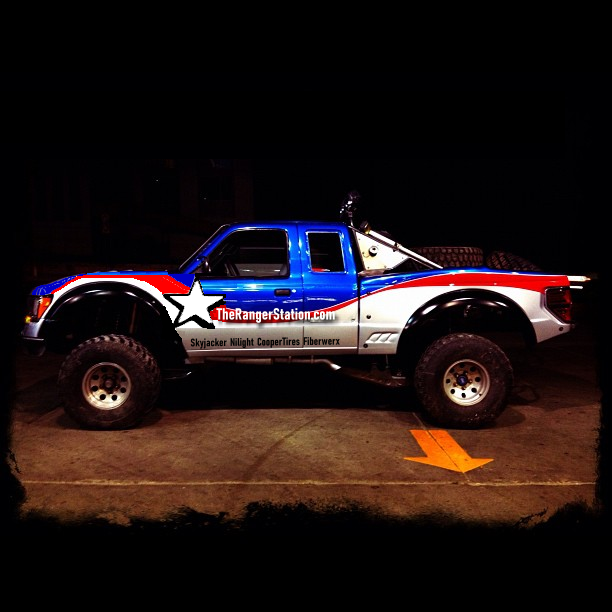

Playing around with a new paint scheme idea. My paint scheme has always been a play on the Ford Rough Riders paint scheme.
This time instead of all the stars, I'm thinking just one big star on each side, and making the red stripe curve, instead of coming to a point. But unlike how the Rough Riders pattern goes across the hood, I'll continue the blue with the red stripe all the way out to the headlight like the original TRS-2 paint job. :icon_idea:
