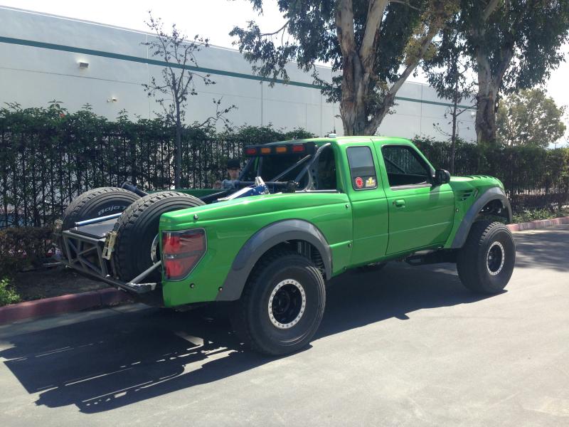

Can't really tell if these are 33's or 35's:
attachment.php
Here's another look at the bedside (below). Those are probably 35's.
