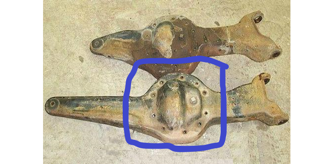

So my next thought is dealing with fab skills... Couldn't you just cut-out the D44 chunk from the TTB and weld it into the D35 TTB?
I guess its thinking outside the box but I'm sure I'm not the first.
Great read and info. But I though I read on the site somewhere that you could put the d44 carrier in the d35 housing. Is this correct or did I read that wrong?
You can do 44 knuckles (brakes/hubs) with a little work.
Negatory on swapping carriers.
If you're saying what I think you're saying. The "chunk" is bolted to the axle beam. I doubt that the D44 would fit and bolt into the D35 axle beam. By the time you're trying that and swapping knuckles and stuff, you might as well use the whole D44 assembly as-is.
Guessing I didn't elaborate that. I meant cutting out the D44 section for the chunk and welding it into the D35 axle?

I guess its all on ones perspective. Modifying parts on the frame vs. modifying the axle housing.

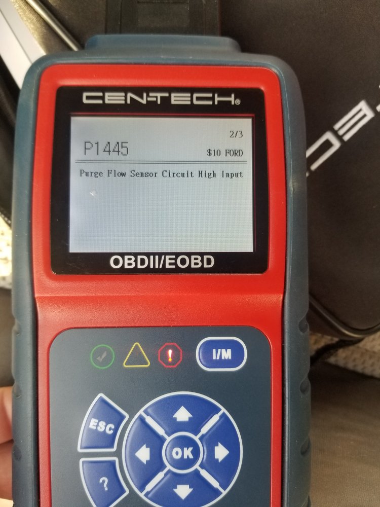

So in March I was getting a check engine light and P1445 error code.
Today I jump started the Ranger, it was dead from sitting for a long time, and I didn't get an engine light. I drove it and it seems to drive fine. I'm puzzled because I was going to try and figure out the P1445 code, and it disappeared. 🙅‍♂️
The battery could have been dead enough to clear the code. I would image that it will come back.
edit: did you have to reset your radio stations?
I did. Battery was definitely dead. I figured that was a code that was going to show up right away though.
It will come back.

Honestly, I wonder if I should even care if the code comes back if I can still drive it? I just want it to get me through another Round-Up.
