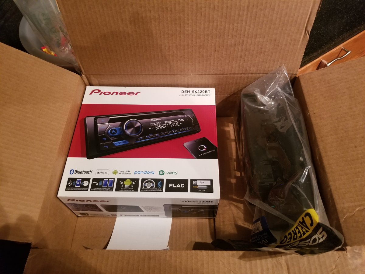

My kids got me a stereo for TRS-2 for my birthday.
Nice, Pioneer's good stuff, have a similar one in my '90 and it's still alive after not having a sealing rear window in most of a decade in the Northwest... that and a leaky windshield so the floor is always wet...
Nice! It'll be good to have bluetooth and updated tech in her.

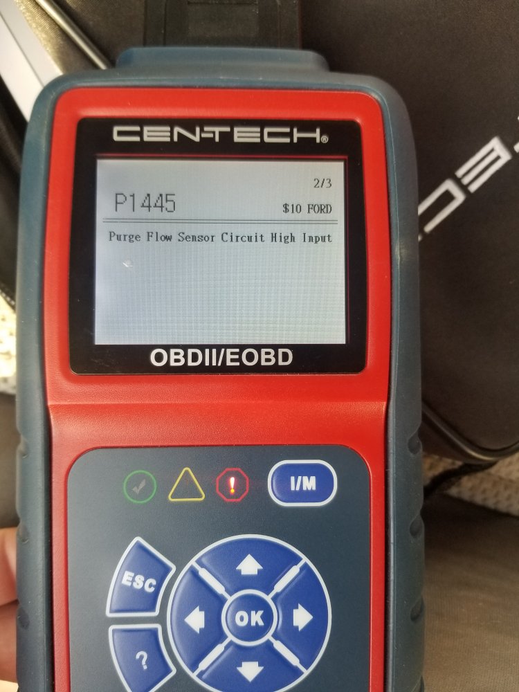

If you can't fix it with a hammer its probably an electrical problem. :icon_thumby:
I swear I replaced that solenoid last year.
