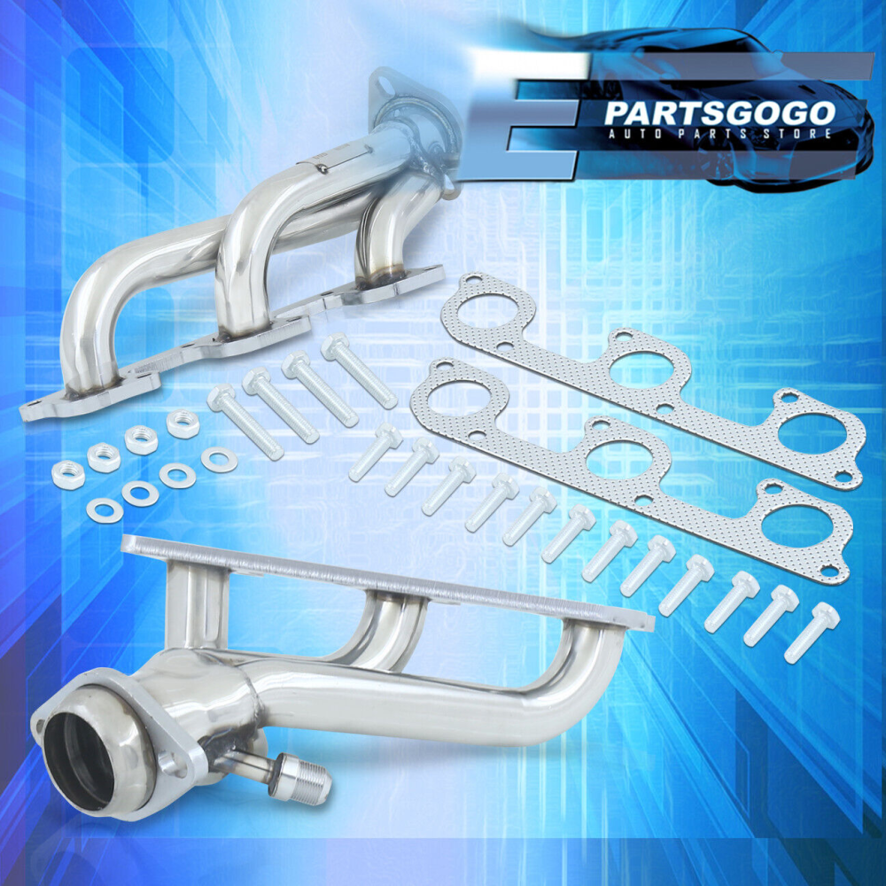

Thanks for the reply. I was thinking about trying to get lucky with eBay headers, but then again, my exhaust headers aren't broken... just thinking about it... Would you trust a listing like this or would something that cheap just be ineffective? 😂
You already have the best mid-rpm range headers
So I assume any change you want would be to lose that and get more scavenged power off the line, lower RPM range
You have a 4.0l SOHC so NEED the EGR hook up as well I forgot that, not optional
Check out Mustang forums, they had the 4.0l SOHC in 2005 thru 2010, lots of info on modifications in those forums, i.e. "better in hock than stock"
Thanks for the good info, I'm not so knowledgeable on exhaust parts, my main goal is to tune my car and I didn't know if I had to replace my current headers (or really any other exhaust components) to match the increased intake flow, but if I don't have to and the stock ones are good than that's fine for me.
My 01 is a 4'oh sohc, but I was happy w the ebay offerings, esp for the price. MSG, plz ck out the links n info in my thread.
